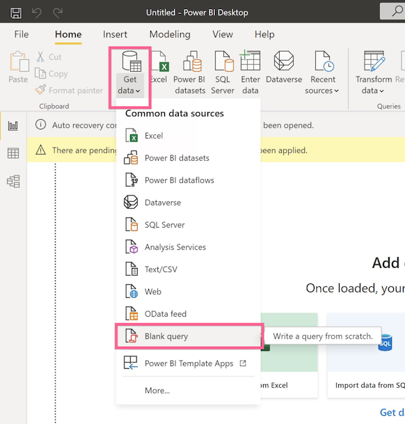

Create a new Power BI document and select Get Data from the Home toolbar. In the dropdown menu, select Blank Query to open the Power Query Editor.

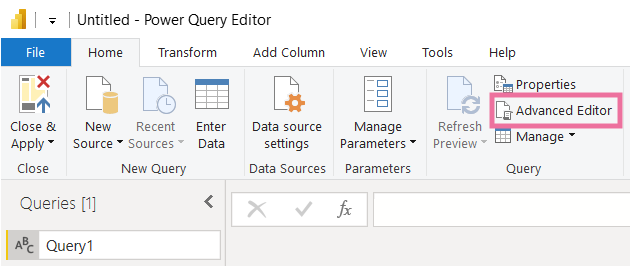

Once you have your parameters, select Query 1 from your sidebar, and then select Advanced Editor in the toolbar. Remove any existing query and paste the M Query into the editor. Press Done.
You should now see a list of records from your Airtable base’s table. From here you can transform and shape the data in your table. Once you've finished manipulating your data, select Close & Apply in the top left corner of the Query Editor. Now you can try making changes in Airtable and refreshing the query in Excel, you should see your updates reflected.

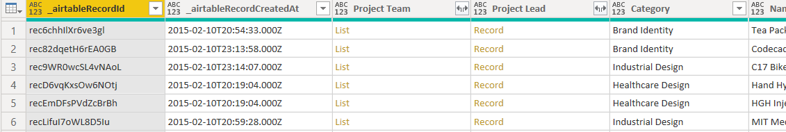

Certain field types in Airtable seem to return unexpected values, is there anything I can modify to change this?
Some field types including single selects, multiple selects, linked records, and collaborator fields will show “List” or “Record” instead of the values you may be used to seeing in the Airtable grid view. This is consistent with how the Airtable Web API returns information. Depending on your use case and needs, you may want to use Power BI’s “Expand to New Rows” or “Extract Values…” functionality that Power BI outlines in their support documentation.
