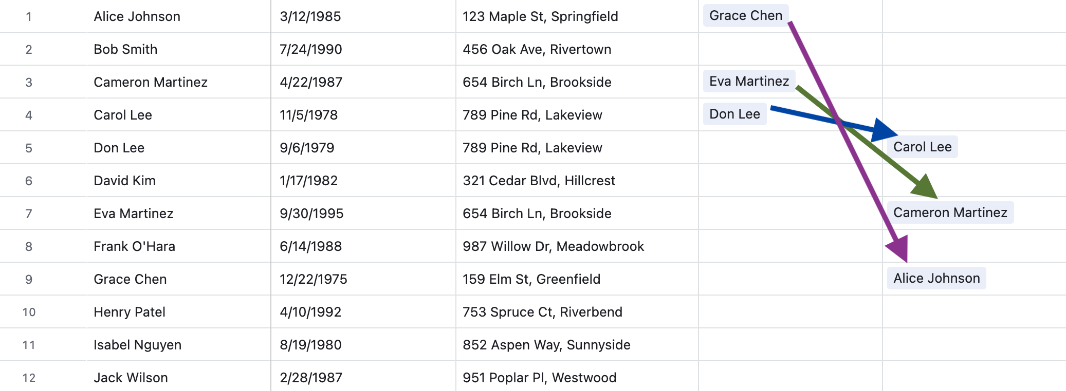

It is also possible to demonstrate a one-to-one relationship using a linked record field within the same table. Suppose you have a list of competitors in a figure skating competition. For each pair of individuals competing in a pairs skating event, their relationship is one-to-one, since each partner only has one other partner. If in this case, you made a linked record field where the table was linked to itself, then it would be possible to fill in a field of partners with record links across that same table. When self-linking, two fields will be created. One field is a “To” field and another is a “From” field. As linked relationships are added, they are mirrored in the other field. You can see those partner relationships in the image below represented by the arrows coming from the “To” linked record field to the “From” linked record field.

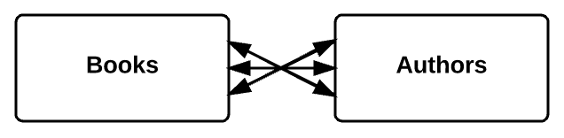

Lastly, entities can also have a many-to-many relationship. Let’s say you have a list of books, and a list of authors—each book may have one or more authors, and each author may have written multiple books. In this case, you have many books related to many authors. In Airtable, representing the relationship between these two lists of entities is as simple as making two tables and creating linked record fields.
In Airtable, representing a simple many-to-many relationship between two lists of entities is just as straightforward as representing a one-to-many relationship. With linked record fields, you can set it up so that every record in the books table is linked to one or more author records, and every record in the authors table is linked to one or more records in the books table.

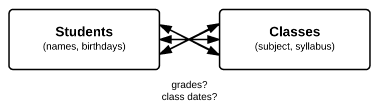

Example 1: Students and classes
If that sounds abstract, let’s look at a specific example: Suppose you have a list of students and a list of classes. There’s a many-to-many relationship between the students and their classes, since each student can take multiple classes, and each class can have multiple students enrolled. You could just make a table of students and a table of classes, link them together, and leave it at that. But what if you wanted to store information about each student’s grade in the class? Or which semester that student took the class? Do you put this information in the table of students, or in the table of classes?
The students' grades in their classes and the times which they took the classes can be considered attributes of the relationships between the students and the classes in which they enrolled. Since the relationships each have their own relevant lists of information, the best way to proceed is by making a junction table.

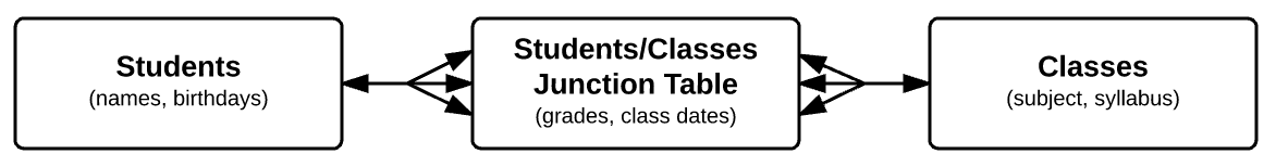

Let’s build this junction table step-by-step.
Say you already have a table of students and a table of classes.
We can make a new table which has a field linked to students and a field linked to classes. You could call the table "Grades," "Enrollment," "Students/Classes," or whatever helps you remember that this table is a junction table between the Students and Classes tables.
We still need to fill in the primary field for this junction table. One of the best ways to name records in a junction table is to use a formula, which takes data from other fields in the table to compose a unique name for each record. This can be particularly useful for a junction table, as often the records representing the relationships between concepts don’t lend themselves particularly well to a single unique primary field. Information relevant to each student’s relationship with a class (such as the grade, or the semester in which a class was taken) can also be put in this table. In this case, let’s say we use a formula to combine the Class, Semester, and Student name together. The output would look something like this
English 101 - Spring 2026 - Casey JonesIf you return to the Students or Classes tables, you’ll see that new fields linked to the junction table have been created automatically. You can create rollup or lookup fields on these tables to automatically pull information from the junction table into the Students or Classes tables.

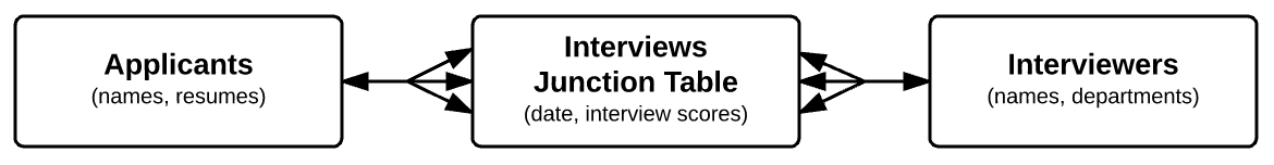

Example 2: Applicants and interviewers
Here’s another example of when you would want to use a junction table: You have a list of job applicants, and a list of interviewers. Each applicant goes through multiple interviews with different interviewers, and each interviewer hosts multiple interviews with different applicants. The interview can be thought of as the relationship between an applicant and an interviewer, and as such we would need a junction table to store information about each interview.
For this example there would be the following basic relationships:
Applicants - Linked to the Interview table with one or more interviews.
Interviews - Linked to a single applicant and one or more interviewers.
Interviewers - Linked to the Interview table with one or more interviews.
