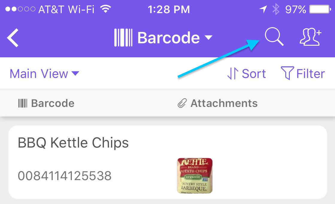

Searching by barcode
To search by barcode:
  1. Tap the search icon from within your base.
  2. Tap the barcode scanning icon.
    1. After scanning the barcode, the search function will open the associated record.
