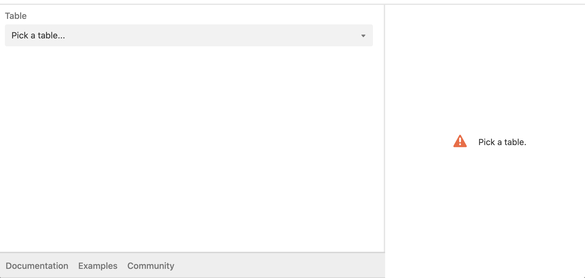

  1. When you first add the extension to your dashboard, you are prompted to pick a table for the chart.

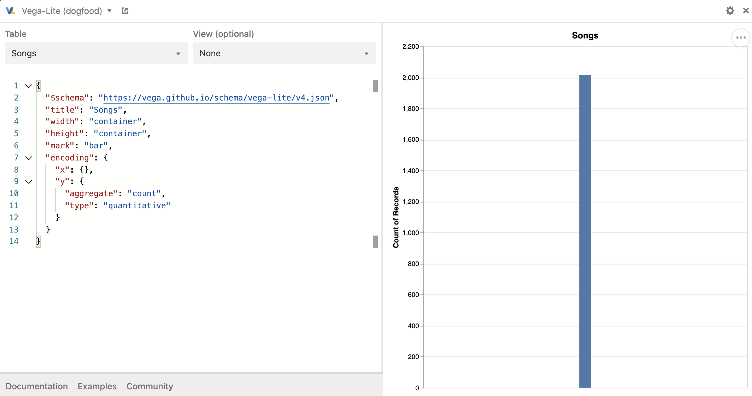

  3. The Vega-Lite chart extension is configured using JSON which appears in the left pane. When you select a table, the JSON for a bar chart is created automatically.
    1. Note that the JSON created by default does NOT have a data property. This is because selecting the table adds that data property behind the scenes for you.

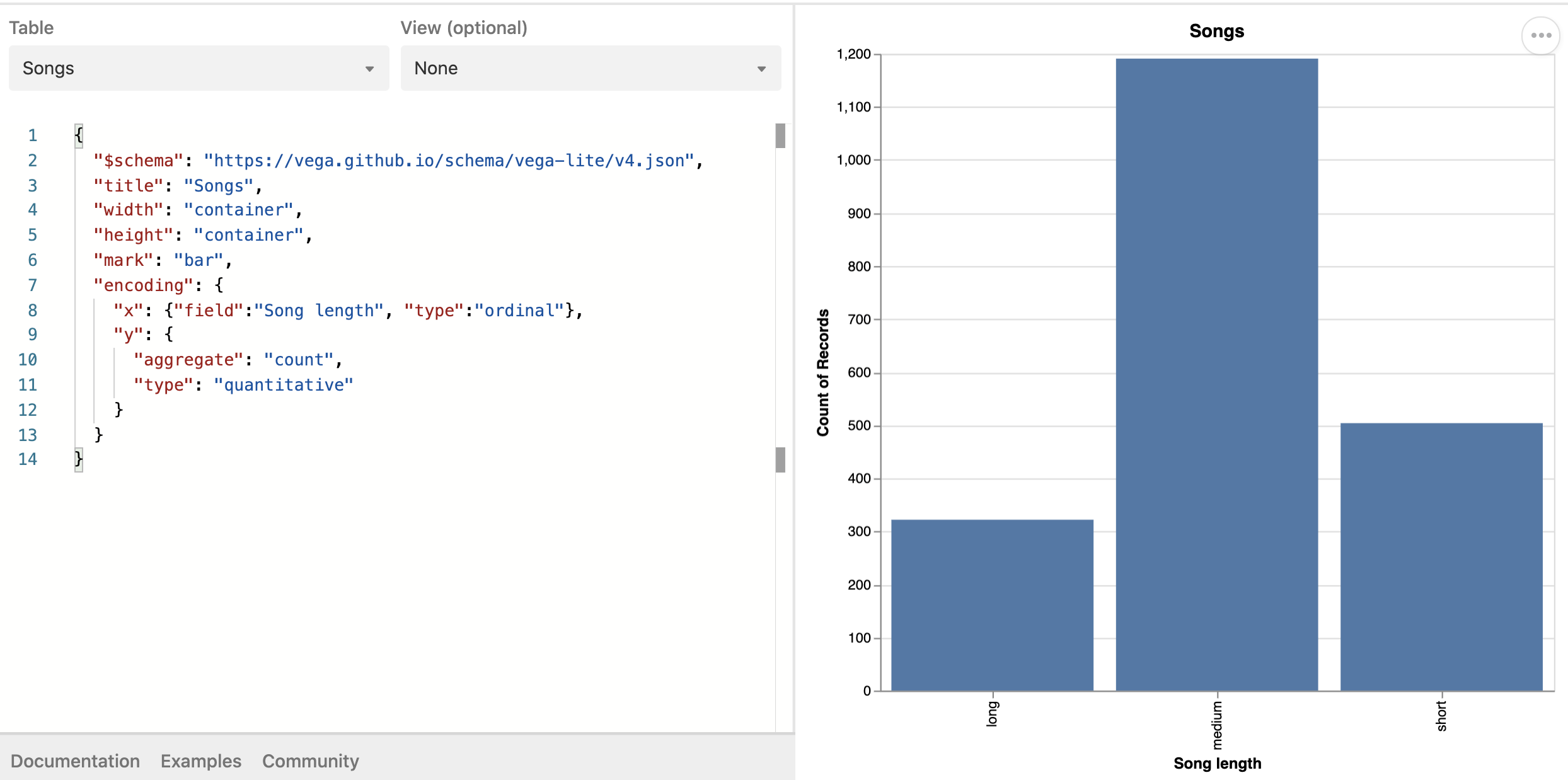

  4. For this example, we will set the x-axis to show the relative length of the songs (long medium, short) from a field that already exists in the table.
    1. In the "x" property, the field references the "Song length" field in the table, and the type is set to ordinal. For more information on the types for fields, see Vega-Lite's type documentation.
    2. You can type directly in the left pane to edit the JSON.
     "x": {"field":"Song length", "type":"ordinal"}

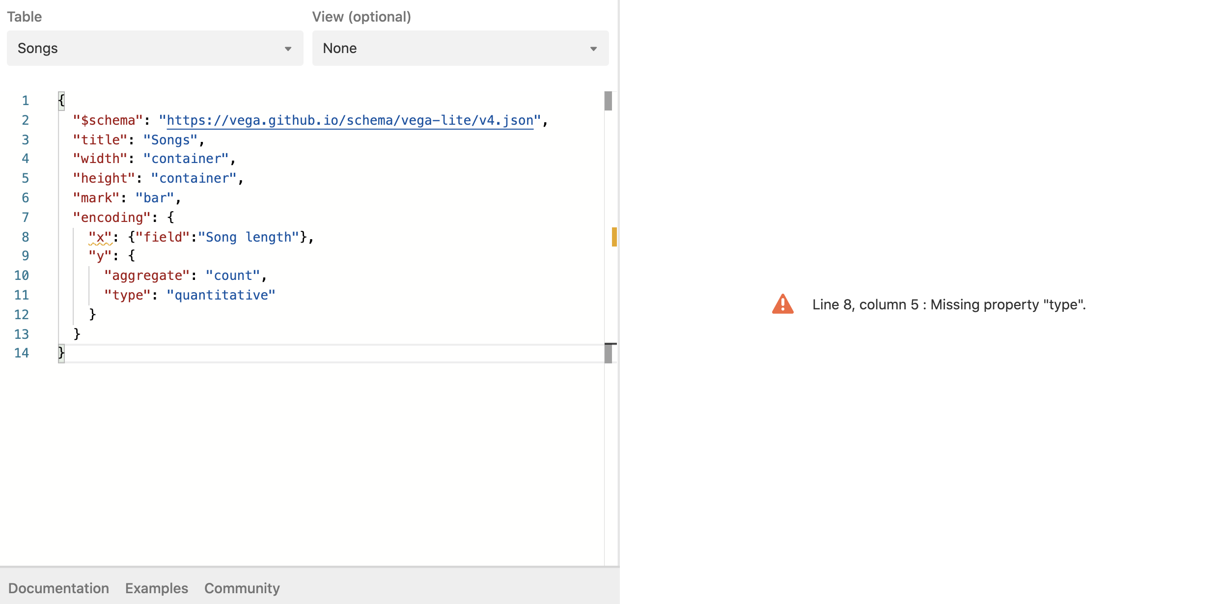

  5. As you type, the right pane will either show a chart or will provide simple error descriptions if the configuration is not well-formed. For example, when you add a field without specifying a type, you will see an error with the line, column (character position), and error message.

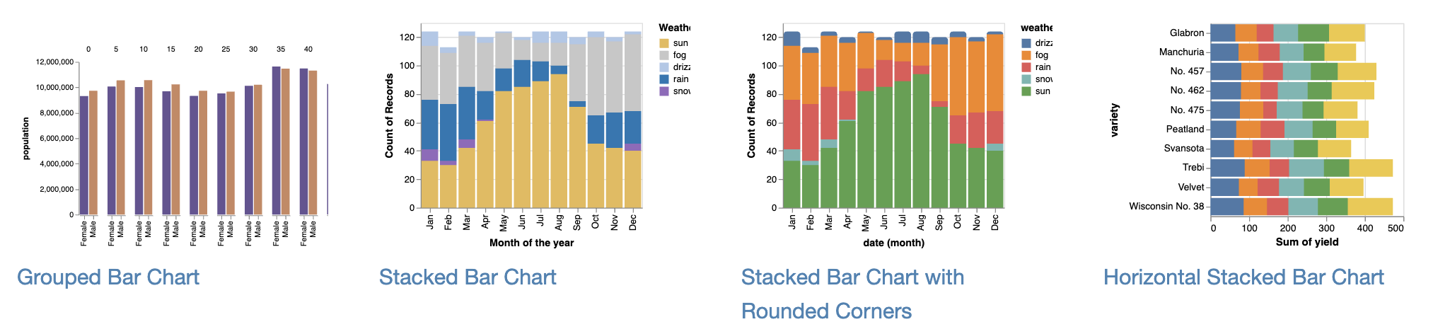

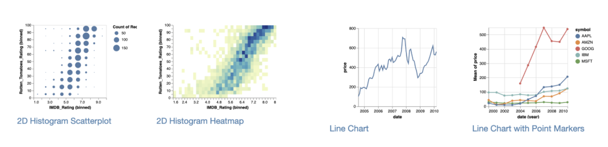

Vega-lite documentation and examples
The Vega-Lite website has extensive tutorials, documentation, and examples to support simple to advanced charts. The following is a lightweight reference to parts of that documentation that can get you started the most quickly.
  • A chart can have multiple views which in Vega-lite means a specification for a single mark type (bar chart, scatter plot, line chart, etc.). The multiple views are managed with view composition.
  • Each mark type can have additional properties. For example, the bar chart has an orient property to change the direction of the bars from vertical to horizontal.
  • You could change the height and width of the chart but for the chart to fill the space it is best to leave the height and width set to "container".
  • You can control the colors in the chart by using the color property.
