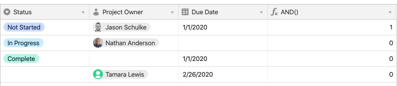

As an example of using the function on it's own, let's write a formula to check if the following fields have a value in them:
  •  Status
  •  Project Owner
  •  Due Date
Regardless of what function you're using, you can reference a field name to see if it has anything entered in it. For example, to check if a {Status} field has a value, you can just write: IF({Status}....
AND(
{Status},
{Project Owner},
{Due Date}
If all three fields have any value in them, the formula will return a 1, otherwise a 0.
Notice that only the first record has a value of 1 because all three fields referenced in the formula have something entered in the field.

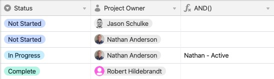

Using AND() with conditional statements
Taking the function a step further, let's see what it looks like to nest it within another statement. Using the same table structure, you have the following criteria:
  • Projects that are assigned to Nathan
  •  And projects that are in progress
  •  Should show the message, "Nathan - Active"
Using AND(), here is the formula you would write:
   AND(
     {Project Owner} =  "Nathan Anderson",
      Status = "In Progress"
   "Nathan - Active"

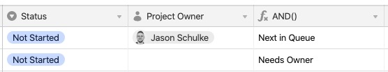

Let's change the criteria to look for the following:
  • For projects that are not started
  • And projects without a project owner
  • Show a message, "Needs Owner"
  • Otherwise, show "Next in Queue"
Here’s the formula:
IF (
 AND (
   {Status} = "Not Started" ,
    {Project Owner}
  "Next in Queue" ,
  "Needs Owner"

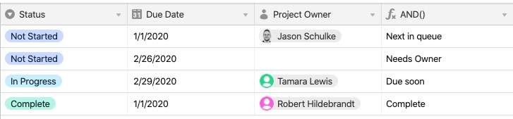

And here’s the result:

Here’s the formula:
   AND(
      {Status} = "Not Started",
      {Project Owner}
      "Next in Queue",
   AND(
      {Project Owner}=BLANK()
   "Needs Owner",
   AND(
      {Status} = "In Progress",
      {Due Date}
   "Due soon",
   "Complete"
And the result:

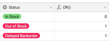

Remember that when used by itself, OR()produces either a 1or 0 depending if *any* of the criteria listed in the statement are true. For example, OR (5+5=10, 5+5=12) will evaluate as 1 because one of the statements is true.
As an example, you want to display a message depending on the quantity of available items you have in stock. Let's start with the function by itself:
OR(
   {Status} = "Out of Stock",
   {Status} = "Delayed Backorder"
1500000115541ANDOR006
Here’s the result:Using OR() with conditional statements

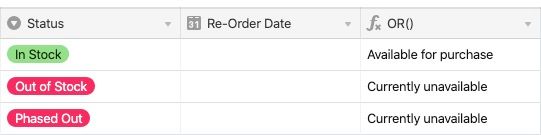

Building on the previous section, you may now want to display a message depending on if the result is a 1 or 0. You want to show "Available for purchase" if the item is in stock, or "Currently unavailable" if it is out of stock or on delayed backorder.
   OR(
      {Status} = "Phased Out"
   "Currently unavailable",
Here is the example result for that formula:

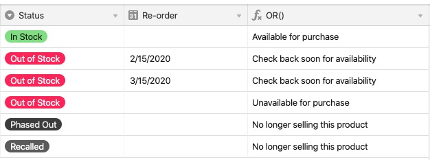

Combining AND() and OR() in Airtable
Here’s an example of combining AND() and OR() together.
   Status = "In Stock",
      "Available for purchase",
   AND(
      Status = "Out of Stock",
      {Re-order}
      "Check back soon for availability",
   OR(
      Status = "Phased Out",
      Status = "Recalled"
      "No longer selling this product",
      "Unavailable for purchase"
And here’s the result you can expect:
