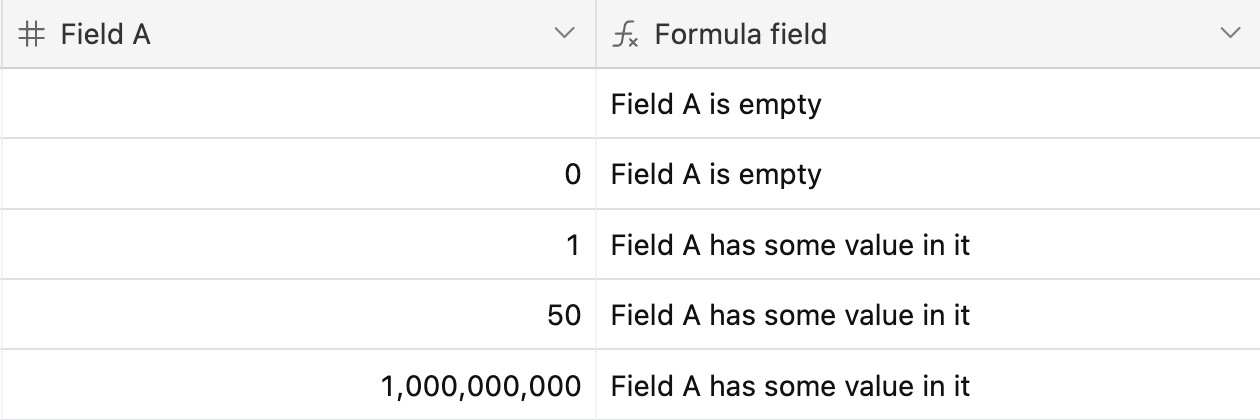

To check if a field is empty using BLANK(), use a formula structure like this:
IF({Field A} = BLANK(), "Field A is empty", "Field A has some value in it")
If there is any value in the field, it will be evaluated as true and, otherwise, false. However, there are a few caveats:

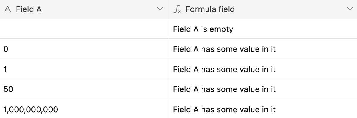

  • Number-based fields - The function will evaluate as false if the value you set in the field is zero. In other words, the cell can be empty or filled with a value of 0 to evaluate as false.
  • Other field types - The function will evaluate as true if the value you set in the field is zero. In other words, the cell must be empty to evaluate as false.

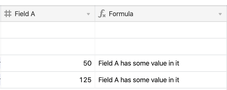

There are two ways to output a blank value in a field. Let's adjust the previously used formula only to output a message if Field A has a value.
IF({Field A} = BLANK(), BLANK(), "Field A has some value in it")
As an alternative to using BLANK(), re-write the previously used formula to use empty quotes ( "") instead.
IF(Condition, Value if True, "")
This will result in the exact same output as using BLANK().
