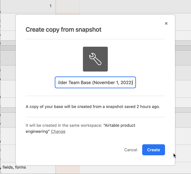

Restoring snapshots in Airtable
To restore a snapshot:
  1. Open your Airtable homepage.
  2. Open the base you want to restore.
  3. Click the base history icon in the upper-right corner.
  4. Select your preferred snapshot under “Take a snapshot.”
  5. Name your base snapshot and click Create.
