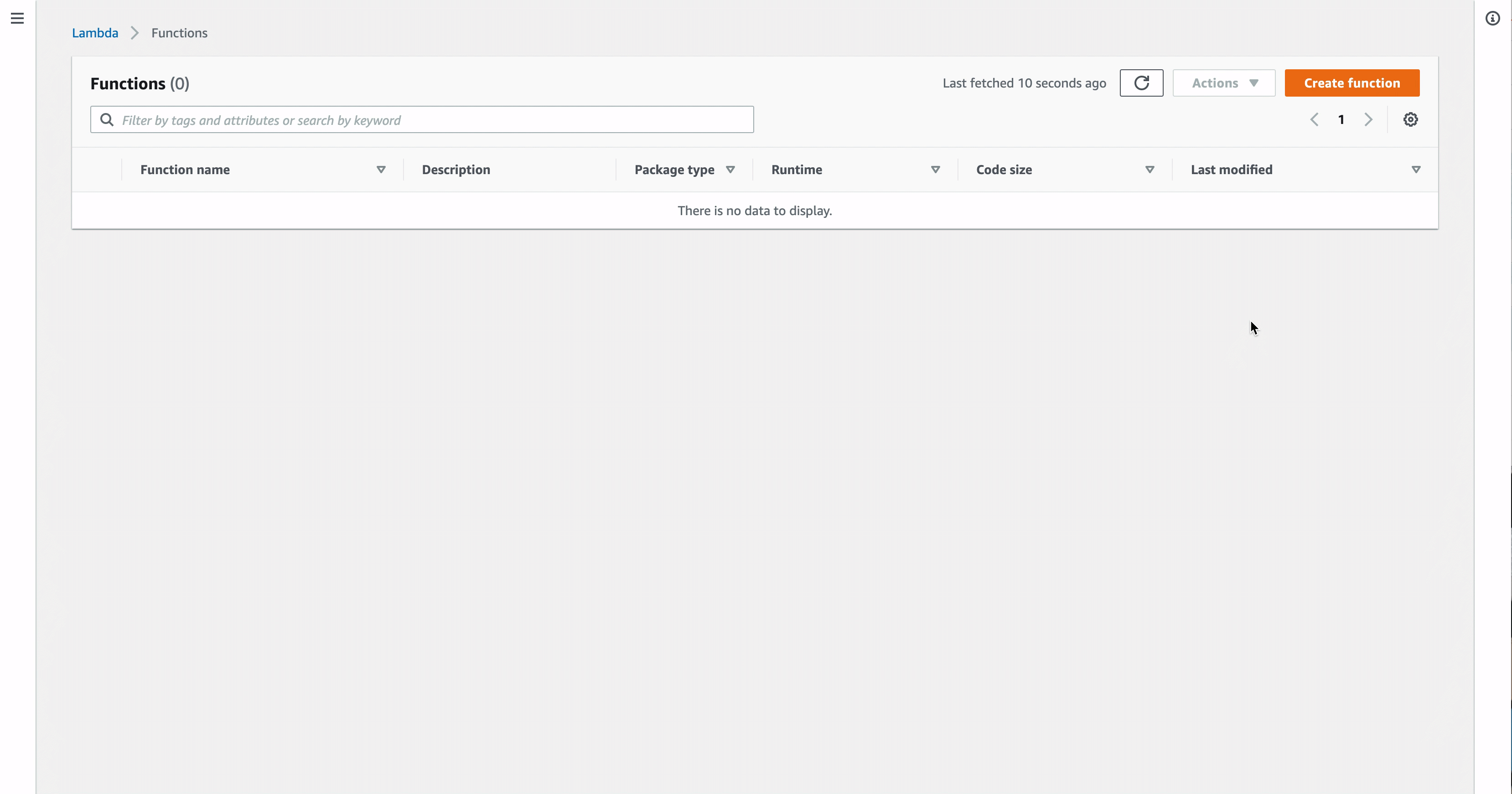

  1. Create a Lambda function
    1. Within your AWS account, navigate to Lambda
    2. Select Create Function
    3. Select Author from scratch, add your basic information, and select Create function. We'll revisit this later.

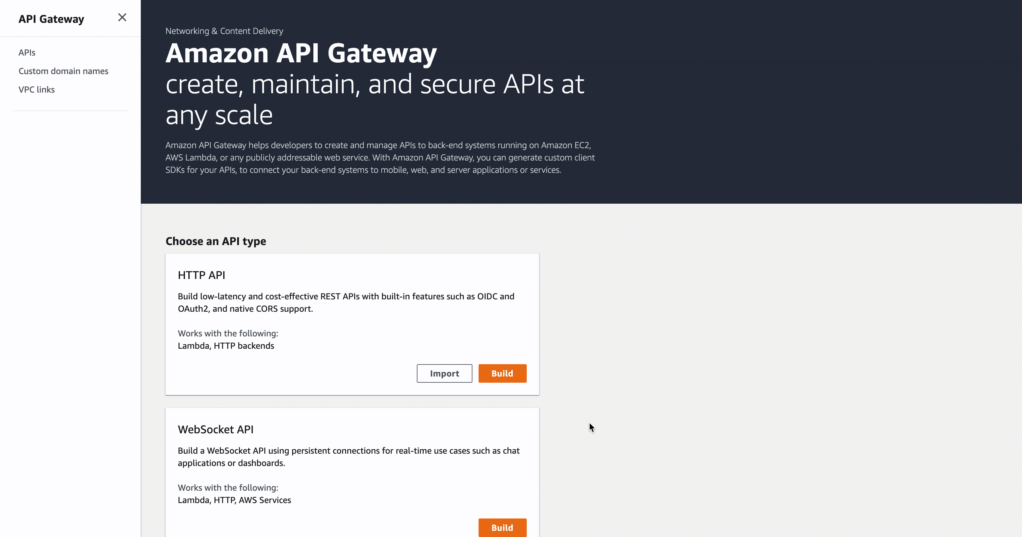

  2. Create a REST API via AWS API Gateway
    1. Within your AWS account, navigate to API Gateway
    2. Under "Choose an API type" find REST API and select Build
    3. Select New API and give your API a name

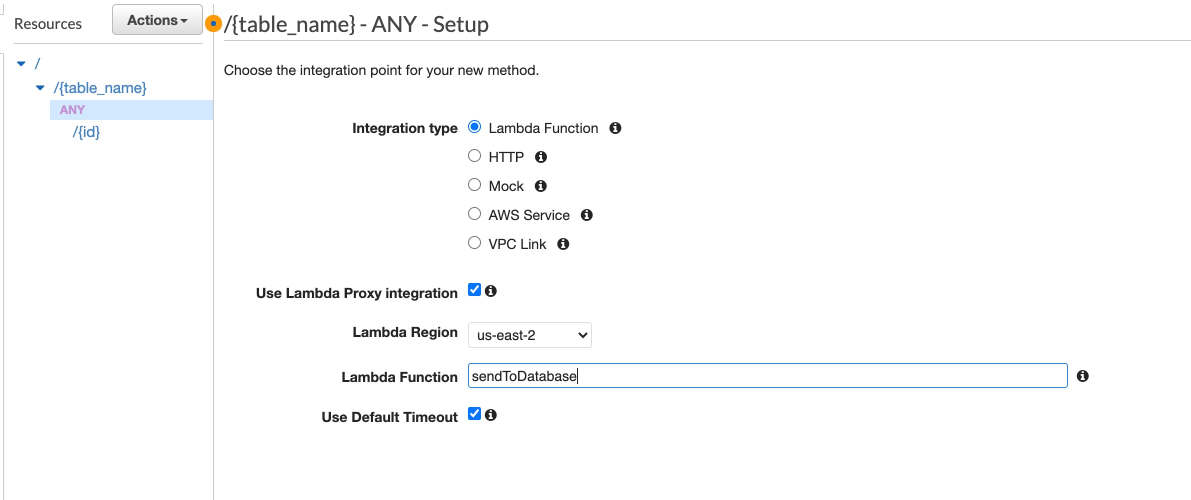

  4. Create Methods - Now that we've added our resources, we can create methods under each resource. Our Lambda code will handle most of the routing logic based on HTTP method. For each resource complete the following steps.
    1. Select the resource name in the “Resources” sidebar
    2. In the "Actions" menu select Create Method
    3. Select ANY and click the checkmark to confirm
    4. Select Lambda Function as your integration type
    5. Select Use Lambda Proxy Integration
    6. Name your Lambda Function
    7. Select Save

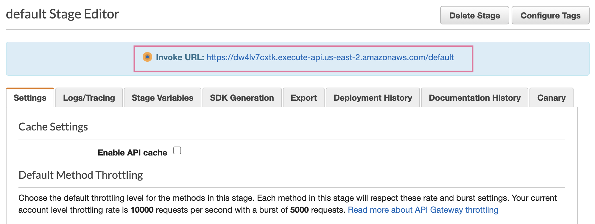

      2. Keep a record of the Invoke URL as that’s what we actually use to make API requests
    3. After you've deployed your API, you'll be taken to the Stage Editor where you can find your Invoke URL. This will be our endpoint for our API calls. Test your API by making a request via cURL or Postman.

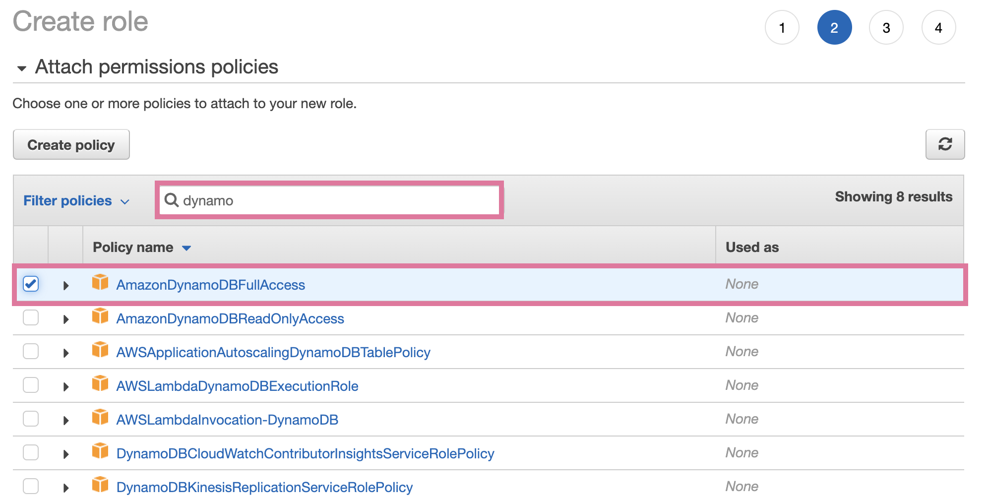

Step 4: Add Lambda to an Identity Access and Management (IAM) Role
Before the Lambda Function can write data to your Dynamo DB, it will need permission. This can be done in the Identity Access and Management Service (IAM) by assigning the Lambda to a role that has the ability to issue CRUD operations to your Dynamo DB instance.

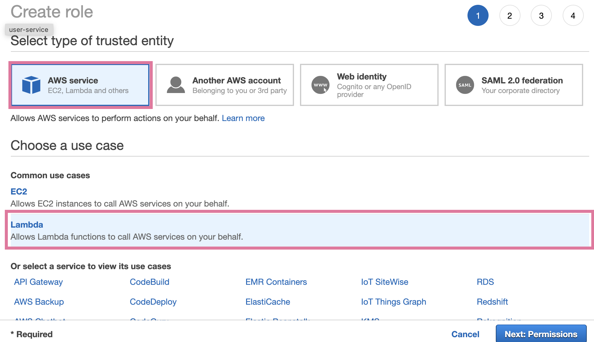

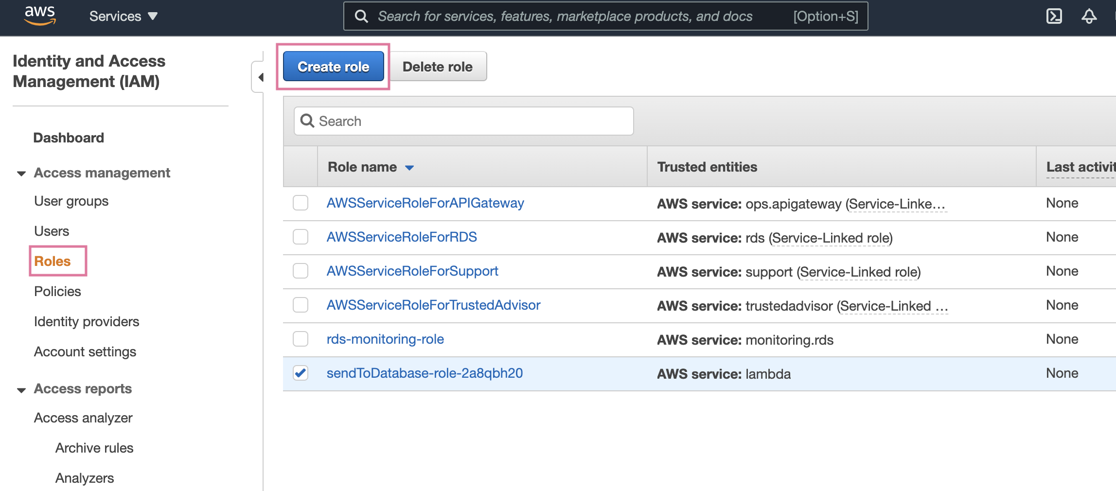

  1. Within your AWS account, navigate to Identity Access and Management (IAM)
  2. In the sidebar, select Roles and select the Create New Roles button
  3. Select AWS service and Lambda
  4. Search for AmazonDynamoDBFullAccess and select the policy.
  5. Walk through the rest of the creation process and apply additional data as necessary.

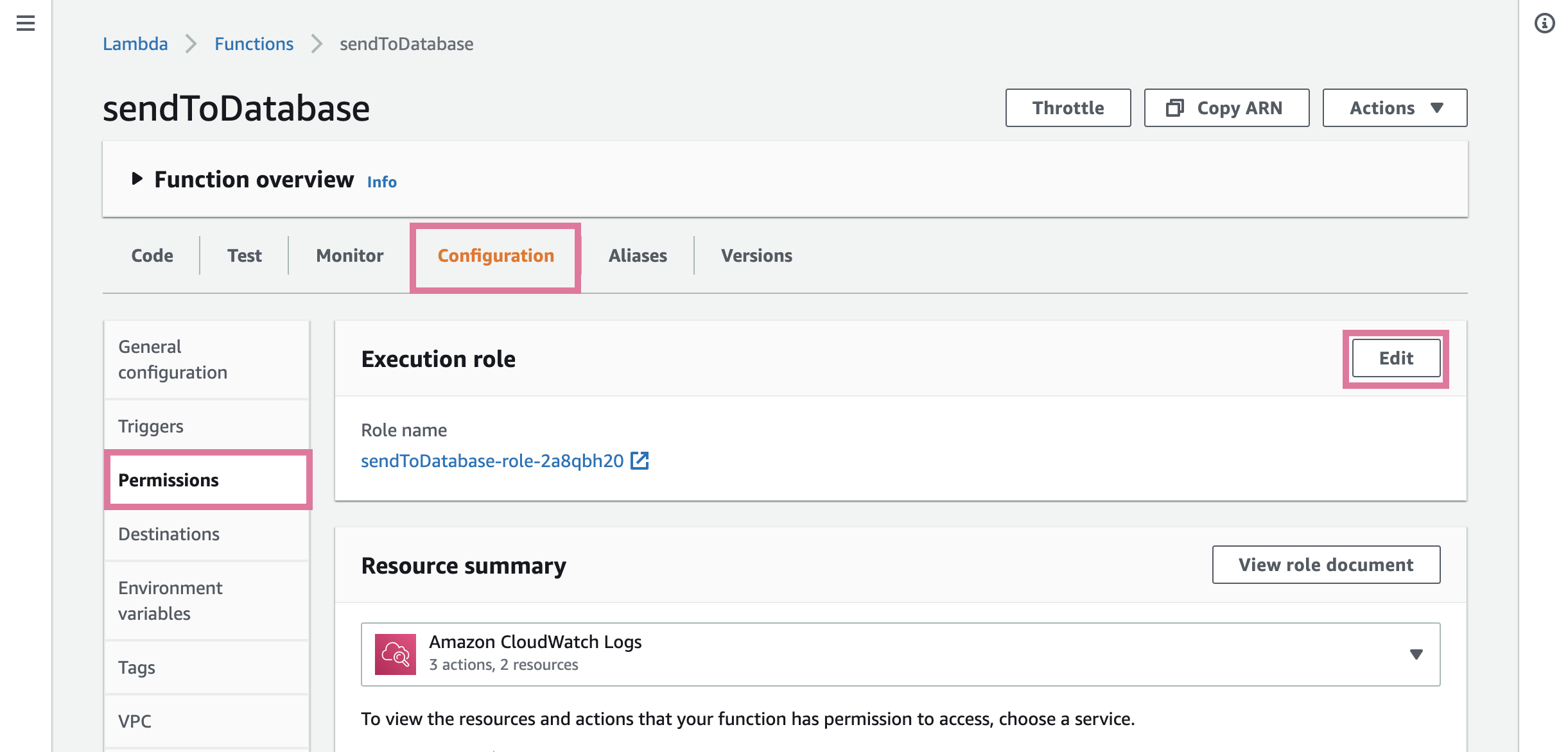

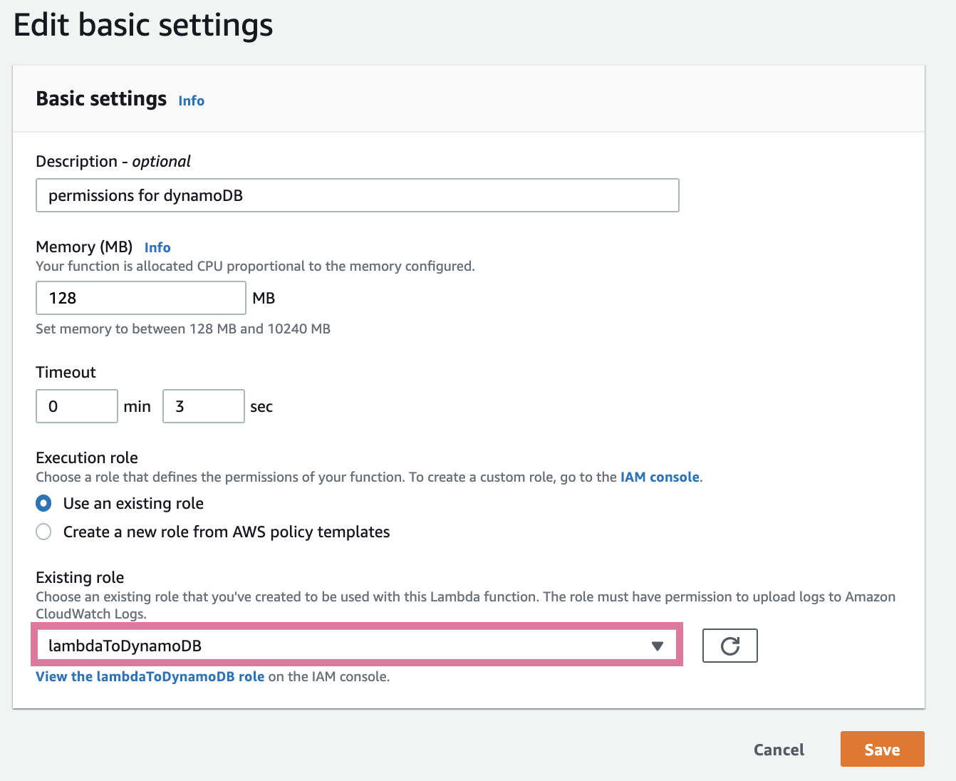

  6. Go back to the Lambda Function you created and select Permissions. Next to Execution role click Edit.
  7. In the settings panel, select the policy you just created, and click Save.

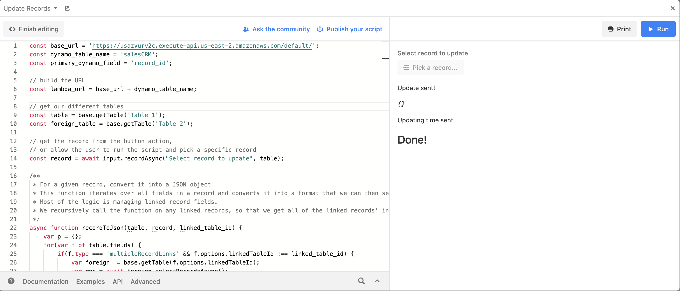

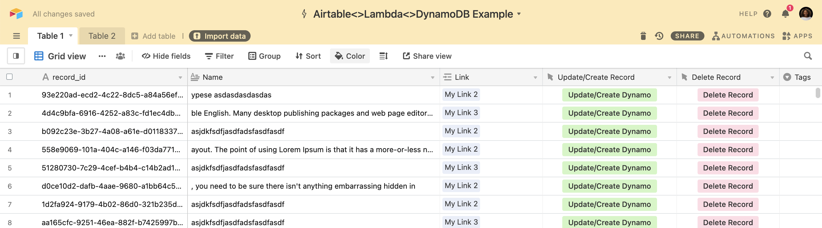

Step 6: Add a scripting extension to your Airtable base
Airtable’s scripting extension allows you to write JavaScript or TypeScript code and deploy it from your base. This enables you to further optimize your workflows by including custom logic in your base. The scripting extension supports the ability to make web-requests to other services via a fetch request. Allowing us to make API calls out to our new AWS API Gateway and Lambda application, which will create and delete data within our DynamoDB database.
9a6cb998-aa13-4fbe-bf67-4c73629a4a43-4403568805399ScreenShot2021-07-01at72138PM.png-d3ecf7ad-30cc-4ba8-bda3-5273e222784b
Airtable also supports a button field, which can be configured to take a number of different actions after the user clicks on it. One of those actions is the ability to pass a record’s details to a scripting extension and then execute the script with those details.
For our example use case, we want users to consciously make the decision to push updates into DynamoDB via a button in the Airtable base. In our example, Airtable users plan, draft and collaborate on content in a base. Once it’s ready to publish into our DyanmoDB instance, the user can push a button to send that record into DynamoDB. If the user needs to pull the information from DynamoDB because it’s no longer relevant, users can trigger a deletion by pushing another button in the base.
To configure this workflow you’ll first need to create your scripts and then create the button fields which can be used to trigger those scripts.
  1. Create a new scripting extension in your base to Update or Create in DynamoDB. You can copy the following code and paste it in the code editor of the scripting extension you are creating:

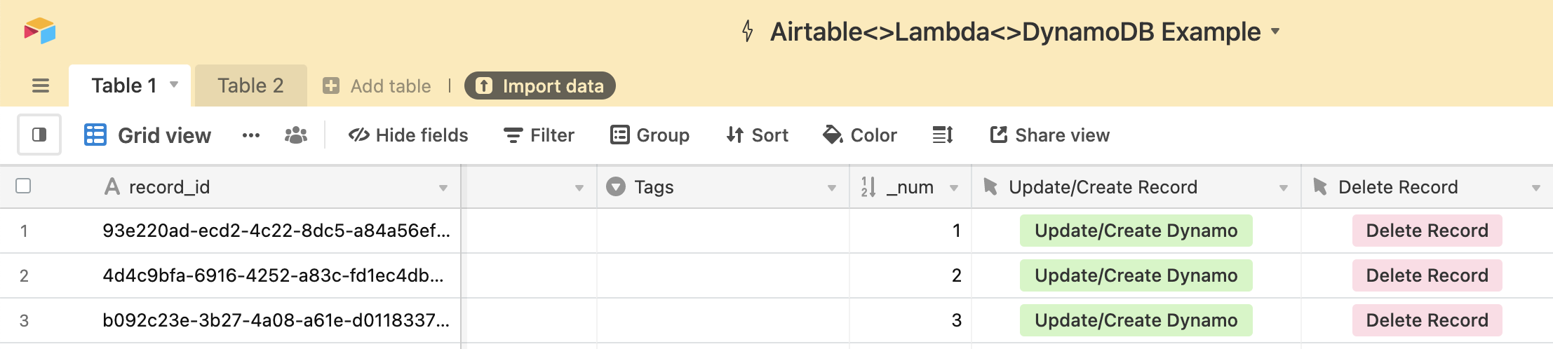

  3. Lastly, create the button fields to trigger the scripts to run. Create two button fields:
    1. Create/Update Record
    2. Delete Record
    3. When creating each button field:
      1. Action : Run Script
      2. Dashboard : the dashboard you installed the scripting extension in
      3. Extension : the corresponding update/delete script
You should now be able to trigger these scripts by clicking on the buttons and see the corresponding action take place in your AWS DynamoDB instance.
