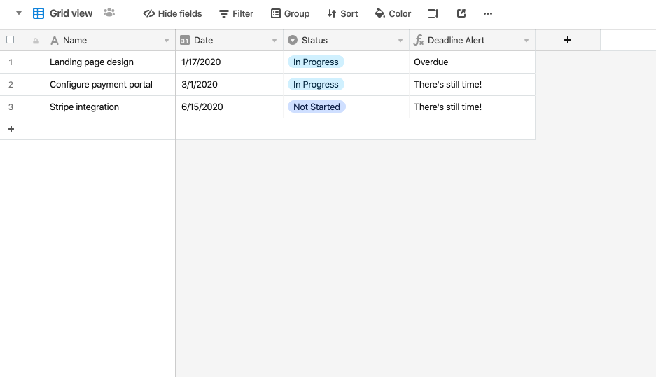

For fields with only a single word or character (e.g. no spaces in the field name), you don't have to add curly brackets around the field name. See the animation below showing a reference to the date field without brackets.
IF(NOW() > Date, "Overdue", " There's still time!")

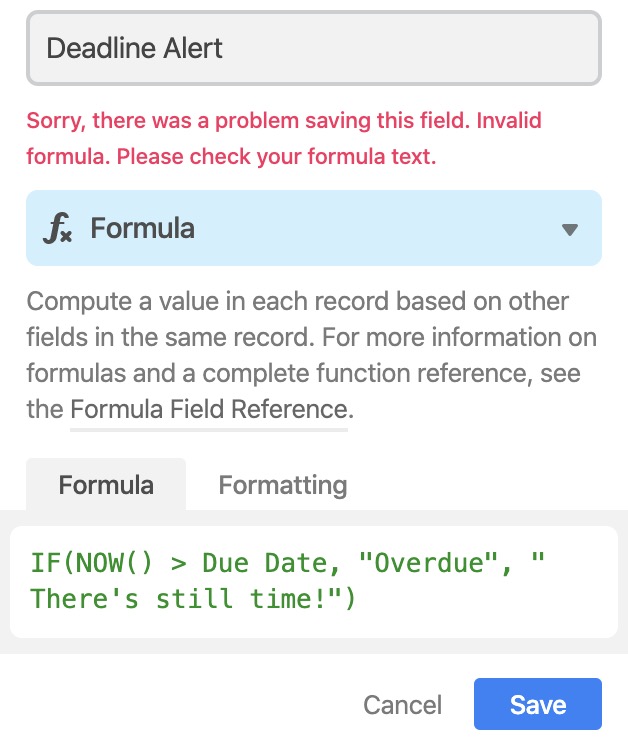

If you have an existing formula (like the one used above), and then change a field name, Airtable will automatically update your formula to reflect the new field name. In the example below, after changing the Date field to be named Due Date, the formula field both updates the name and adds curly brackets around {Due Date}.
IF(NOW() > {Due Date}, "Overdue", " There's still time!")
For this new field name, curly brackets are required for use in any formula because it has a space in the name. If you try to reference a field name without using curly brackets, you'll see this error appear in your formula field.

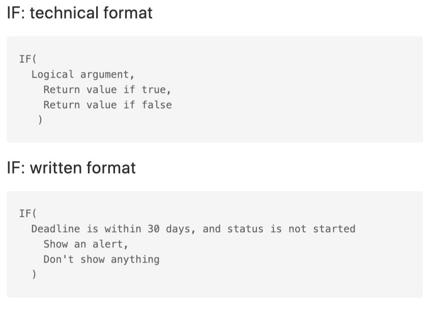

Whether you're just starting out with Airtable formulas, or you're writing out a 60 line nested IF statement, being able to understand the logic and flow of formulas can be challenging! A helpful practice to keep yourself in check when building a formula is to first write out what you want to accomplish in plain language.
Using an IF statement as an example, you may want to accomplish the following: "If the deadline is within 30 days from now, and the status is not started, then show an alert, otherwise show nothing." Write this out, and then split out the various aspects of that sentence into it's related formula components.

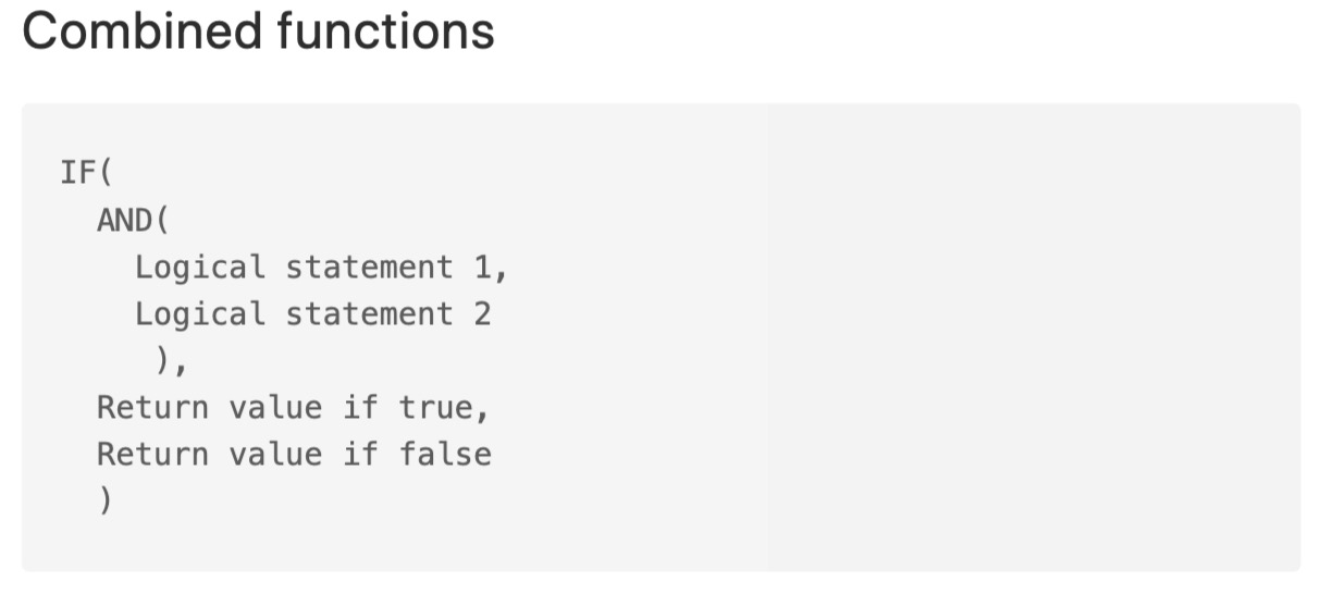

The entire formula needs to be structured using an IF() function, even though it will have other functions within it. You'll first need to know the technical format (see our formula field reference), and then you can:

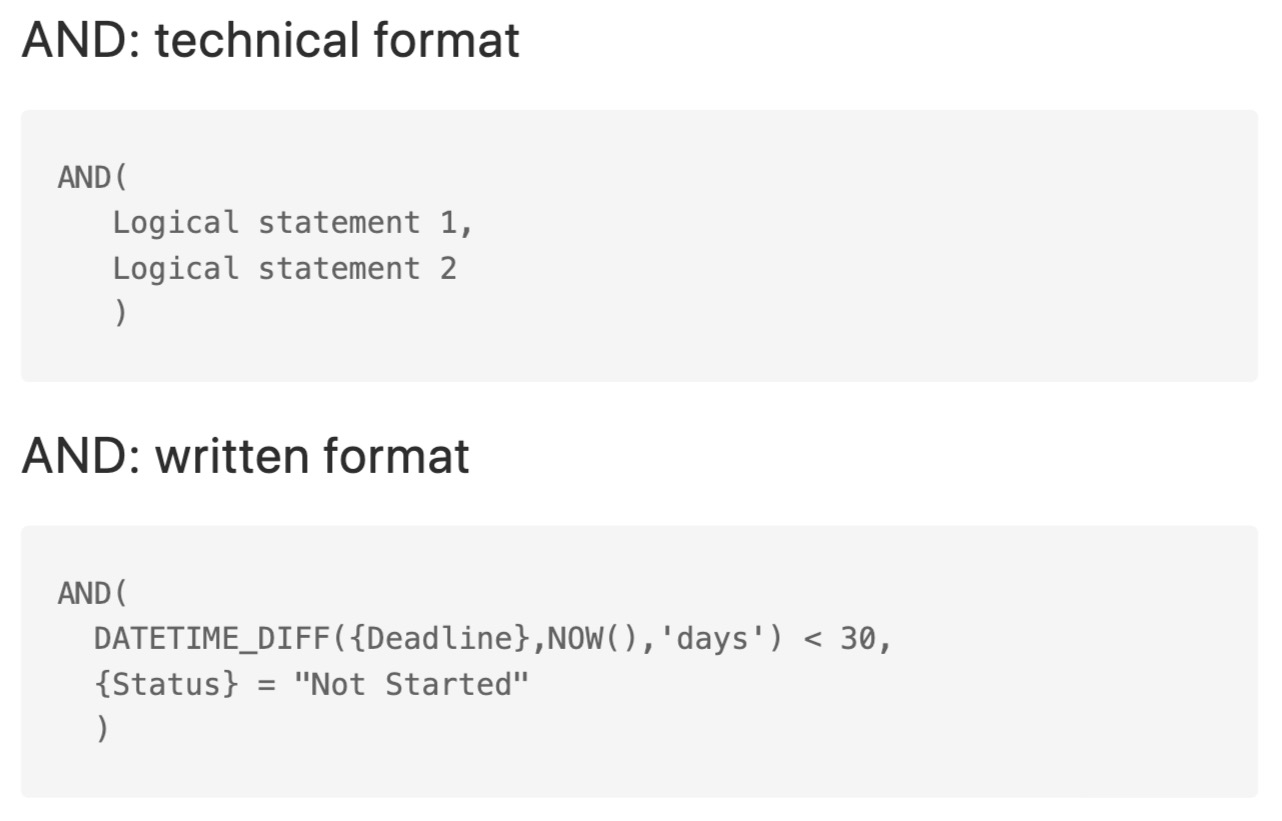

The second component needs the AND() function; the alert should only be if the deadline is within 30 days from now AND the status is not started.

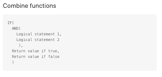

Now that both components are written, combine the technical formats together.
Lastly, now that all of the placeholder functions are there, substitute them with the actual formulas written before.

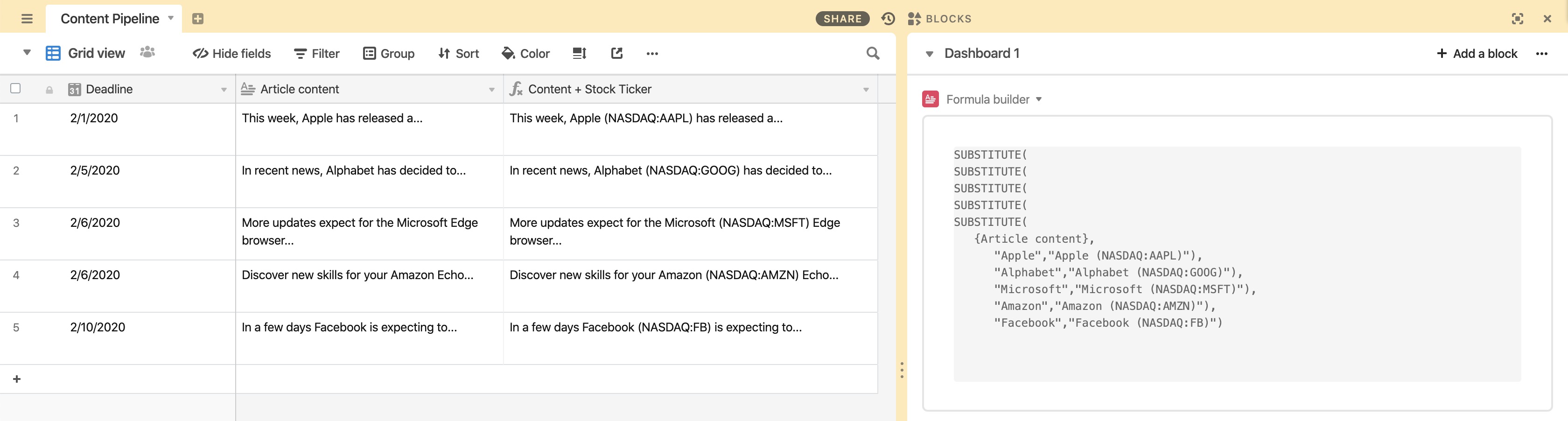

Building formulas alongside your base
When you're building longer and more complex formulas, it's often helpful to see your formula alongside of your base as you build out the different components. To help with this, you can use a Description extension, or even a free text editor program in a separate window next to your base.
Using the same formula above as an example, you can see how the process of writing the formula alongside of your base can be helpful as you reference field names and add in nested arguments.
Using a larger text editor like this can be helpful as you can add line breaks and tabs to your formula (which cannot be input at this time directly within a formula field).
