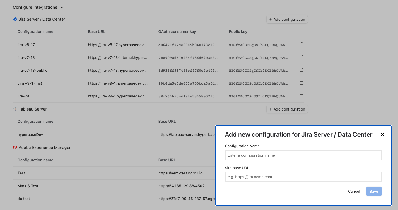

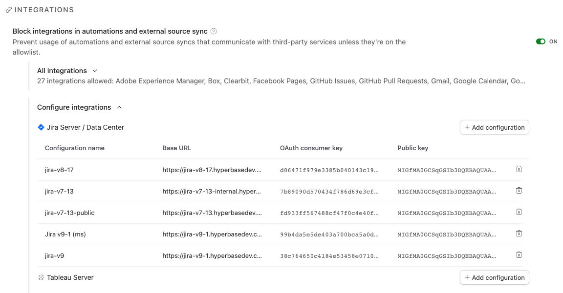

To create a Jira Server configuration and generate the “Consumer and Public key” for Jira Application Link:
  1. Visit your admin panel.
  2. Click Settings, then Integrations & development.
  3. Click the arrow next to Configure integrations.
  4. Click Add configuration.
  5. This will open up a form where you can fill in the configuration name and URL of your Jira server.
  6. Enter the requested information and click Save.

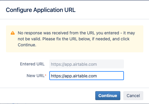

  3. In the “Enter the URL of the application you want to link” field, enter https://app.airtable.com, and then click “Create new link.” You may be prompted with one of the following messages. You can ignore these messages and click Continueto leave the new URL as is.
    • No response was received from the URL you entered.
    • The supplied Application URL has redirected once. Please check the redirected URL field to ensure this is a URL that you trust.

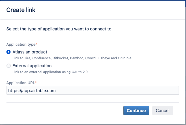

  4. In the "Create Link" form, select "Atlassian Product" for the "Application type" single select radio button field. Although Airtable is not an Atlassian Product, this is the only way to make Jira Server configure the application link with OAuth 1.0 (supported by Airtable) instead of OAuth 2.0 (not supported by Airtable currently).

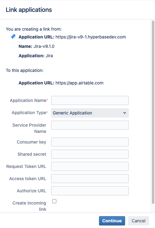

  5. On the first screen of the “Link applications” dialog:
    • In the Application Name box, type Airtable.
    • For Application Type, accept the default value of Generic Application.
    • Check the Create incoming link checkbox.
    • Leave the rest of the fields empty.
      enterprise_how_to_Jira_link_applications
  6. On the next screen of the Link applications dialog, use the Consumer key and Public key you get from Airtable. Put Airtable for Consumer name.
