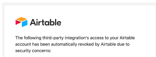

Why does Airtable revoke integrations?
At times, you may encounter scenarios where a third-party OAuth integration has been revoked by Airtable. When this occurs, you will receive an email with the following message:
Third-party tools can use OAuth to allow end users to grant access to their Airtable bases and data. Airtable has security measures in place for OAuth integrations to help keep end-user data safe. If a given third party violates one of these security measures in their OAuth setup, Airtable will automatically revoke the integration and no longer allow access to the data to ensure it is protected.
