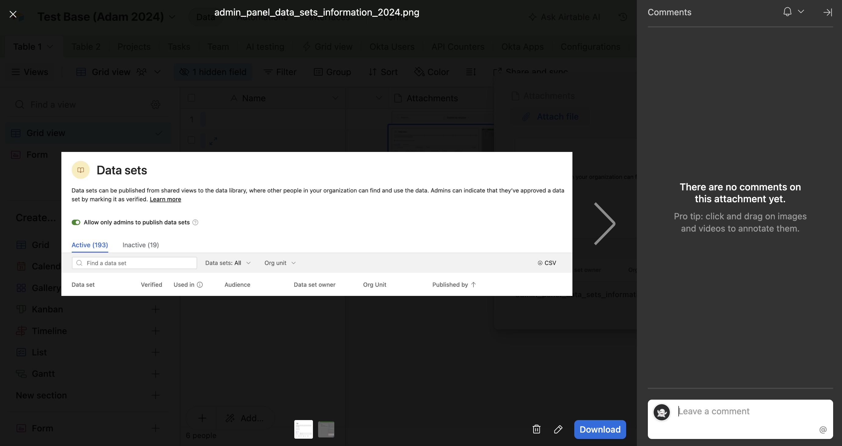

  1. Navigate to the base → table → record containing the attachment that you would like to share.
  2. Click on the attachment you want to share with another user. If the record contains many attachments, then you can expand the selected cell containing the attachment by pressing Shift + Space
  3. From the browser bar, copy the URL and share it with another user who has base access. When they click the link you share it will bring them to the attachment where they can comment or annotate as needed. Note that you can also click Download in the attachment viewer to download and share a local copy of the file with others.
