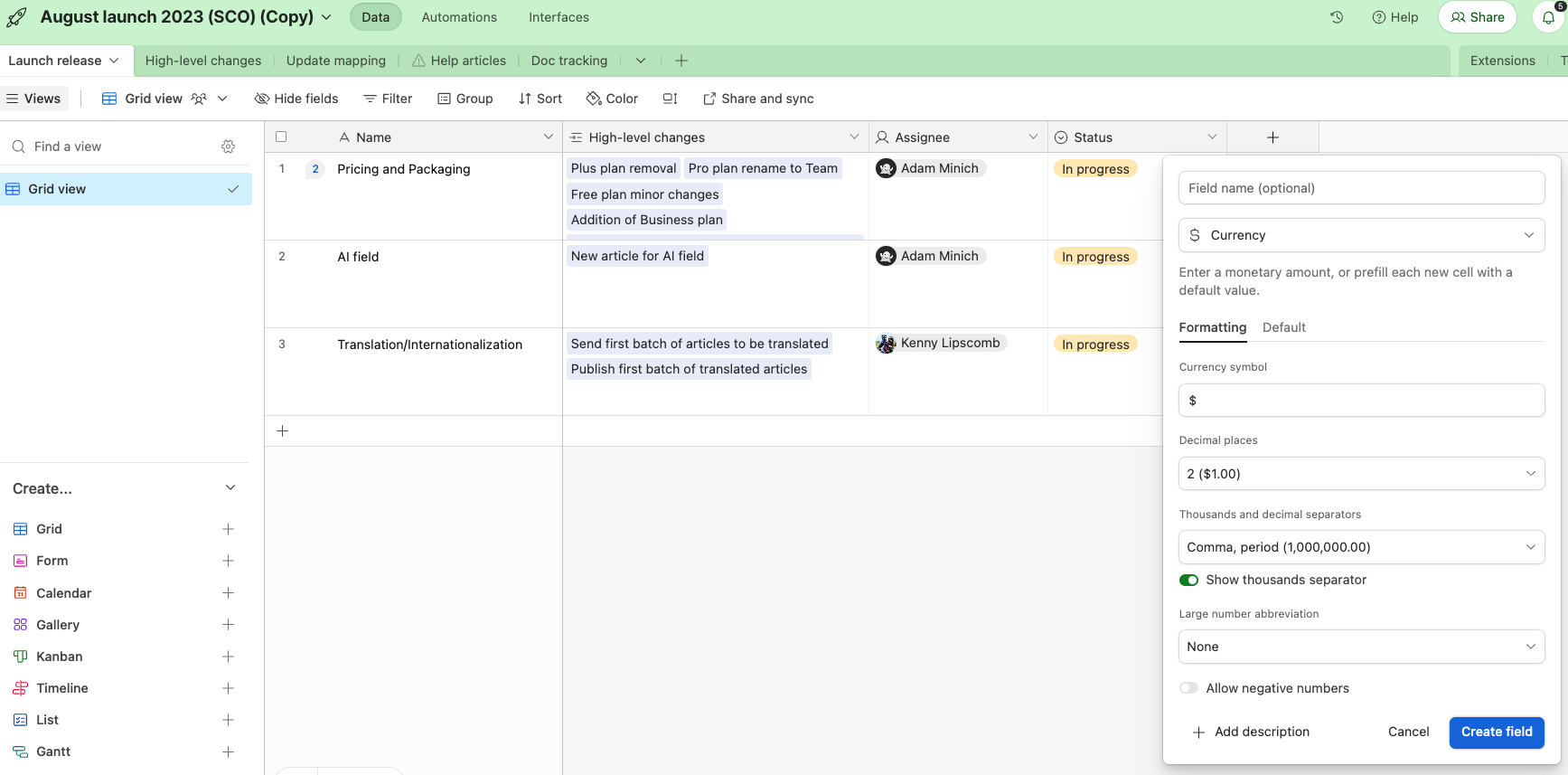

Currency fields
A currency field is a specific type of number field that formats the number as a currency amount. You can specify a currency symbol (the default symbol is $), the number of significant digits, and whether or not to allow negative currency amounts.
Airtable doesn't support using multiple currencies within the same currency field.
  2. Open the base where you want to create a currency field.
  3. Add or edit a field.
  4. Search for and select Currency, then click Create field.
    1. You can optionally update the default settings by clicking Formatting.
    2. Lastly, you can set a default field value for every new record created within the table by clicking Default and entering your preferred number.

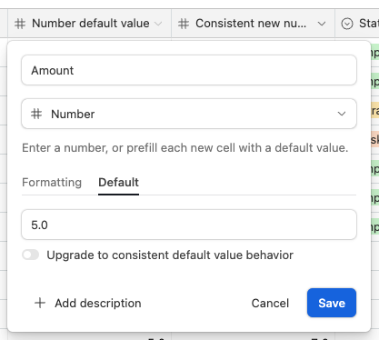

Legacy default values in fields
Single line text, number, currency, and percent fields in bases created before January 31, 2024, offer the option to toggle on/off "Apply default value for all actions."
To toggle on the "Apply default value for all actions" setting:
  2. Open the base with the field where you want to enable the “Apply default value for all actions" setting.
  3. Click the dropdown arrow next to the field you want to edit.
  4. Click Edit field.
  5. Toggle on the “Apply default value for all actions" setting.
Any fields displaying "Apply default value for all actions" rely on a legacy default value used inconsistently. You can toggle "Upgrade to consistent default value behavior" on to address the previous inconsistencies.
The following scenarios did not use the default value for legacy fields but will after enabling "Upgrade to consistent default value behavior:"
  • Using the Airtable automation action: Create record without specifying a field value.
  • Using public APIs to create a record without specifying a field value.
  • Submitting a form without a legacy field.
  • Importing a CSV without specifying field mapping for the related field.
