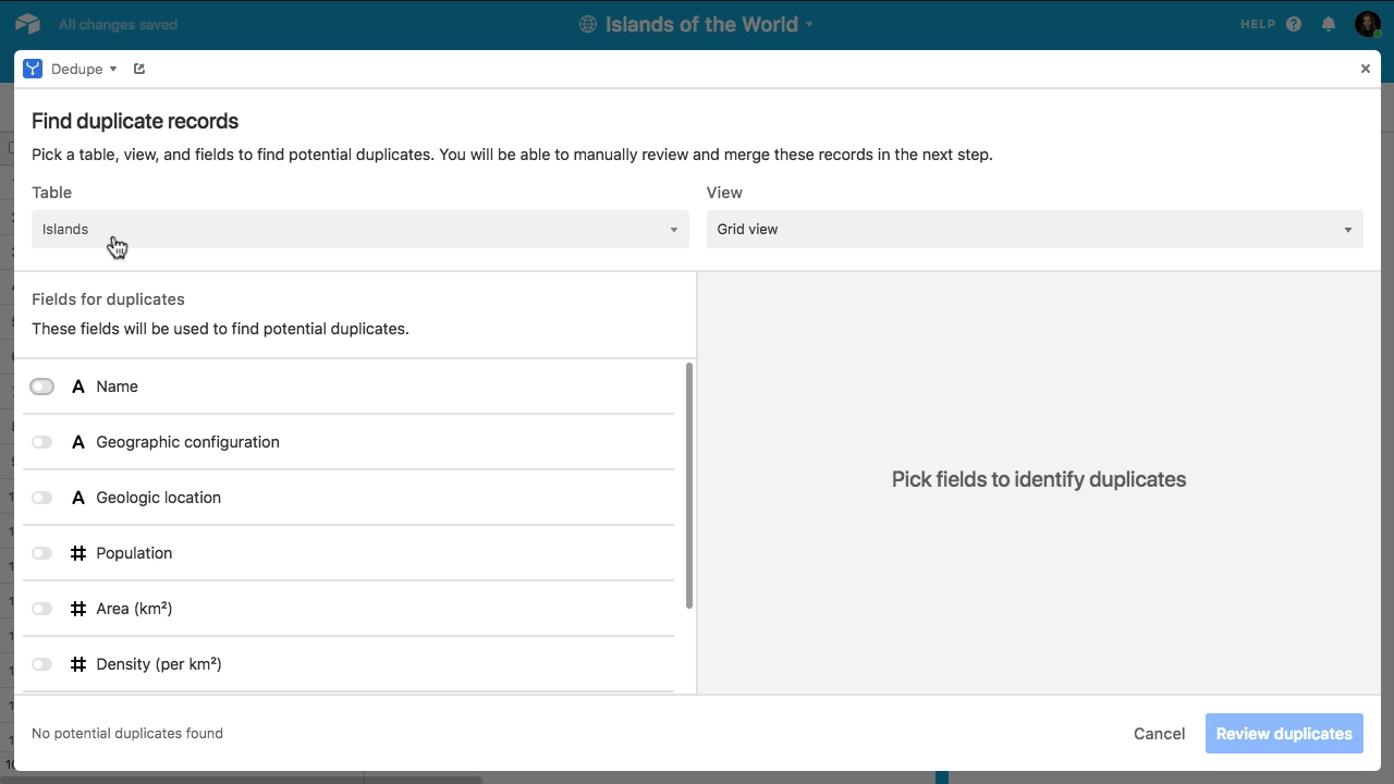

Finding duplicate records using the dedupe extension
  1. After adding a dedupe extension, you'll need to pick the “Table” where you'll be looking for duplicates. If you'd like, you can also choose to limit your search to a specific “View” to only find duplicates within a subset of records.
  2. Next, you'll need to pick the field or fields that you want to use to find duplicates. If you pick multiple fields to find duplicates, the extension will find “sets of records” where the values match for all of the selected fields.
    1. For text field types, you can choose to use exact matching, similar matching, or fuzzy matching. Below is an explanation of what will be found by each matching type:
      1. Exact: Has the same, case-sensitive value
        • Exact example: J. K. Meowling and J. K. Meowling
      2. Similar: Has the same value, but may have different capitalization, punctuation, accents, whitespace, or ordering of words.
        • Similar example: J. K. Meowling and j k meôwling
      3. Fuzzy: Looks for typos and transposition errors (where characters are swapped such as ei vs ie in the word field). Be careful! Fuzzy matching can often result in false positive matches, since its search is so broad.
        • Fuzzy example: J. K. Meowling and J. K. Lemonwig
  3. Once you've picked your field or fields for duplicate finding and determined how strict you want the duplicate search process to be, the dedupe extension will show how many “sets” of duplicate records are in your table or view, plus a preview of those duplicates. Click Review duplicates when you're ready to start deduping your records. Note that you must go through each set of duplicate records individually to ensure the final “merged” record contains the correct information.

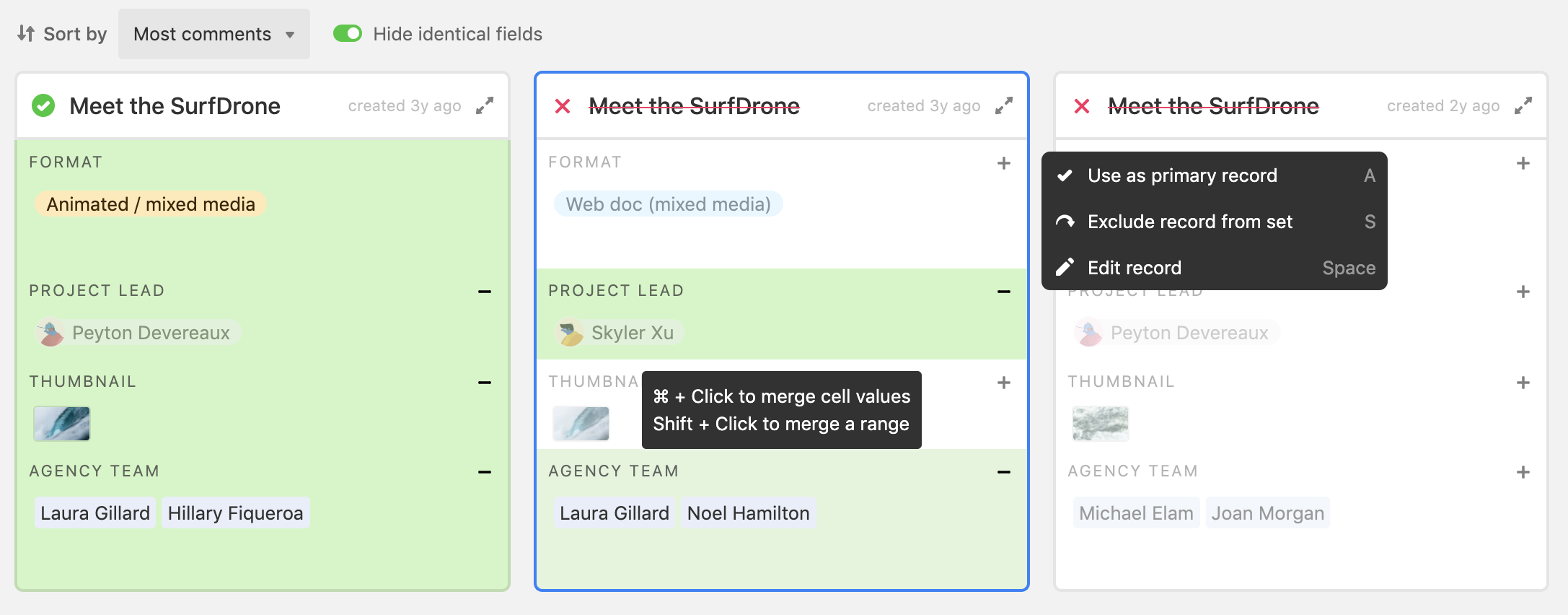

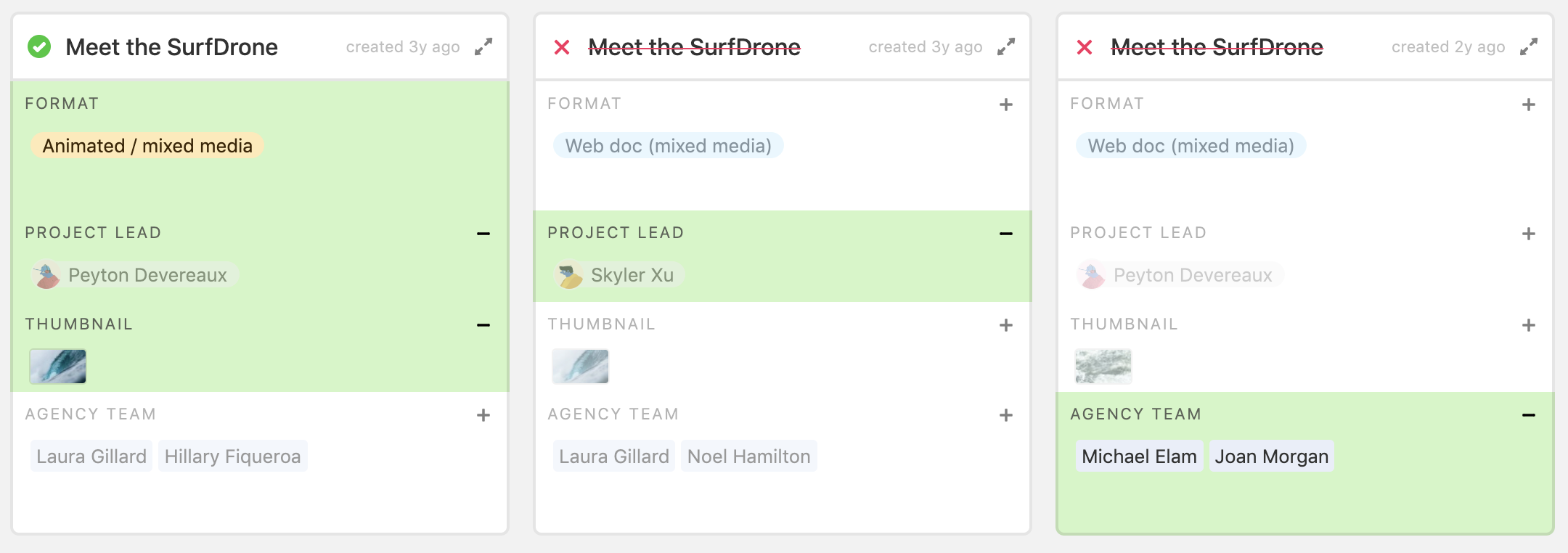

Merging records in the dedupe extension
Once you choose a primary record, you will see a green check mark appear in the header. All other records will appear crossed out. For each field, you can choose one value from the available duplicates. The chosen field will turn green, indicating that it will be included in the merged record. If you'd like to combine values from two or more fields, you can do so by selecting Edit record and then manually updating the desired field.
You can execute this merging process over as many records as you want. The example below shows information being merged from 3 different records. What the new record will look like shows up on the right in the merge preview area.

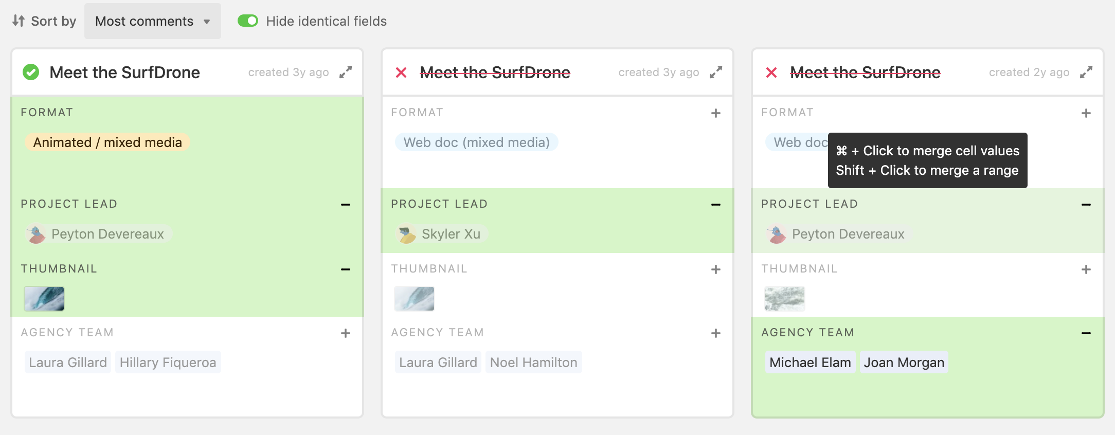

Choosing multiple field values to include in the final result
For some field types that support multiple values (multiple select, multiple collaborator, linked records, and attachments), you can choose to keep multiple values in the final result.
  • You can use the + button on the cell or Ctrl / Ctrl + click to select one additional cell to add to the results.
  • If you click any cell without the Ctrl or Ctrl key, the clicked cell will replace the entire selection. As an example, in the screenshot above, clicking “Agency Team” in the third record would exclude the "Agency Team" cells from the first two records and only include the cell in the third record as shown in the next screenshot.
  • One common flow might be to combine the cell values from all duplicates. For situations where a user wants to merge all the cells for a particular field, they can use Shift + click to bulk-select cells in a range for merging.
  • To do this, you must already have a primary record selected. Shift + clicking another record will select all cells between the primary record and clicked record. For example, in the screenshot above, Shift + clicking the third record selects records 1-3. However, it’s possible that the primary record isn’t the first record in the set. When combining the values from these field types, any duplicates will be removed so that only unique values will be included in the final merged record.
  • Cells without the plus button appearing are not able to have multiple values and so this kind of combining is not available.
