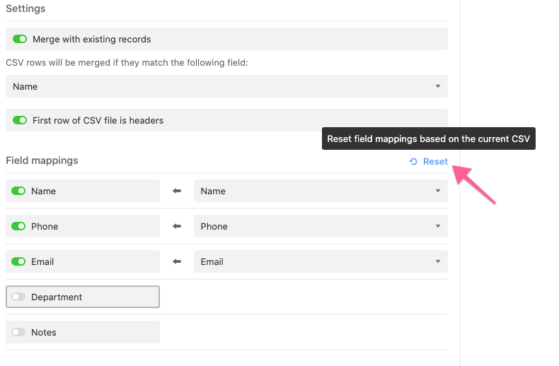

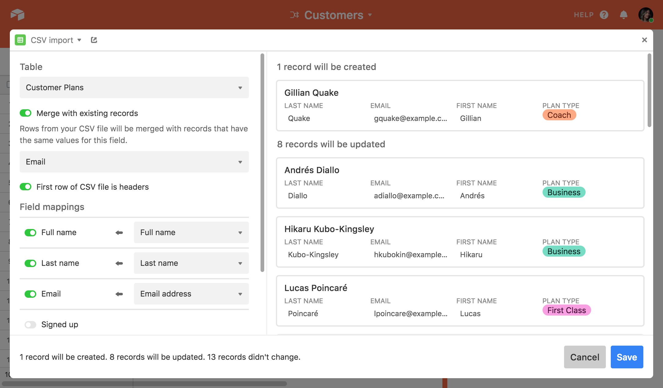

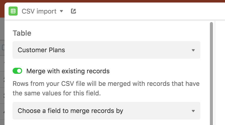

Merge with existing records
If you want to create new records with your CSV data, keep this option toggled off. If you want to merge your CSV data with your existing records, toggle the option on and continue reading below.
To merge CSV data with existing records you'll need to pick a field on which to merge records (ideally containing a unique value like an ID number or email address, for example). The extension will then compare the records in your table with the rows in your CSV, find matches using the field you selected, and update the values in the table according to the contents of the CSV file.
Matching for the field you select will be case-sensitive; for example, the extension will consider "sampleemail@example.com" and "SampleEmail@example.com" to be two different values. However, leading and trailing whitespace will be ignored when finding matches.
Once you pick a field, the extension will display previews for the records to be updated. If the CSV being imported contains rows which have no matches in the table, the extension will create new records. The bottom of the extension window will show the number of records that will be updated, the number of records that won't change, and the number of new records that will be created (if any).
If your CSV contains blank or inconsistent values, you can choose to ignore those fields when importing by toggling the option to "Skip blank or invalid CSV values":
A few other notes on the updating process:
If the CSV file contains multiple rows which contain the same value for the merge field, the extension will only use the first of those rows, and subsequent rows will be ignored.
If the table has multiple records, all of which contain the same value for the merge field, all of those records will be updated if there's a matching row in the CSV file.
If the CSV contains any rows where the value in the merge field is blank, a new record will be created.

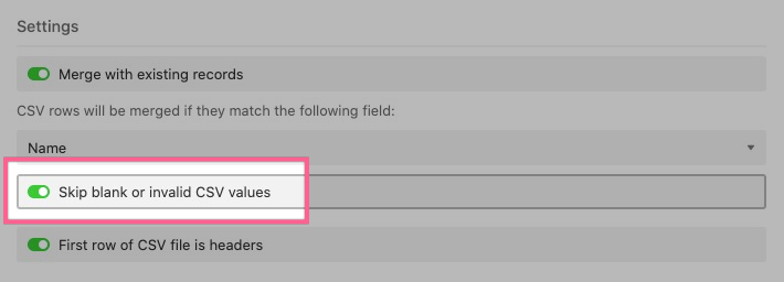

If you toggle on the "Merge with existing records" option (more details on that option below ), another option will appear to "Skip blank or invalid CSV values". This option is helpful if your CSV file might have any blank rows - instead of overwriting existing Airtable records with blank rows, it will skip these rows in the CSV import.

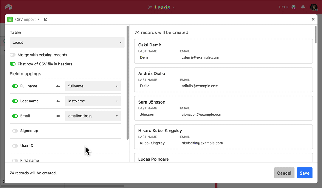

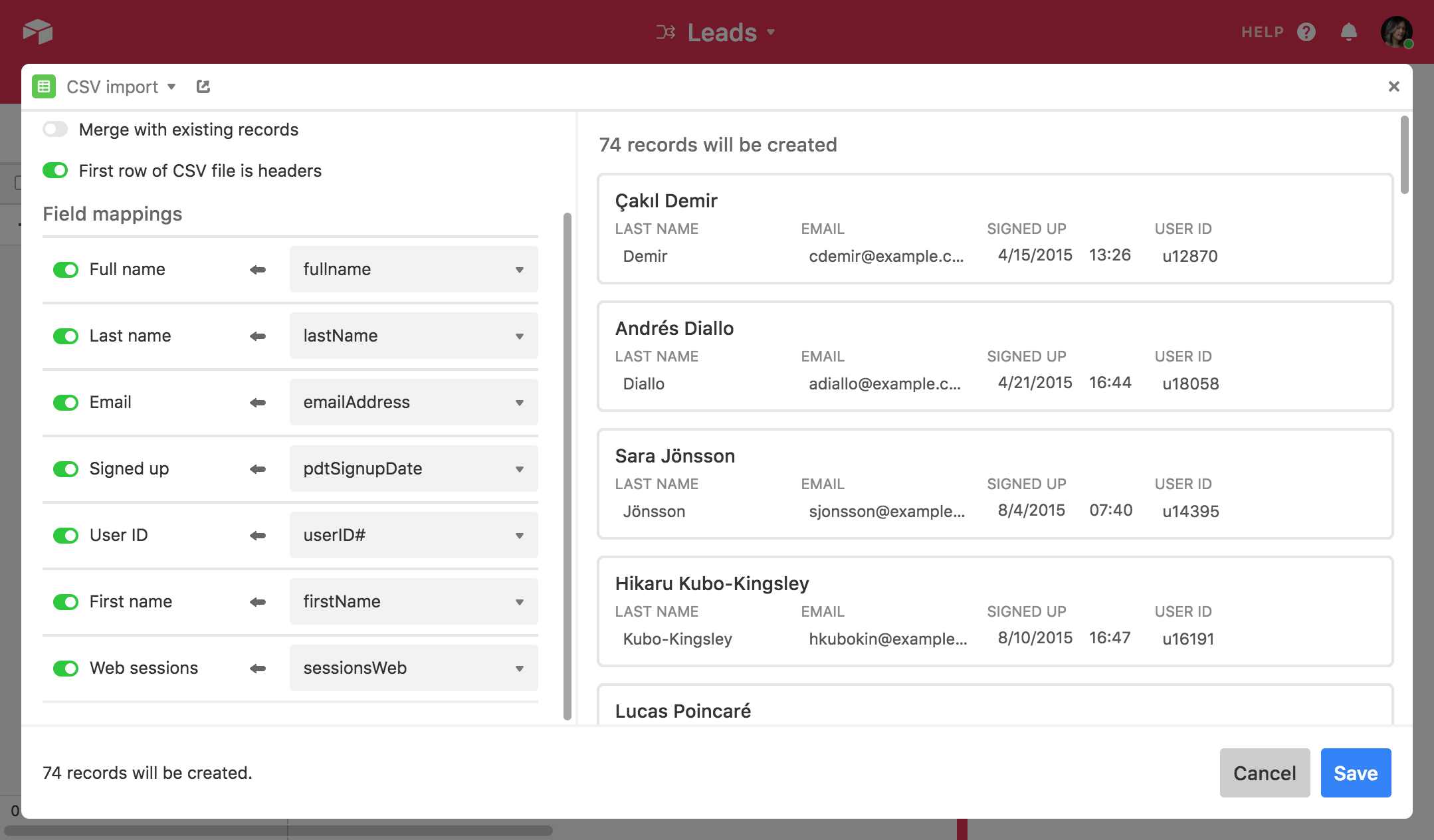

Field mappings
The left side of the Field mappings section (with the toggles) shows the fields in your table, and the right side (with the dropdowns) shows the columns of the CSV. If the columns of your CSV and names of the fields in your table have matching names, the extension will automatically try and match them. Otherwise, you can map the columns of the CSV to whichever fields you prefer.
To map a value, select the field toggle, then choose a CSV column from the dropdown menu. Repeat this process for as many fields as you want.
Note that you don't have to import any fields you don't need to, and the order and names of the fields in your CSV don't necessarily have to match the order and names of the fields in your Airtable base.

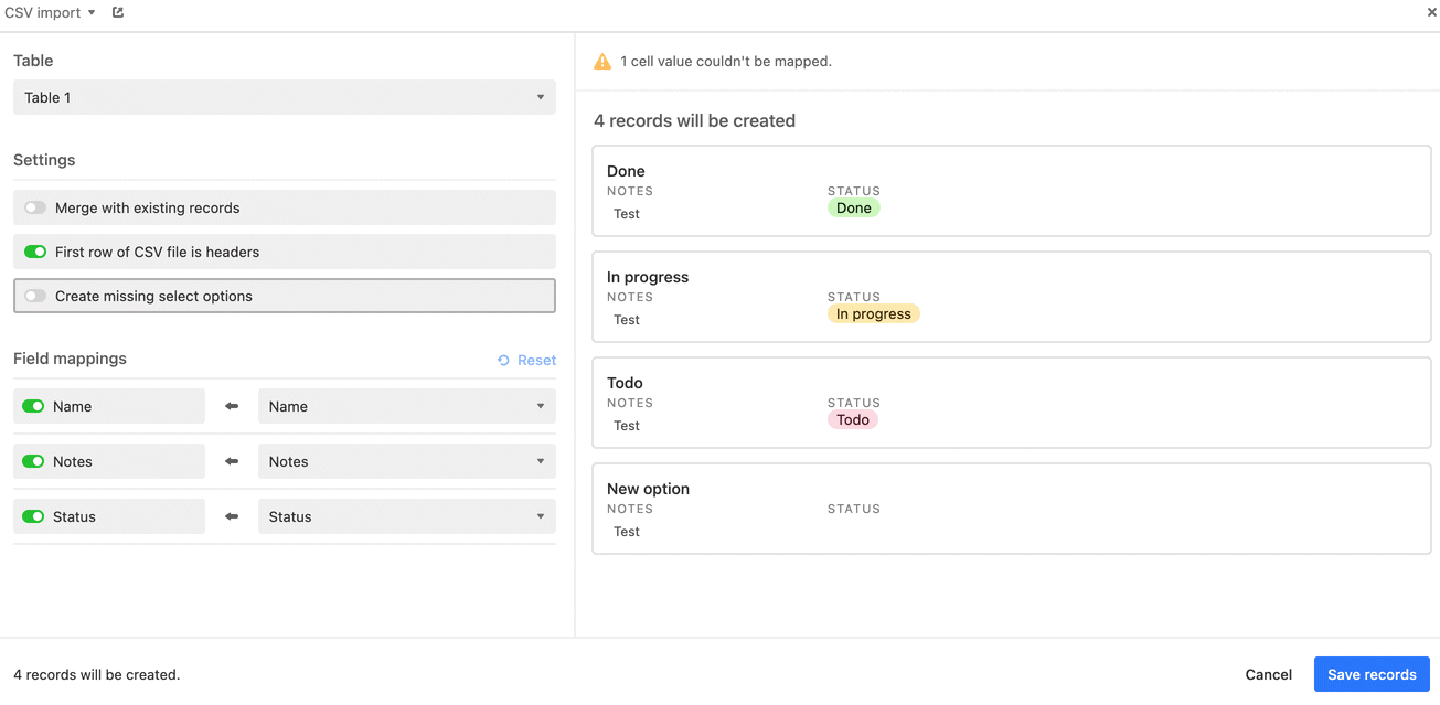

Create missing select options
Turning on Create missing select options requires Owner or Creator permissions on the base. If you have Editor or lower permissions, the toggle reverts to off when you click it and no new options are added to your single or multiple select fields. Ask a base Owner or Creator to grant you Creator permissions, or have a collaborator with Creator permissions run the import.
There is also a setting to create missing select options. Toggling this option on means that if there is a single or multiple select field in your table, then the new option will be created. Leaving this toggle off means that new options will not be created. Pay close attention to field mappings as well as how this setting may be affected by the " Merge with existing records " option mentioned above.
Resetting field mappings
The extension will remember your field mappings the next time you import another CSV, speeding up the process if you plan on importing CSVs again and again as part of your workflow.
However, if you are importing a new CSV file, or if the table where you intend to import has changed, you may want to reset the field mappings using the current CSV and table.
To do so, click the "Reset" button - this performs the field name to CSV header name matching that occurs the first time you use the CSV Import extension , however this time it uses the current CSV and table.

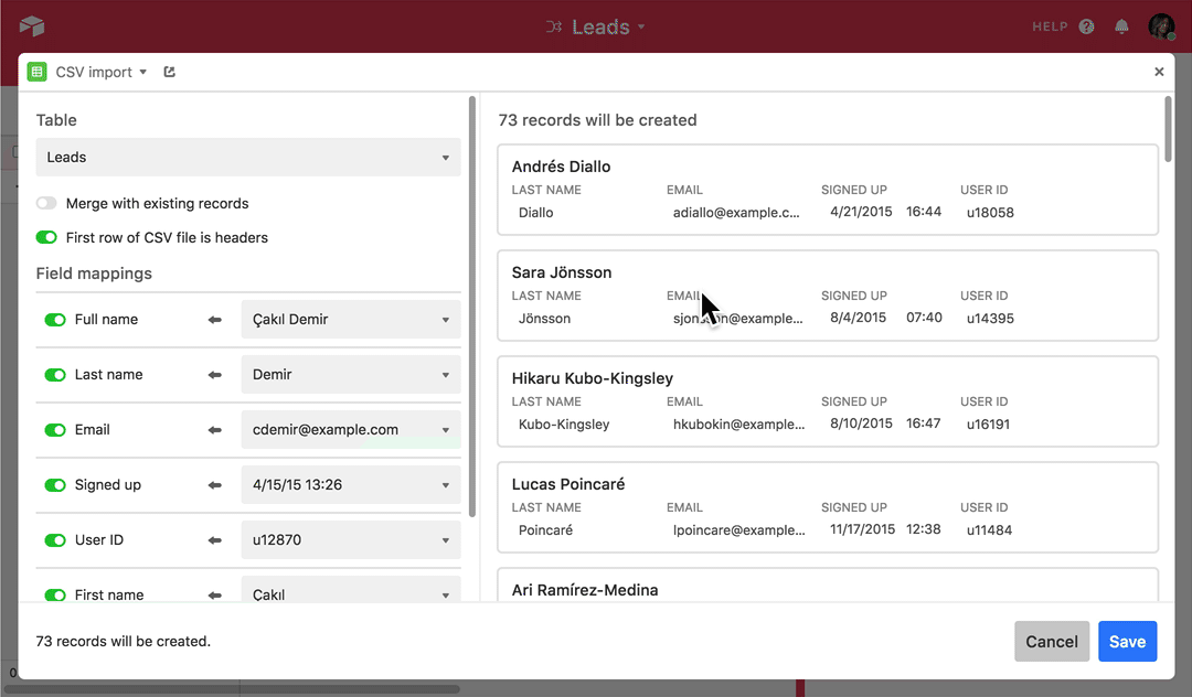

Preview sample records
As you alter the field mappings, you can look at the right side of the extension, which shows samples of the records that will be created according to the specified mappings.
Previewing the records that will be created will likely be your last step before you import your CSV data.
Import CSV data
Once you've configured your settings and field mappings, you're ready to import your CSV data. Click the "Create records" button to start importing data into your table. This may take a few seconds to a few minutes depending on the amount of information you're importing.
Understanding why CSV values don't import
When you map a CSV column to a field that already exists, that field's own configuration decides what it can accept. A value the field can't accept doesn't stop the import—the record is still created or updated, and the cell is left empty instead.
Values are most often left behind in these cases:
Single and multiple select fields — an incoming value lands in the cell only if it already exists as an option on that field, or if "Create missing select options" is toggled on. With that toggle off, values that don't match an existing option import as blank.
Fields with a fixed format — checkbox, date, duration, rating, and similar fields accept only values they can interpret. A date the field can't read, or a word in a column mapped to a checkbox, imports as blank.
Computed and unsupported field types — these can't receive imported values at all. See the FAQs at the end of this article for the full list.
An import that finishes without an error can still leave cells empty. The extension doesn't list skipped values anywhere in its summary, so compare a few imported records against your source file before you treat an import as complete.

Use "Skip blank or invalid CSV values" to avoid overwriting good data with blanks. When merging with existing records, toggle this setting on so blank or invalid cells in the CSV don't overwrite existing values in your table.

Preview before you commit. Use the record preview and the update/no-change/new-record counts shown at the bottom of the extension window to catch mapping or matching problems before clicking Create records.
