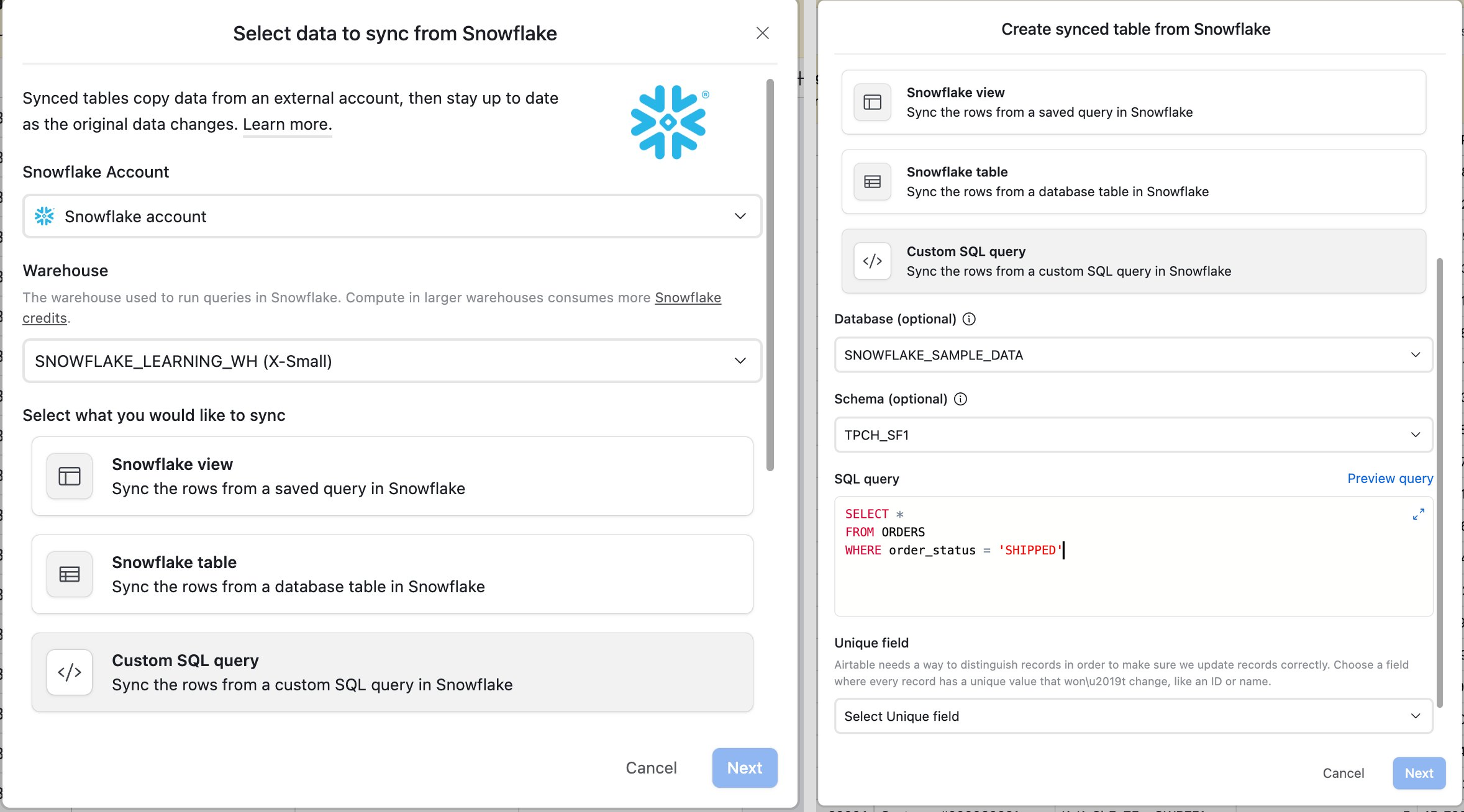

  4. After you have connected a Snowflake account, you can begin setting up the Snowflake sync configuration. The first step is to select the following:
    • Snowflake Account - the Snowflake user connected in the previous step
    • Warehouse - the Snowflake virtual warehouse (compute resources) used for the SQL queries executed when configuring and performing the sync.
      • Note: Snowflake charges for usage based on the warehouse size (larger warehouses consume more credits). A XS (smallest warehouse size) warehouse is usually sufficient even for syncing large tables. A larger warehouse may be needed if syncing a very expensive/complicated view.
      • The size of each warehouse is shown in the dropdown.
    • Snowflake View / Snowflake Table / Custom SQL Query - The source of the data. Both regular and materialized views are supported.
      • If the source is a view or a query, you will then select the database, schema, and the table/view name (Source).
      • If the source is a custom SQL query, you can optionally specify a database and schema before entering the SQL query. If a database and schema are provided, the table names in the provided database and schema don’t need to be qualified in the SQL query.
    • Unique Column - A unique column in the source. This is how Airtable identifies the original row in Snowflake.
      The options above show everything available to the connected user in Snowflake. If the warehouse/database/schema/table/view you want to use is not visible, see the FAQs below.

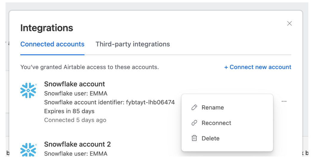

  • Account expiry & how to reconnect an account - By default, Snowflake only allows OAuth authorizations to last for 90 days, after which they expire. After this happens, your syncs will stop working. To get them to work again, you will need to reconnect your Snowflake connection. To reconnect:
    1. Navigate to your Airtable home screen and click the account menu (your profile icon) in the upper-right corner of the page.
    2. Select Integrations.
    3. Click the three-dot menu … next to your Snowflake connection:
    4. Click Reconnect.
      1. After clicking Reconnect, it will bring you through the same steps as Connecting a Snowflake account again - it’s recommended to log in with the same Snowflake user you used previously, but you can also reconnect with a different user if needed.
