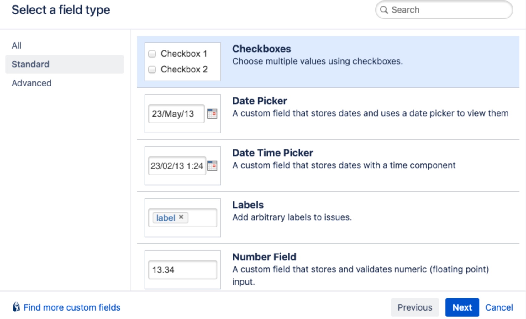

Jira custom fields:
Pre-saved/Locked fields:
Pre-saved/Locked field names are considered custom fields in Jira as well. Jira users are unable to create other custom fields with those names.

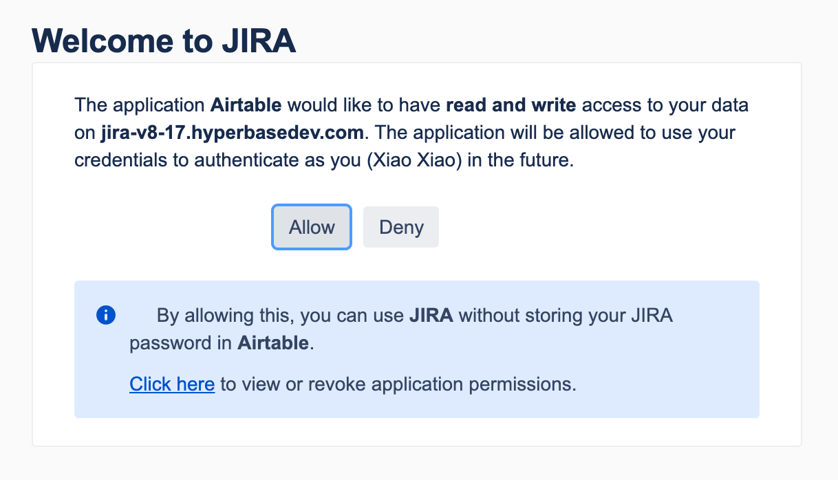

Authentication
The Jira Data Center integration on Airtable uses OAuth to authenticate requests from individual users in your Jira Date Center instance. The OAuth consent screen will look like this:
Airtable will only have access to the issues and filters that the user who connected the Jira Sync has access to. If the user who connected a Jira Sync has their Jira or Airtable account deactivated, the sync will stop working.
There is no separate plugin or app that needs to be installed on the user’s Jira instance. The data that we retrieve from Jira’s API is transmitted securely via HTTPS and will not be used for any purpose other than the synced table.

Can custom fields in Jira be used in the Sync?
Custom fields that are based on Jira's built-in field types are supported, but other types of custom fields may not be supported. More details on this above.
