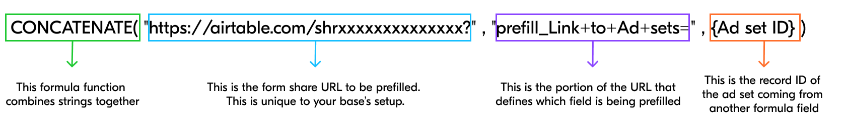

  9. Build a pre-filled URL formula in the primary table - Now create a formula field in your primary table that generates a unique, pre-filled form link for each record. This link automatically populates the linked record field on the form with the correct record ID, so the submitter doesn't have to do anything manually. The formula follows this pattern:
    CONCATENATE("https://airtable.com/shrXXXXXXXXXX?", "prefill_Linked+Record=", {Record ID})
    1. Replace shrXXXXXXXXXX with your form's actual share URL, and replace Linked+Record with your linked record field name (using + in place of spaces, or URL-encoding any special characters).
