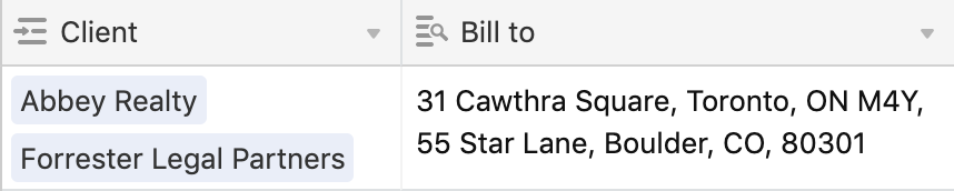

In situations like having a linked record field with multiple records, you'll want to change how information returned from a lookup field appears. If multiple linked records exist, the lookup will concatenate the cell values and separate them with a comma.
While changing the comma separator to another symbol is impossible, you can use a rollup field instead of a lookup field. For this approach:
  1. Add and configure a rollup field.
  2. Copy and paste SUBSTITUTE(ARRAYJOIN(values), ",", " + ")into the rollup aggregation formula.
  3. By using the formula above, the rollup field can substitute the comma separator with something like a "+" icon. You can change the "+" icon in this formula with any symbol you'd like to use as a separator.
