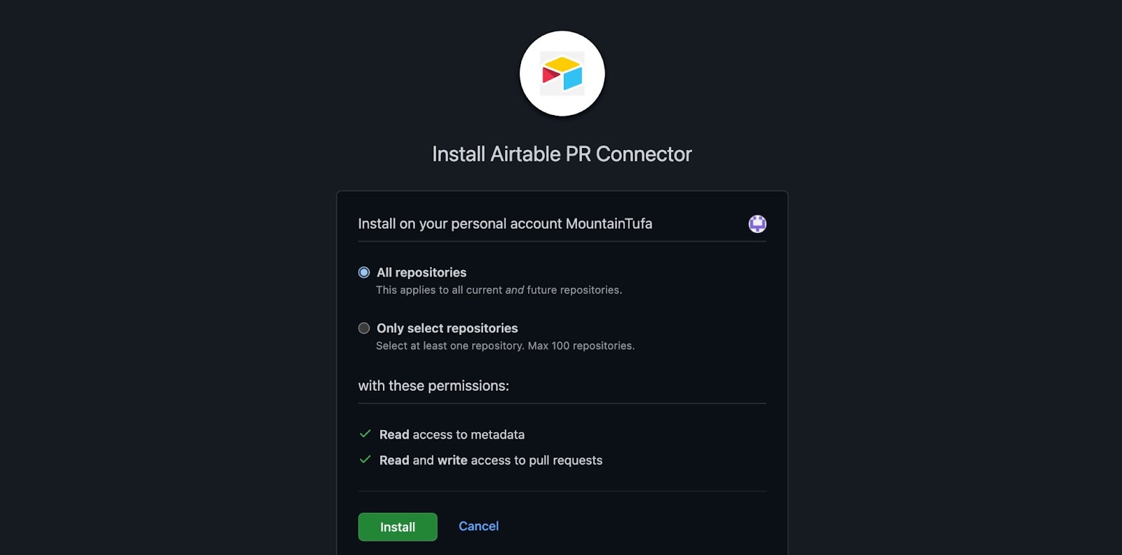

  6. After you have connected your account successfully, you will need to select a repository or "Repo." Click Select repo to begin the process.
    1. If this is the first time you are syncing Airtable with Pull requests in GitHub, then you will need to install an app connector which you can click on within the sync setup window or by clicking here. This is a requirement on GitHub's end that is needed to allow this sync to work. The installation screen will look something like this:
    2. Installing this app allows us to read metadata and read and/or write to issues.
    3. During the app connector installation, you will choose whether to show “All repositories” or “Only select repositories.”
    4. After installing the app successfully, you will see the repositories that you have set up in GitHub. Now you can choose the repo you would like to sync to Airtable.
