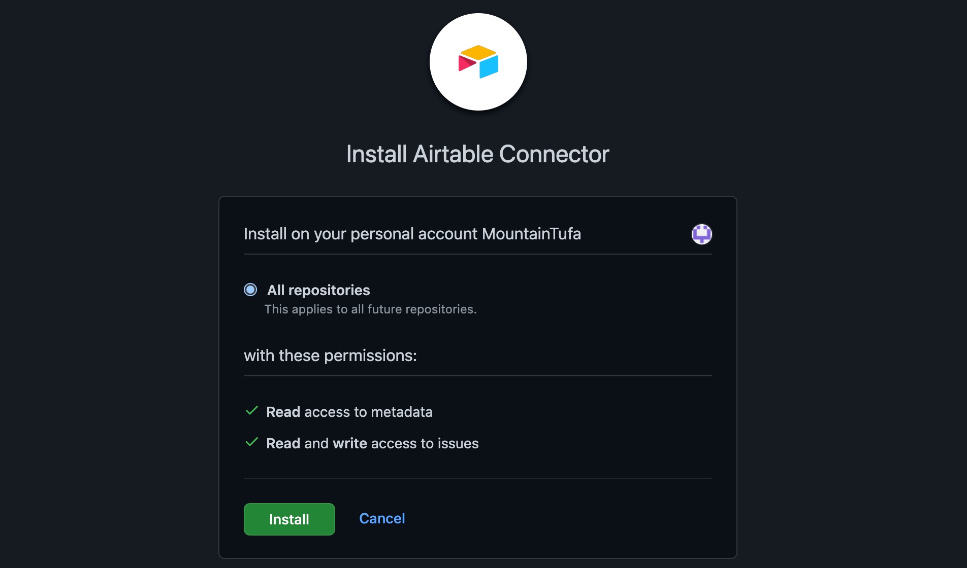

    1. If this is the first time you are syncing with GitHub, then you will need to install the Airtable GitHub app which you can click to within the sync setup window or by clicking here. This is a requirement on GitHub's end that is needed to allow this sync to work. The installation screen will look like this:
    2. Installing this app allows us to read metadata and read and/or write to issues. More information about this is in the Authentication and authorization section.
    3. After installing the app successfully, you will see all of the repositories that you have set up in GitHub. Choose the one you would like to sync to Airtable.
