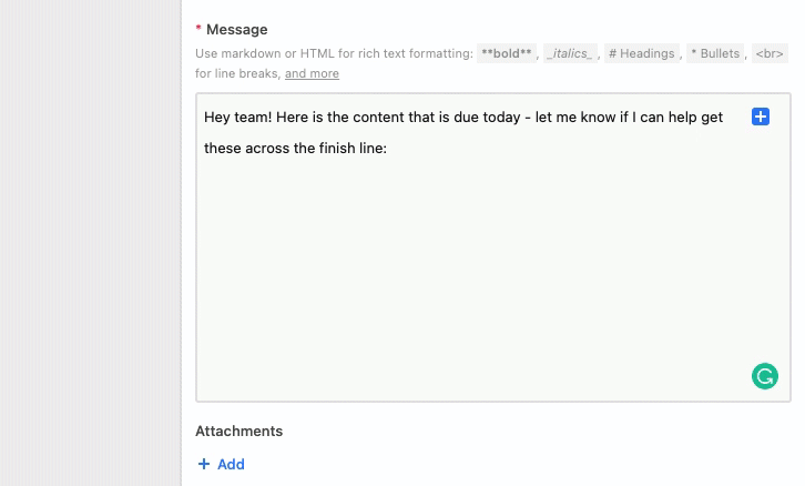

      • You can then customize the email you plan to send. In the example below, we’ll include a short note in the body of the email, and then render a list of records and fields that were found in the trigger step. The “Send an email” action is covered in-depth in this support article. You can also view guides for all other available options here.

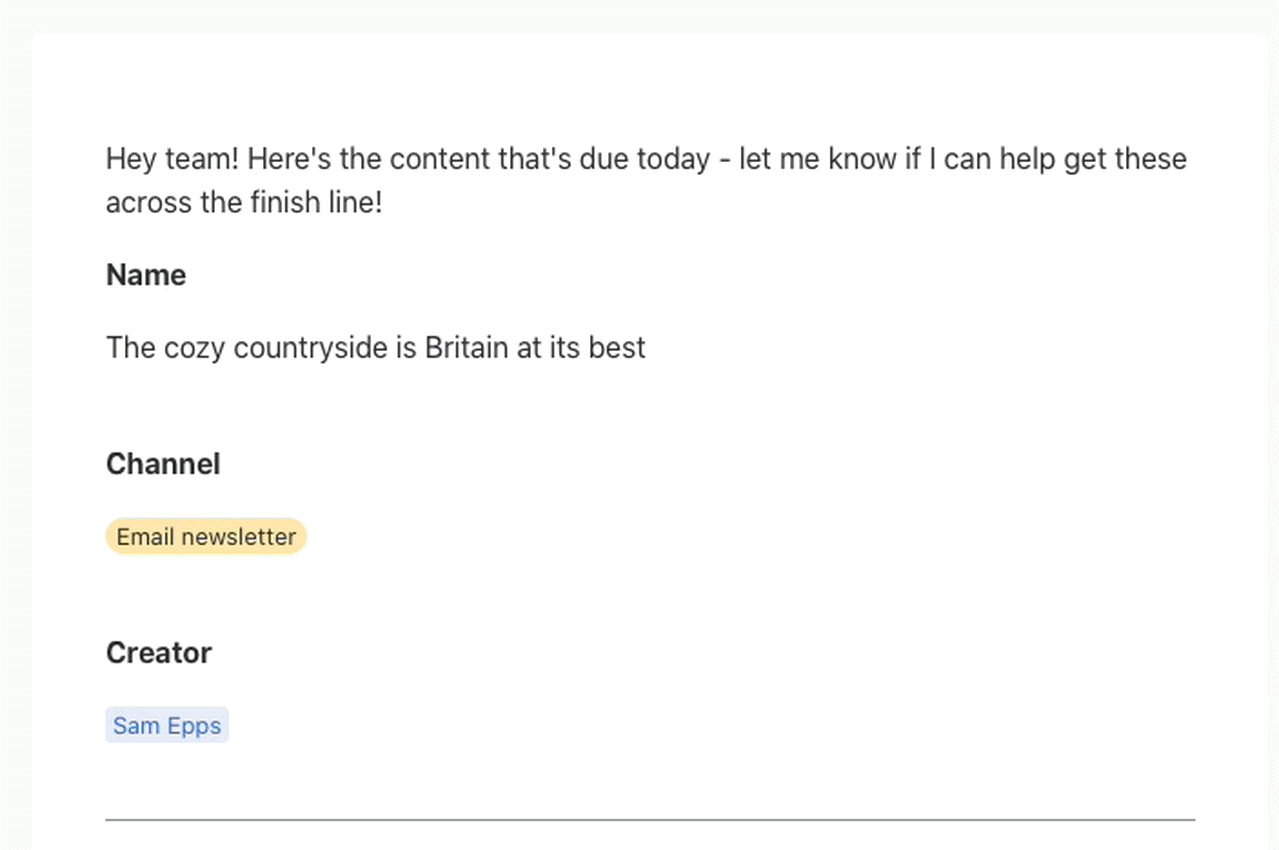

        • Insert records as a list - In the body of the email, one option you can use is to insert the records found in the “Find records” action as a list. You can even choose which fields to include in the list!
          • To add a record list, start by clicking on the plus sign in the “Message” section.
          • Then, choose the option that says “Records” (from the Find records action), and then select “Records” again.
          • Lastly, choose “Insert records as list”. From here you can toggle any of the fields you’d like to include in the list of records. Watch the gif below for an example of these steps.
          • Here’s an example of how this list of records would be rendered in an email:

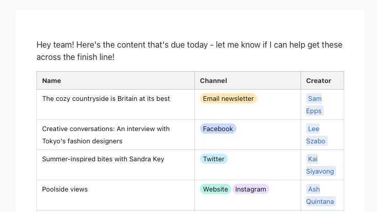

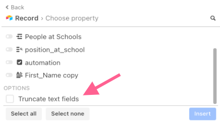

        • Insert records as a grid - Instead of inserting records as a list, you can also insert them as a grid. To do so, follow the same steps as above, but instead select the "insert as grid" option. Here’s an example of how this grid of records would be rendered in an email:
          • All characters in text fields will be included in your grid by default, but you can choose to truncate text fields by checking the box next to the option when setting up the grid.
