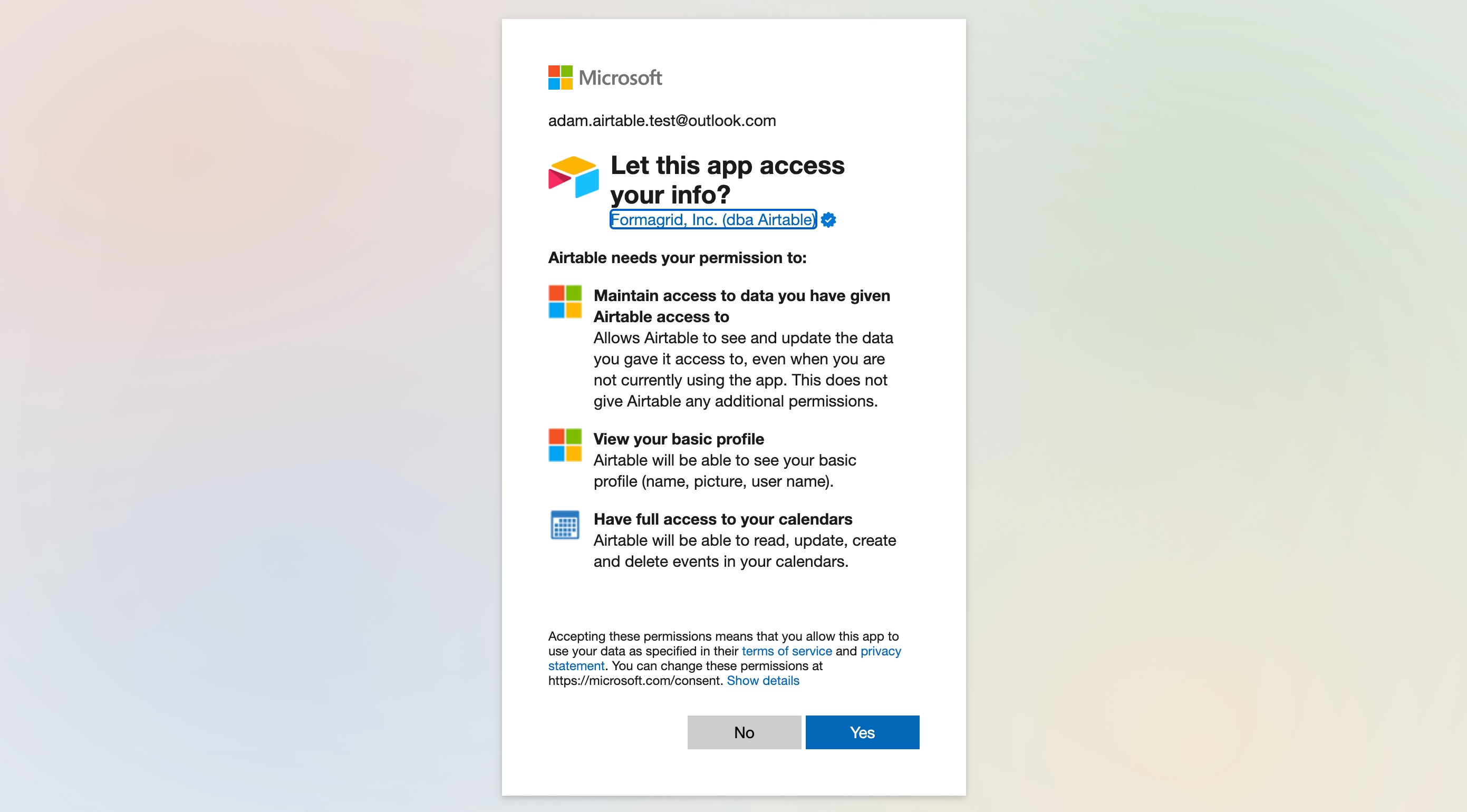

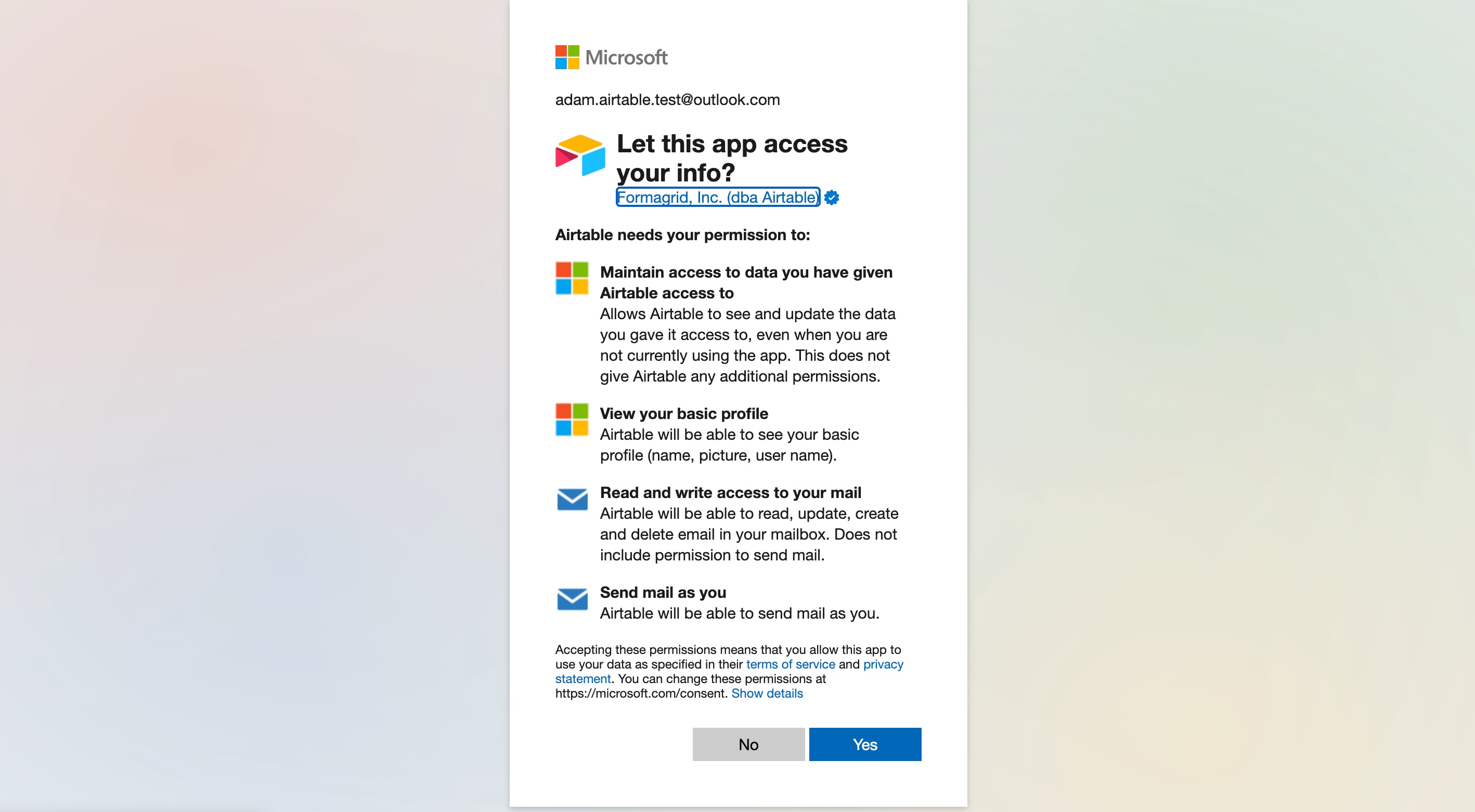

We request the minimum read/write scopes necessary to allow the automation integration to work. The access approval screen will vary depending upon the automation you are creating. Clicking "Yes" means that you will allow us to access the necessary scopes to allow the automation to work. The OAuth consent screen will look like this:
  • Calendar action:
  • Email action:
Outlook scopes
We use delegated permissions for all of our Outlook integrations and tokens are transmitted between Airtable and Microsoft’s servers securely via HTTPS. On Airtable’s side, the tokens are stored in databases that are encrypted at rest.
For more information on Outlook scopes, check out Microsoft's documentation here.
Scope name
Scope purpose
offline_access
For refresh token
profile
For user metadata
openid
For sign-in
Mail.ReadWrite
For reading/writing emails ¹
Mail.Send
For sending mail ¹
Calendars.ReadWrite
For reading/writing calendar events ²
MailboxSettings.Read
For reading mailbox settings related to calendar events ²
Calendar.ReadWrite.Shared
For creating, reading, updating and deleting calendar events
¹ Only for Outlook Email automations
² Only for Outlook Calendar automations
