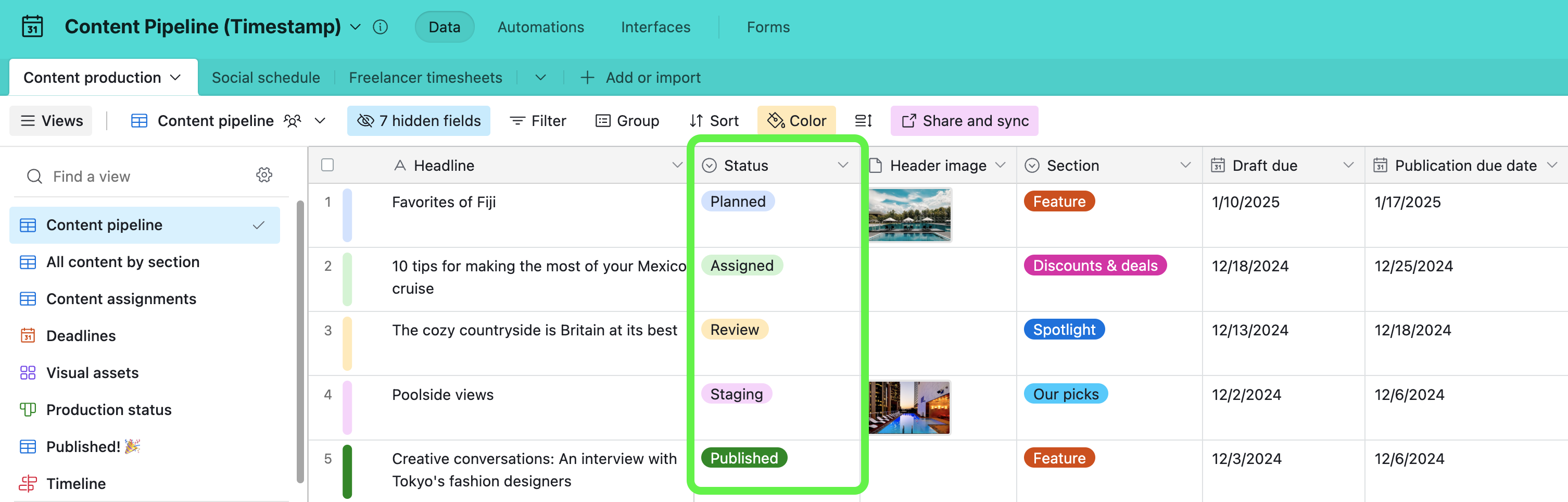

Step 1: Designate a status field
Use a single select field to designate each of the different statuses. In our example, we call this the "Status" field, but you might name this something else depending on your individual workflow's needs.

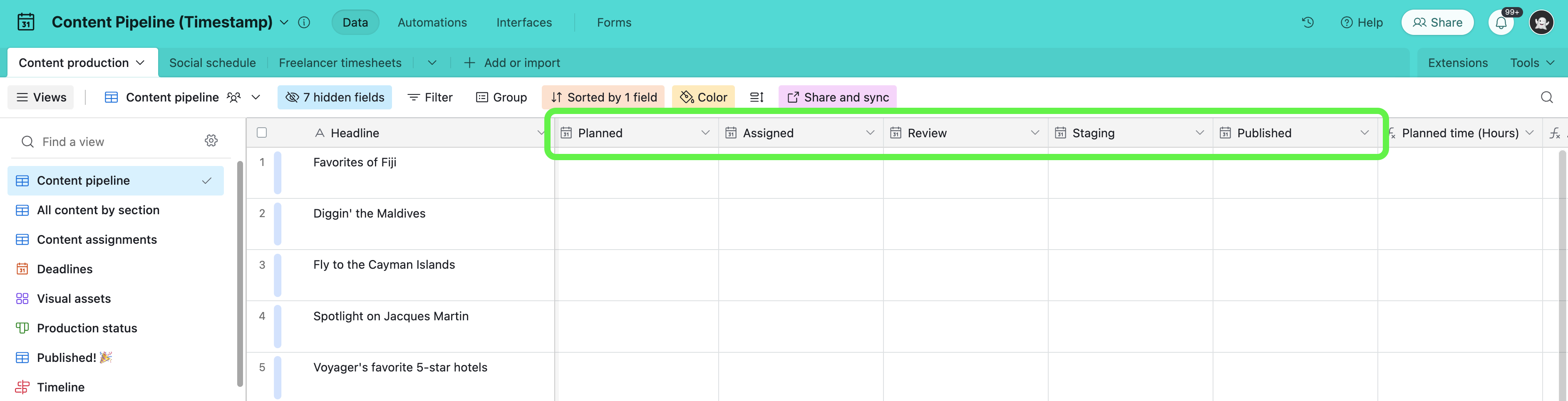

Step 2: Create date fields to timestamp each status change
To timestamp when a record changes to each unique status we need to create five date fields; one each for {Planned}, {Assigned}, {Review}, {Staging}, and {Published}. These fields will be populated later by the automation.

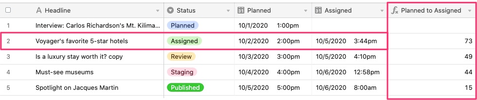

Use formula fields to calculate each status duration
The final step is to calculate the duration that a record spent in a particular stage. In the example below, we'll calculate how long an article spent in the "Planned" stage before moving to "Assigned." You can then modify the formula values to calculate the time spent in each status.
Remember, you'll also need to adjust the values below to fit the names of the fields in your particular base if they don't perfectly align with the example used in this article.
Step 1: Create the first time difference formula
To start, add a new formula field. Then copy in the formula below (making adjustments for field names if yours are named differently).
    AND(
    DATETIME_DIFF(
        {Assigned},
        {Planned},
        'hours'
The formula will check to make sure that both the {Planned} and {Assigned} fields have a date entered, and if they do, it will calculate the time difference between those dates in hours. If you would rather use a different time output, then check out our article on unit specifiers for DATETIME_DIFF() formulas here.

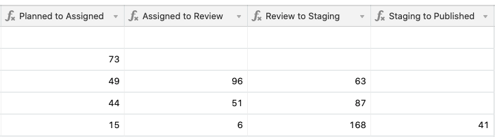

Now you should have four separate formula fields that each output the number of hours a record spent in each stage of the content process.
Step 3: Create a total time to "Published" field
You can also calculate the total time spent from "Planned" status to "Published" status by creating another formula field that sums together the time values from each of the four fields that you just created. That formula could be as simple as:
{Planned to Assigned}+
{Assigned to Review}+
{Review to Staging}+
{Staging to Published}
