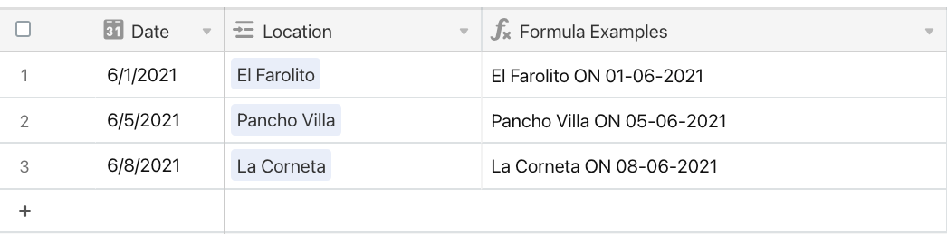

Here's a quick example of how DATETIME_FORMAT transforms a date field from one format to another.
Example showing DATETIME_FORMAT transforming a date from MM/DD/YYYY to DD-MM-YYYY
{Location} & " ON " & DATETIME_FORMAT({Date}, "DD-MM-YYYY")
Notice how the date's format changes from MM/DD/YYYY in the Date field to DD-MM-YYYY in the Formula Examples field.

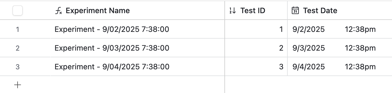

Reformatting a date for use in a primary field
Since a table's primary field should contain a unique value for each record, formula fields are often used to ensure this. The example below shows how to combine static text with a formatted date field to create unique record names.
CONCATENATE("Experiment #", {Test ID})
Using the autonumber creates a unique name for each record, but a more dynamic approach ties the experiment name to the test date instead. The table has these fields:
  1. "Experiment Name"—the primary field, which uses a formula, concatenating "Experiment #" with the Autonumber field (Test ID).
  2. Test ID—an autonumber field tracking unique experiments.
  3. Test Date—a date field tracking when each experiment took place.
To update Experiment Name to include the date, adding the date field directly to a formula without DATETIME_FORMAT outputs it in simplified ISO format—not easy to read. In this case, we could used this formula: CONCATENATE("Experiment #", {Test Date}) .
Updating the formula with DATETIME_FORMAT and a specifier makes the output readable:
CONCATENATE("Experiment - ", DATETIME_FORMAT({Test Date},'M/DD/YYYY h:mm'))
This produces a more readable, unique experiment name for each record:
Screenshot showing a readable, formatted experiment name using DATETIME_FORMAT
Fixing a timezone difference in a formula's output
Occasionally, timestamps in DATETIME_FORMAT appear offset to GMT or another timezone. There are 2 ways to fix this:
  1. The easiest way is to check "Use the same time zone (GMT) for all collaborators" in the date field's configuration menu. This can sometimes have downstream effects—use option 2 in those cases.
  2. A more flexible approach is to use the SET_TIMEZONE function inside DATETIME_FORMAT. For the full list of supported timezone identifiers, see Supported SET_TIMEZONE timezones. Here's an example for a team in the PST timezone:
    CONCATENATE("Experiment - ", DATETIME_FORMAT(SET_TIMEZONE({Test Date}, 'America/Los_Angeles'), 'M/DD/YYYY h:mm'))
    This produces the same consistent results.
