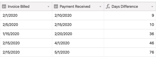

Using the DATETIME_DIFF() function in the example below, we will find the difference, in days, between two dates.
  • "Payment Received" and "Invoice Billed" are the exact names of our two date fields in the example below. You'll need to apply the examples below to the fields in your particular Airtable instance.
  • If your base contains date strings, in a single line text field for example, then you will need to use the DATETIME_PARSE() formula function to convert the dates from strings into a DateTime format that Airtable can use in any subsequent DATETIME_DIFF() formulas.
DATETIME_DIFF( Payment Received}, {Invoice Billed},'days')

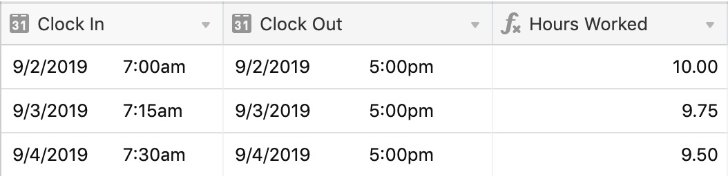

In another example, if you need to measure the time an employee spends working each day, you could create two date fields to track their clock-in and clock-out times. Using a DATETIME_DIFF() function like the following, you can display the total hours worked for the day.
DATETIME_DIFF({Clock Out},{Clock In},'minutes') / 60

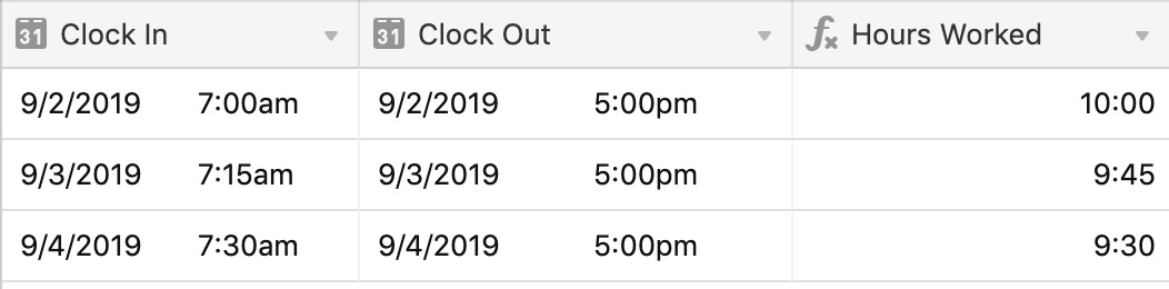

Displaying in duration format
Since duration fields store values in seconds, you can tweak the formula to output the DATETIME_DIFF() value in seconds instead of minutes.  That way, if we format it as a duration using h:mm, we get the expected result.
DATETIME_DIFF({Clock Out}, {Clock In}, 'seconds')
