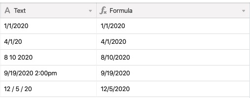

Let’s say you have a single line text field that currently holds the following value: 9/19/2020 2:00pm . Being a text field, this is simply a text string and can't be read by Airtable as a date. This means that it can't be used in the same ways that values in a date field can.
However, DATETIME_PARSE() can read this text string and convert it to a readable date using a formula like this:
DATETIME_PARSE({Text}, 'M/D/YYYY')
