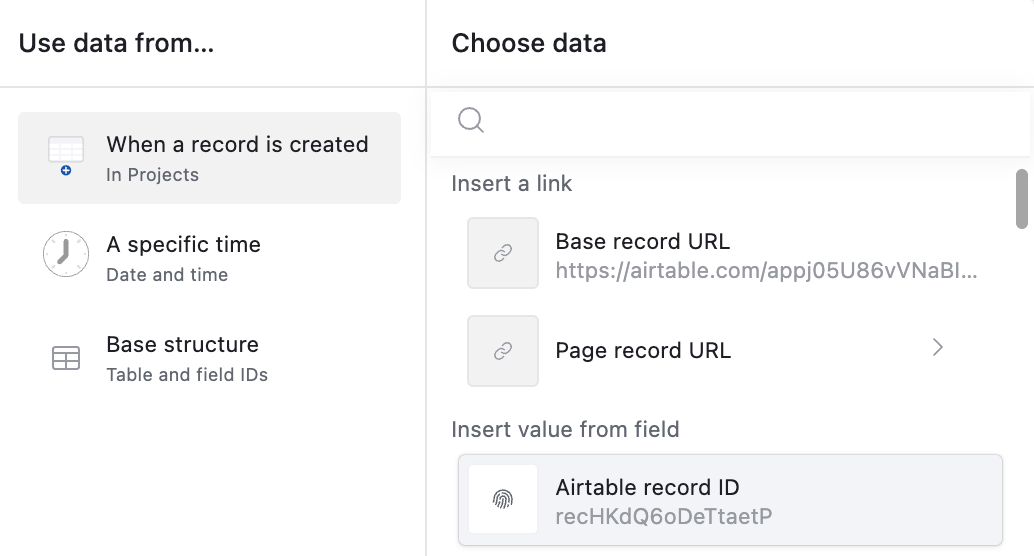

    • In the box under “Record ID,” click the blue and white plus button. This opens a menu of tokens that can be inserted as a “Record ID.”
    • For our example, select “Use data from…” the “When a record is created”—in “Projects”—trigger step. Use the “Airtable record ID token” dynamic token under the “Insert value from field” section.
      When a token under the “Choose data” section has a > icon, there is an additional token properties sub-menu that must be used. This sub-menu appears for values from user fields, select fields, lookup fields, page record URLs, whole-record insertion tokens, and more.

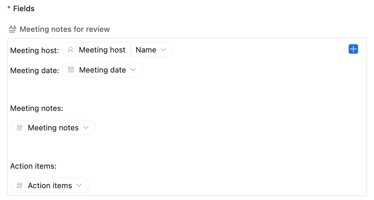

Mixing multiple static and dynamic values in automations
To better understand the concept of using multiple static and dynamic values in an automation let’s use an example where we have a long text field that is holding meeting notes. Let’s say you have an automation with the following setup:
  • Trigger step - Using the “When record matches conditions” trigger, conditions are set such that when a checkbox field “Compile meeting notes” is checked, the automation will run.
  • First automation action step - Using the “Update record” action, we will update a “Meeting notes for review” long text field.
  • Second automation action step - Using the “Send email” action, we will send an email out to everyone on the team in case they missed the meeting or want to review key points.

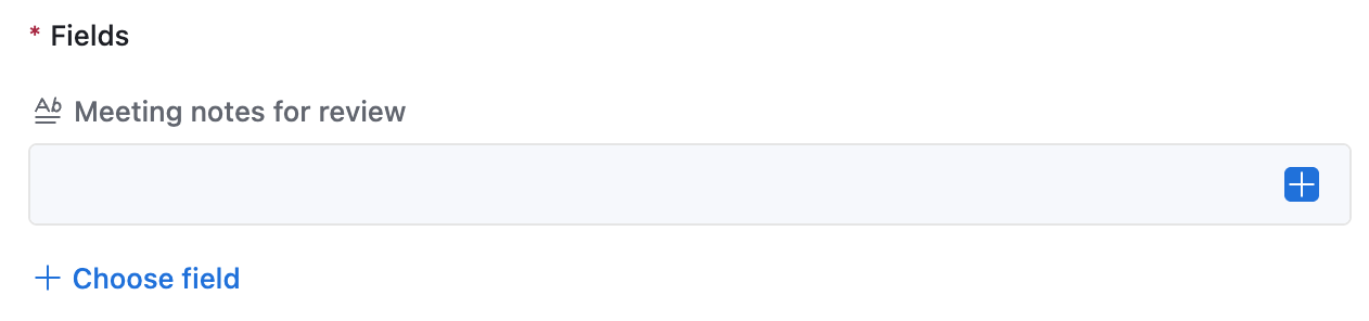

We are just going to focus on the “Update record” action step, and specifically the “Meeting notes for review” field setup for this example. Here’s what a blank meeting notes field will look like:
Meeting notes for review field blank example
There are several fields that get filled out before and during the meeting that we want to add together into the “Meeting notes for review” field that we are updating:
  • Meeting host - In our case, the meeting host is coming from a user field. When we add the token, we will click the Meeting host token and then choose the Name option under the “Insert value from field” section. The other token values (record ID, email, or profile picture) could be helpful in other workflows, but, in this case, we want the user’s name.
  • Meeting date - Note that the token will not inherit the date field’s formatting settings. Instead, it will output in a YYYY-MM-DD format. If you desire another format type, then you will want to consider creating a new formula field that will output the date as a string in your preferred format.
  • Meeting notes - Note that rich text will need to be enabled in both the “Meeting notes” field as well as the “Meeting notes for review” field in order for rich text to be passed over properly in the token.
  • Meeting action items - Similar note to the meeting notes token mentioned above.
Now let’s format this with a mix of static text and dynamic tokens like so:
Meeting notes example static and dynamic text.
Note that when you want to add a new line, press Shift Return. Pressing Return alone will not create a new line.

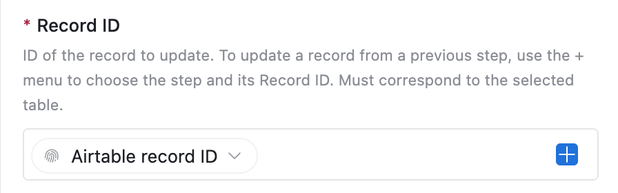

Understanding Record ID tokens versus field names
When configuring automation actions that require a Record ID, it's important to understand the difference between using a Record ID token and referencing a field name. Record ID tokens are unique identifiers that Airtable automatically generates for each record. When an automation action needs to know which record to update, create, or reference, it requires this Record ID—not the name of a field.
  • Common mistake: Entering a field name (like "Project Name" or "Task ID") in the Record ID input box. This will cause the automation to fail because field names are not the same as Record IDs.
  • Correct approach: Use the Record ID token from a previous step in the automation:
    1. Click the blue and white plus button in the Record ID input box.
    2. Select the trigger or action step that contains the record you want to reference.
    3. Choose the Airtable record ID token (not a field name).
For example, if the trigger is "When a record is created," the Record ID token from that trigger step represents the newly created record. This is what should be inserted into the Record ID field of an "Update record" action if the goal is to update that same record.
Record IDs are different from field values. Even if a field in the table is called "Record ID" or contains ID-like values, those are field values—not the Airtable-generated Record ID needed for automation actions.
Linking to a record's interface page
When a token in the "Choose data" section shows a > icon, it opens a token properties sub-menu. The "Page record URL" token uses that sub-menu to ask which interface page the link should open.
To send someone a direct link to the record an automation ran on:
  1. In a "Send email" or Slack message action, click the blue and white plus button where you want the link to appear.
  2. Select the trigger or action step that contains the record.
  3. Select Page record URL.
  4. Select the interface page you want recipients to open.
The token resolves to the triggering record's URL on that page, so each recipient opens the record the automation ran on rather than the page's first record.
