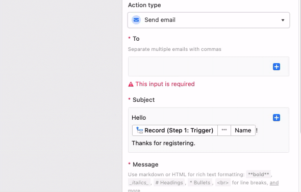

Adding an action
When you have successfully tested the trigger, click on + Add advanced logic or action. Once clicked, the available actions will display for you to choose from.
Choosing an action will bring up different configuration options depending upon the type of action you choose. Let's take the Send an email automation action for example. After choosing this action, you will initially be able to add recipients, a subject line, and the message body.
The text in the body of the message can be a mix of static text and values from the triggering record. You can click the blue and white plus sign to dynamically add values in from the triggering record.
By clicking on the Show more options dropdown, you will have the ability to customize four additional parts of the automatic email you send out, which includes CC, BCC, From name, and Reply to.
This is just one brief example of the power of Airtable Automations. There is also the ability to add conditional logic to your automations which will allow for different sets of actions to be run depending upon sets of specified conditions. More information about that feature is available here.

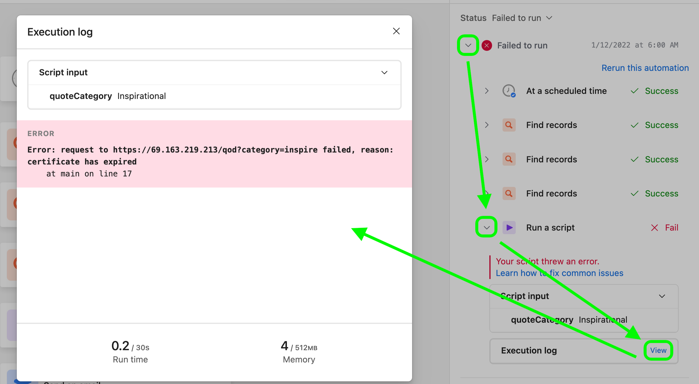

Using the run history
Airtable sends failed run notifications to the last user who enabled the automation containing failed runs. Understanding how to use the run history can help you gain more insight and detail about what may be causing a failed run.

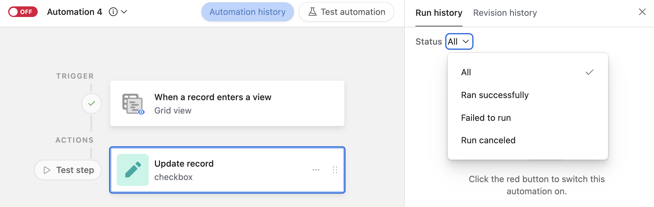

Finding and using the run history
  1. Navigate to the base containing the failing automation. You may also be accessing the failed run via direct link in a failed run notification email. In that case skip to 4 below.
  2. Click Automations at the top of the page.
  3. Select the automation containing the failed run from the automations list on the left side.
  4. Click Automation history.
  5. Click Run History.
  6. From here you’ll see a status option to filter the runs: All, succeeded, failed, canceled, automation run created time, and run status.
  7. When troubleshooting, you may want to choose the “Failed” option, but understanding how successful runs work can also reveal helpful information:
  8. Information in the run history is collapsed. Clicking the > arrows will reveal more information.
    1. First click the > next to the failed run.
    2. Next, click the > next to the automation step that shows “X Fail” next to it.
    3. The example below shows the steps it will take to drill down into an automation failing to run based on a scripting error to find the Execution log, but there are other times when you will need to drill down into view, field, or record values to find the issue that is causing a failed run:

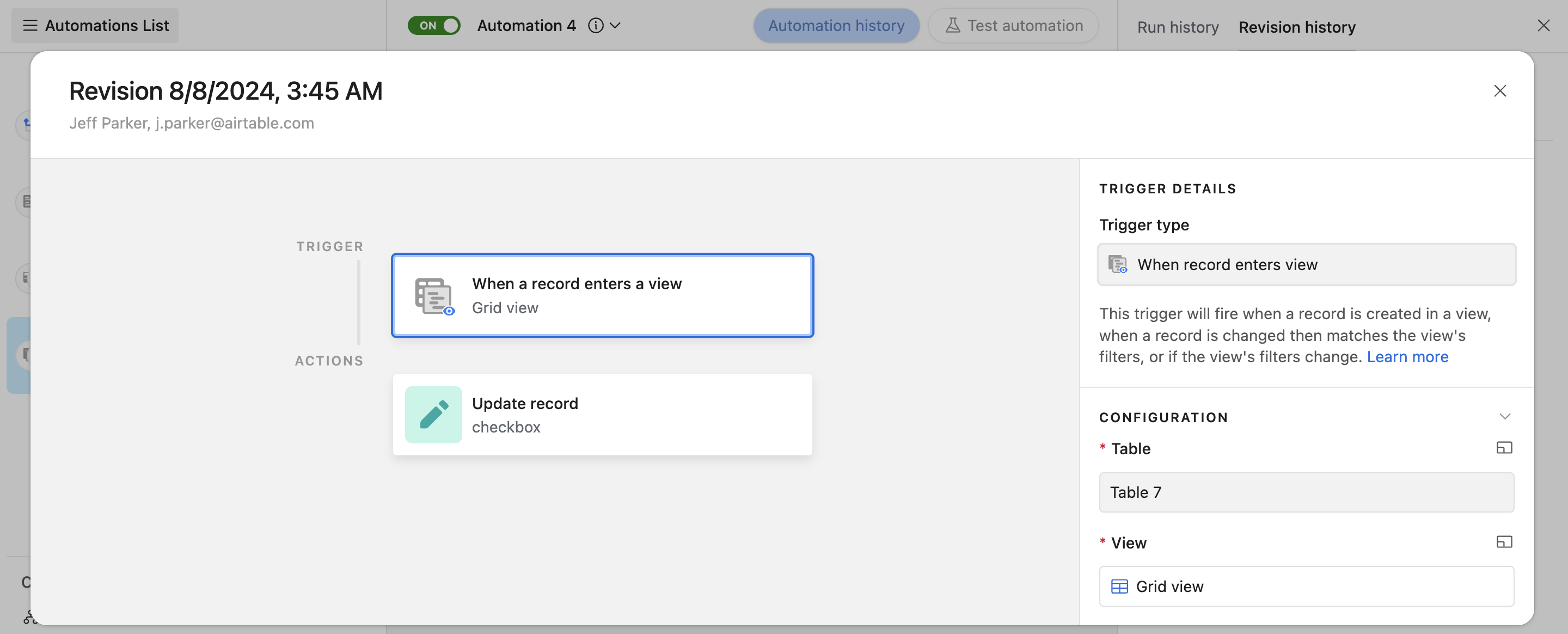

Using the automation revision history
You can also navigate to the "Version history" tab within the "Automation history" section to view previous versions of an automation and whoever authored that change. You may need to access this information to understand in what ways your automations have changed over time.
Finding and using the revision history
  2. Click the Automations tab at the top of the page.
  3. Click on the automation containing the failed run from the automations list on the left side.
  4. Click on the Automation history button.
  5. Click on the Revision History button.
  6. Once an automation has been turned on, a log of changes will appear. You will be able to view the following details after clicking on an individual revision history event:
    1. The date and time of the revision (Time will appear in the user’s timezone)
    2. Which user made the revision (Name and Email)
    3. The configuration of the various steps of the automation (Trigger, actions, repeating groups, etc.). Clicking a log item will open a dialog with details about the configuration of that previous version. You will not be able to edit or test this previous version.

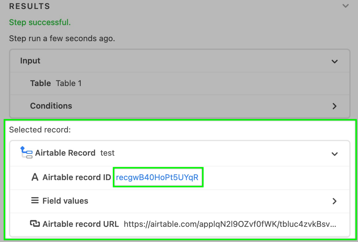

Manually determining a test record
Determining a test record can be extremely helpful in troubleshooting automations. When a trigger has tested successfully a dropdown menu will appear to view more details about the test record used.
You can click on the blue hyperlink next to "Airtable record ID" to open the record within the Automations window as an expanded record. This will allow you to adjust the record in a way that may help to fix errors in your automation.

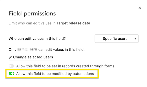

Understanding permissions as they relate to automations
If your base has any field or table editing permissions that restrict editing to only specific users, you can add permissions for automations to make changes using this toggle:

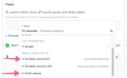

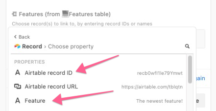

Understanding linking in automation actions
You can use both the "Create record" and/or the "Update record" actions to link new or existing records, depending on the workflow you are building out. You can link records together by using either:
  1. The primary field value of the record in the corresponding table you'd like to link to
  2. Or by using the record ID of the record in the corresponding table you'd like to link to.
If you are linking a single record you can choose to use either the record ID, or the primary field value for the record you'd like to link to:
You can also link multiple records to a single record by looking under the header for "Make a new list of...", and choosing either "Airtable record ID" or "Field values":
You may end up first having to use the "Find record" action to get a reference to the records you want to link, if you are attempting to link pre-existing records in your tables. We recommend checking out this guide for an example of finding and linking records. Check out our Automations troubleshooting guide if you run into any problems along the way.

Is it possible to see a log/revision history of which users edited an automation?
Yes, you’ll find find an automation’s revision history by following these steps:
  1. From a base, click the Automations button on the top left side of the screen.
  2. Click the automation you want to investigate.
  3. Click the Automation history button.
  4. Click the Revision history option. Note that an automation must be turned on at least once before revealing revision history details.

How do I check an automations run history?
For org-wide automation run history reporting, check the admin panel Reports section or contact your customer success manager.
  1. Open your Airtable home page.
  2. Select the base with the automation run history you want to review.
  3. Click Automations in the upper-center of your base.
  4. Click History in the upper-right corner.

How is the test record chosen when testing an action step?
  • Find Records: All matched records
  • When a record matches condition: First matching record
  • When a record is created: First record in the table/view
  • When a record is updated: First record in the table/view
  • When a record enters view: First record in the table/view
  • Google sheets row created: Last row in the sheet
  • New response Google Form trigger: Last response/row in the sheet the response is sent to

Do "Send an email" recipients have to be collaborators?
  • Free - Yes, all recipients must be verified collaborators in the base where the automation resides.
  • Team - Can email 100 unique non-collaborator email addresses per day.
  • Business - 1000 unique non-collaborator email addresses per day.
  • Enterprise Scale - No limit on the number of non-collaborators that you can email per day.
You can see your workspace's limit if you create a Send Email action on an automation.
