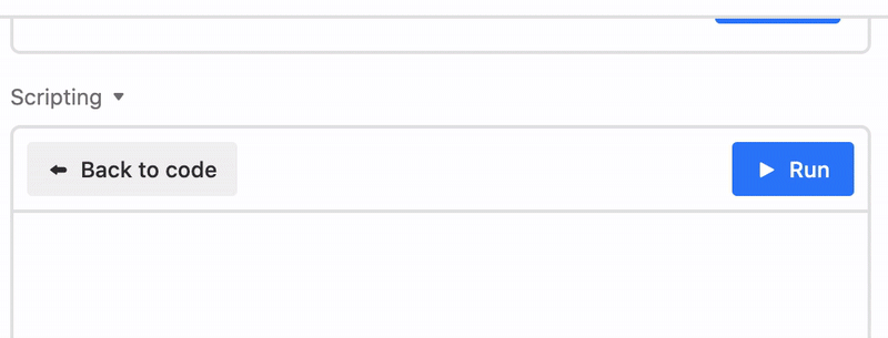

Running a script
To run a script, click the "Run" button in the right-hand results pane. If you need to stop the executing script at any time, you can click the red "Stop" button in the upper right. Once the script is complete, you have the option to run it again using the "Run" button.
