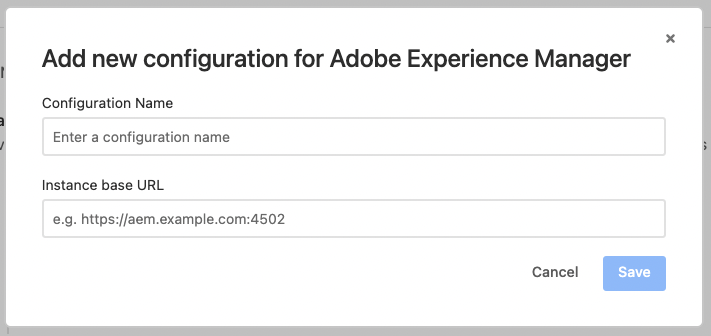

      5. Then, click + Add new configuration next to the Adobe Experience Manager option.
      6. Add a new configuration for AEM. Please use only the base URL of your AEM instance, including the port number if there is one.

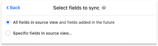

  8. Select fields to sync - After clicking next, you’ll be presented with two sync options; you can sync:
    • All fields from the source view (AEM folder), including any fields added by Adobe in the future.
    • Specific fields from the source view. If you choose to sync specific fields you’ll be shown a menu where you can toggle each individual field that you want to sync from AEM.
