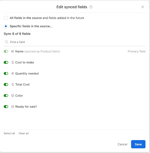

You may be seeing this error message because, in one of your sync sources, a field isn't mapped to its proper sync destination.

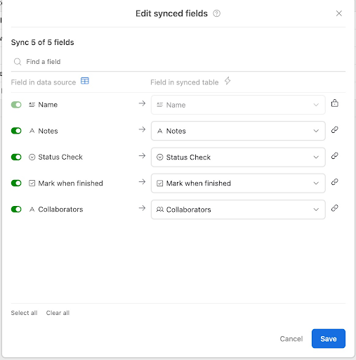

For two-way synced tables, every source of the sync must contain a two-way syncable field mapped to its respective target field for that target field to be editable. If these settings aren’t aligned, error messages can pop up on your two-way synced table.
If you click the option to 'Edit synced fields' under the sources feeding into your synced table, a window should open outlining the current sync mapping route:
Toggling the field On and checking that it’s mapped to the correct destination field should help with this issue.

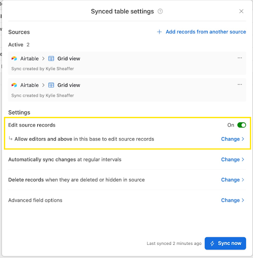

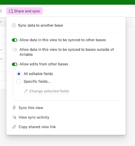

Additional requirements for proper two-way syncing include:
  • All sources must have data syncing to that target field
  • All sources must have "Allow edits from other bases" enabled in their sync view settings
Source settings for two-way synced tables should look like the following:
Destination/Target settings could look like the following:

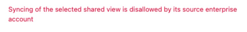

“Syncing of the selected shared view is disallowed by its source enterprise account”
When sync restriction settings in admin panel are adjusted and a user attempts to create a sync share link, they could see this error message:
We suggest finding an admin at your organization who can help address this by managing the organizations’ synced view restrictions from the admin panel.

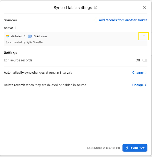

  • In the sync's configuration settings, there should be an option next to the sync’s source to click a button that looks like an ellipses:
  • Under those settings, there should be a button to Edit synced fields. A popup should appear, outlining the fields currently synced from the source to your target table. Check that the missing field is visible in your source and is currently toggled On.
  • From there, we encourage you to check out the target table again, to ensure that the field is currently hidden from the table.

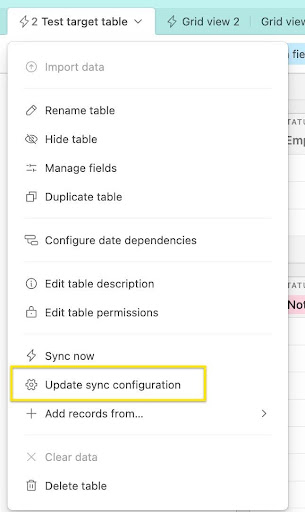

How do I find the source base and view that a synced table is syncing from?
Open the synced table in the destination base, click the dropdown arrow next to the synced table's name, and open the sync settings (Update sync configuration / the sync status section at the top of the table). The source details — the source base and source view the table pulls from — are shown there; hovering over the sync section surfaces the source base.

  1. Open the synced table and click the dropdown arrow next to the table's name.
  2. Click Update sync configuration to see the source base and source view.
