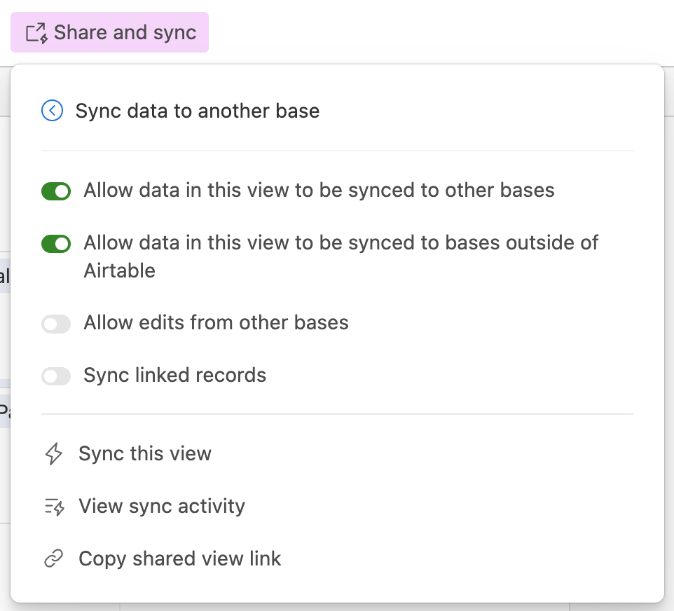

    1. After determining or creating a grid view to use as the sync source, find the Share and sync button and click it. We cover more about the view share menu in this article.
    2. This will open a menu of options. Click Sync data to another base.
    3. From here, you'll next toggle on the option to Allow data in this view to be synced to other bases.
    4. This will cause additional configuration settings and sync options to appear. You can move on to the next step now.

    2. There are additional settings to consider:
      1. Allow data in this view to be synced outside of your org unit (Enterprise Scale/Business plans only) - By default, this option is toggled off. Additionally, this setting may be overridden by “Synced view restrictions” set in your organization’s admin panel settings.
      2. Allow edits from other bases (Enterprise Scale/Business plans only) - AKA enabling two-way sync. Learn more here.
      3. Sync linked records - This feature enables you to sync linked data across multiple bases while maintaining the links between records in different tables. Learn more about this feature below.

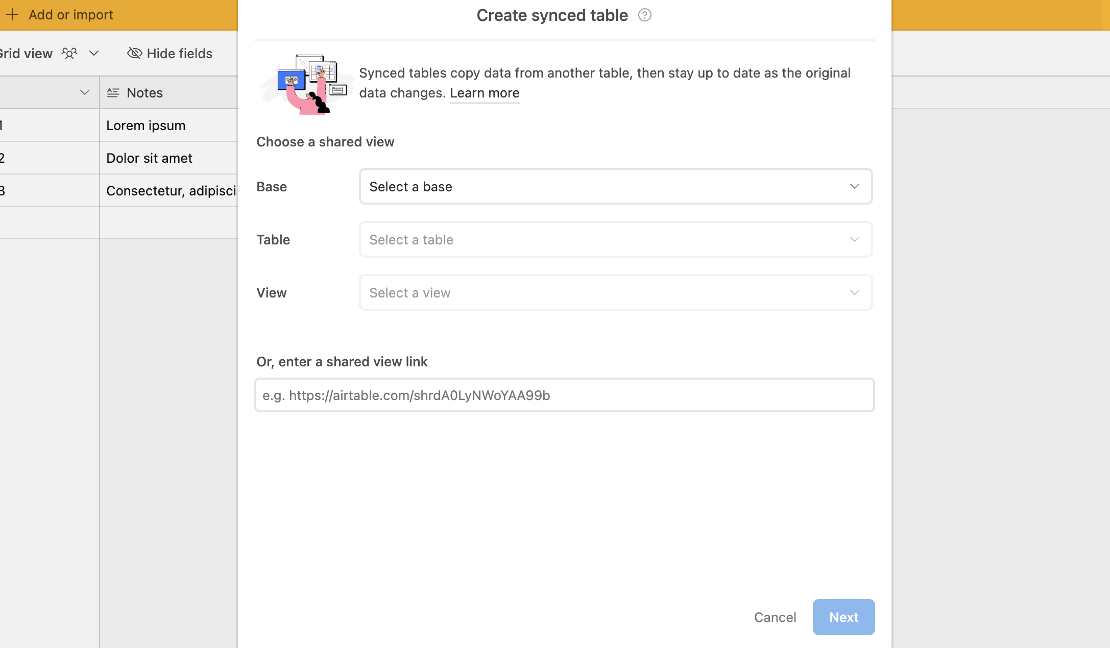

  4. Begin configuration in a destination table
    1. If you clicked Sync this view in the last step you can skip to the next step, otherwise, navigate to the base where you want to set up the sync and follow these steps:
      1. Click + Add or import to begin creating a new table.
      2. Under Add from other sources choose the Airtable base option.
      3. This will open a configuration window where you can either select the Base, Table, and View to use as the source or enter the shared view link from the previous step. Click Next when you are ready to move on.

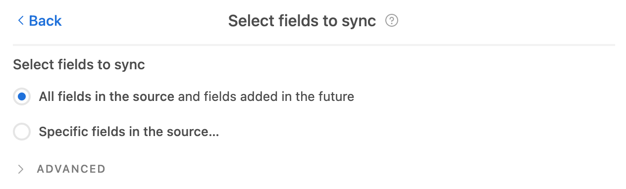

      1. Choose to sync:
        1. All fields in the source or
        2. Specific fields in the source...

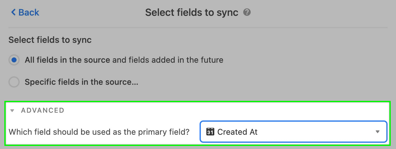

        3. Note that the Advanced section includes the option to set a different primary field for the sync. This is covered in another section below.

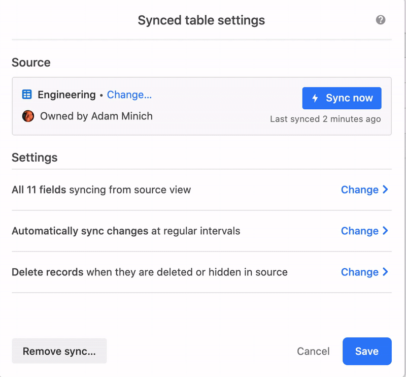

      2. Click Next. Additional options will appear that include:
        1. Whether or not users can Edit source records. This option may not always be available, as two-way syncing will need to be enabled. We cover that option in more detail in this article.

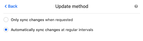

        2. Sync frequency - Can be set to automatically update the sync or only sync manually. More information about these options is listed in the dependencies section below.
        3. Record deletion behavior - Can be set to delete when records are deleted in the source or to be kept in the base even when they are deleted in the source. Again, more considerations are available in the dependencies section.

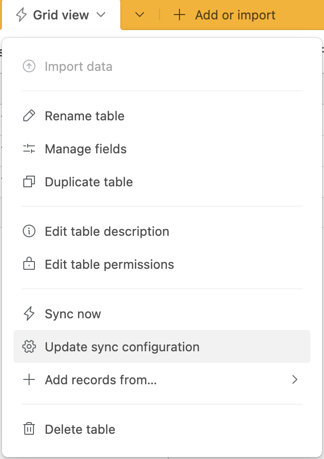

  • If you'd like to go back and adjust a sync's settings later, then navigate to the Update sync configuration option from the destination table's drop-down menu.

Reactivating a sync in Airtable
  2. Open the base with the broken sync.
  3. Click the arrow icon to the right of the base’s name.
  4. Click Update sync configuration.
  5. Select the sync source.
  6. Click Start sync.

In the sync configuration process, there is an option to sync manually or automatically (Workspaces on the free plan will not see an option to sync automatically).
  • Turning on automatic syncing will cause the synced table to update in real-time. You can still manually sync a table, even if you have turned on automatic syncing. There are a few exceptions to real-time sync behavior:
    • Time-based formula fields (and all dependent fields) will not be instant – instead, they will periodically update.
    • Table syncs with Field Type Customized Linked Records will not be instant – instead, they will periodically update.
Automatic syncs will eventually stop on bases that don't have any recent activity. To keep automatic syncs active make sure that some kind of action is being performed in the base on a regular basis. This can be accomplished via Airtable Automations or API. The idea is that by having either of these options periodically make an update to a base you will be able to trigger the automatic sync to run.
  • Manual sync can be accomplished on any plan at any time you choose. To manually sync your table click on the synced table's dropdown menu and click "Sync now". After you click the table will begin to update and save any changes. This process may take more time depending on the amount of information being synced. You will see an "All changes saved" message when the sync has finished successfully.

From the sync configuration window, you can choose to sync all fields from the view or just some:
  • If you choose to sync all fields, then new fields added in the sync source will show up in the synced table when the next sync occurs.
  • If you choose to sync just some fields, then any new fields added in the source table will not sync until you have toggled them on as visible from the sync configuration window.

Primary field customization
We recommend carefully considering your primary field choice to ensure it meets your needs from the start. Once a primary field is selected for your destination table, it cannot be changed after the sync is created. To modify the primary field, a new destination table will need to be created.
While you are configuring a sync you'll arrive at the Advanced drop-down option on the Select fields to sync section. This option allows you to choose a specific field that will act as the primary field in Airtable. Primary fields should contain unique information in each cell to act as the primary key. Additionally, only certain field types are allowed to be used in the primary field.
If the field type in the sync source for this field is hidden or changed to an unsupported field type, then it will cause the sync to fail in the destination table. Consider locking the view being used as the sync source to prevent this from occurring.

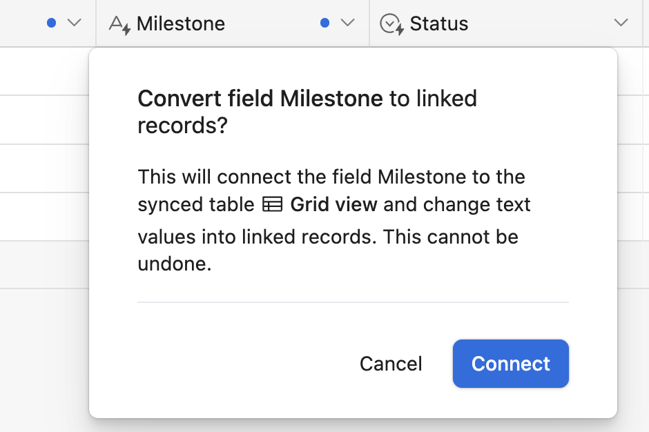

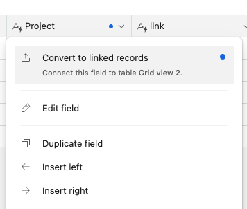

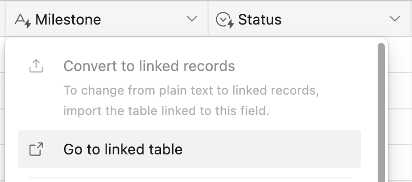

Don't use Customize field type to turn a synced field into a linked record field. The field is still part of the sync, so every refresh rewrites its values from the source and removes the links. If an automation re-creates the links after each refresh, the 2 processes overwrite each other on every sync interval, churning the records and everything downstream of them—lookups, rollups, and any interface whose permissions depend on those links. To link synced records to another table, see "Syncing linked records" section below.
Linking synced records to another table
To link the records in a synced table to another table, do one of the following:
  • Sync the linked table into the destination base as well, then convert the synced field using the steps in the "Upconverting previously synced linked record fields" section below. Use this when the records you're linking to also come from the sync source.
  • Add a new linked record field to the synced table. Fields you add yourself aren't part of the sync, so a refresh leaves them alone. Use this when you're linking to a table that only exists in the destination base.
To move an existing workflow onto a new linked record field:
  1. Add a linked record field to the synced table and point it at the table you want to link to.
  2. Copy the synced column that holds the values you want to link on, then paste it into the new field to backfill the links. Values need to match the linked table's primary field exactly. For more about how matching works, see [Linking records in Airtable](/docs/linking-records-in-airtable).
  3. Open each automation that writes to the old field and repoint it at the new field.
  4. Update every lookup and rollup that reads the old field so that it sources from the new field instead.
  5. Hide or stop using the old field only after steps 3 and 4 are done.

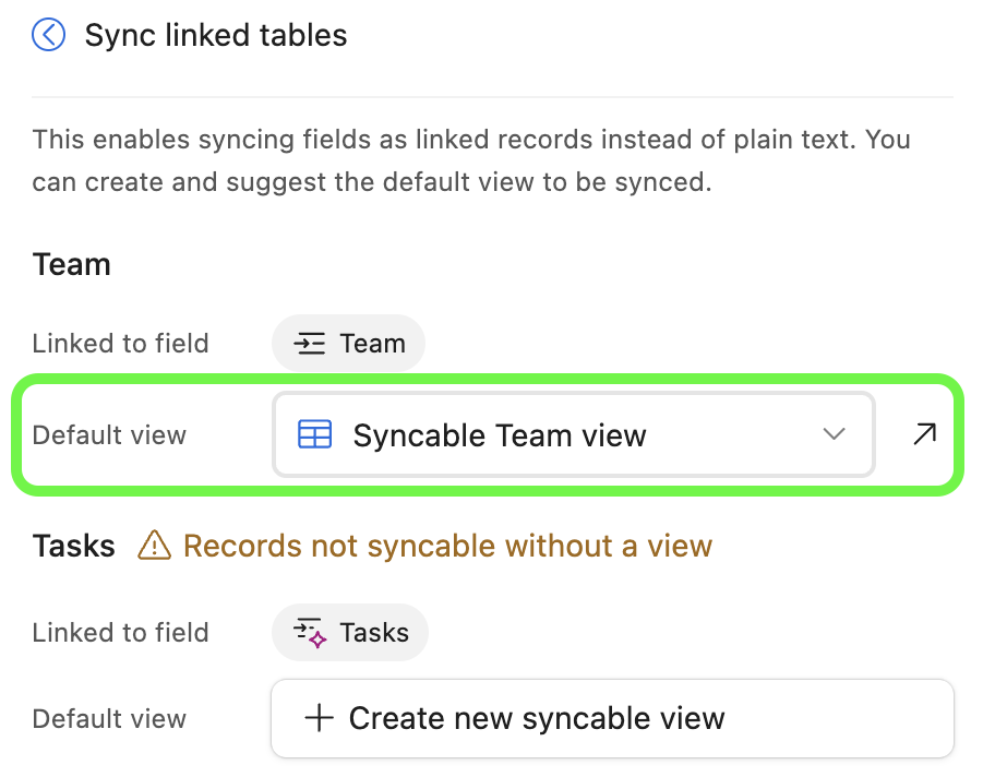

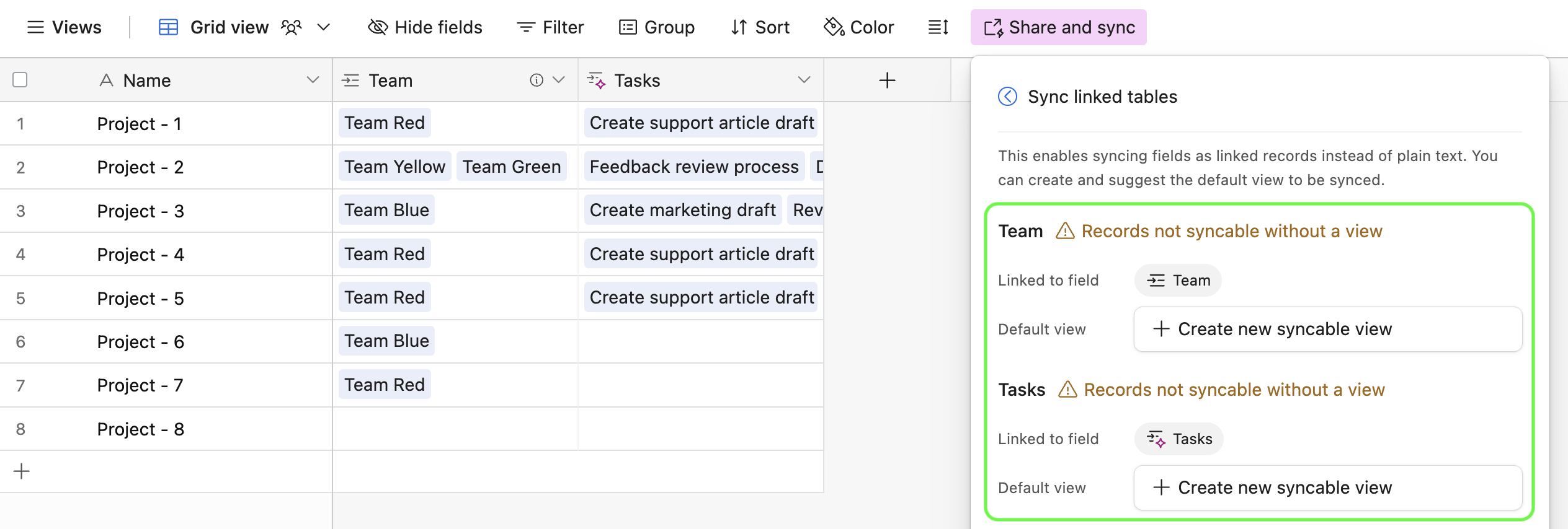

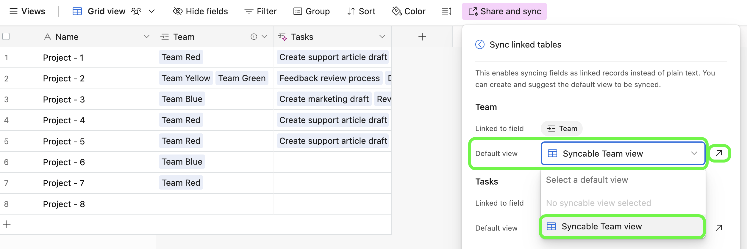

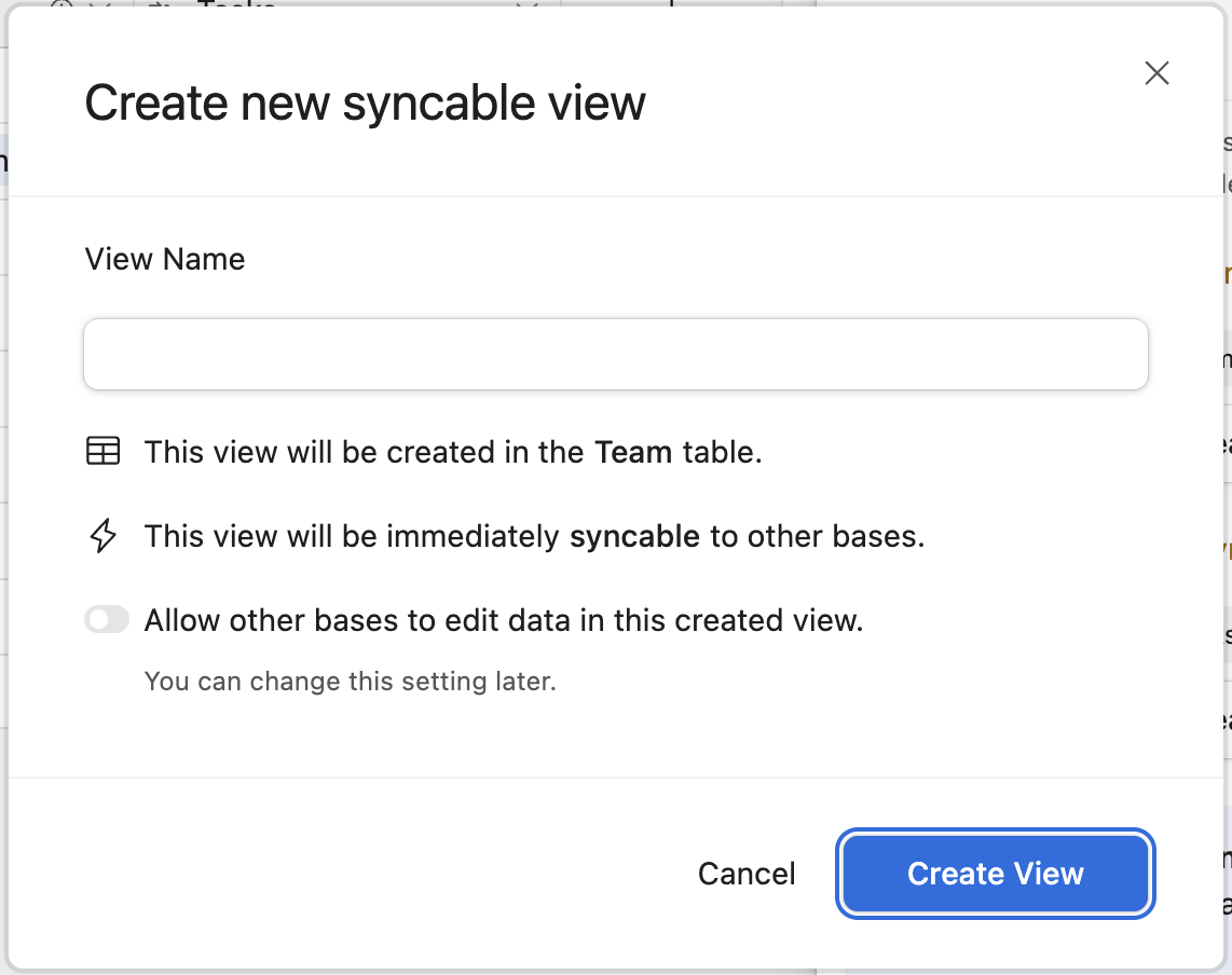

When this setting is enabled and a view is synced to other bases, one or more views in tables connected by a linked record field can also be synced. If there are any linked records or fields that you don't want synced to other bases, configure the field and view settings in these views first.
Enabling linked record syncing in a source base
  1. Navigate to the base where an existing sync source view has been configured or follow the steps covered here to create a new sync.
  2. Click on the Share and sync button.
  3. Click the Sync data to another base option.

    • Choosing a syncable view already configured - Use this option when you already know of a view that contains the settings appropriate to your use case for syncing.
      1. Next to the “Default view” section click the Select a default view drop down. If you are updating a previously configured source sync, then you might see the name of the current default view to click.
      2. Choose which syncable view you would like to set as the default view. The number of syncable views will be determined by how many have already been set up in the linked table that you are connecting with.
      3. Click the arrow symbol ↗ to open a new tab in your browser if you need to make any modifications to the syncable share view that you’ve selected.
    • Creating a new syncable view - Use this option when you need to create a new syncable share view in the other table.
      1. Click the + Create new syncable view option.
      2. A view creation window will appear. Give the new view a name and toggle on the option to “Allow other bases to edit data in this created view” in order to allow two-way syncing.
      3. Click Create view
      4. The sync configuration window should update the “Default view” section with the view you created.

Configuring linked record syncing in a destination base
When setting up syncs containing linked tables there will be an additional step to choose whether or not to include the additional tables required to allow for linked records to be preserved within the base where you are setting up the destination sync.
You will need Editor permissions or higher in the sync source base in order to see and configure the steps outlined below.
For those without editor+ permission on the source base, you could obtain additional shared view links from another collaborator who does have access to the additional linked data that you want to add. Once the additional synced tables are present in target, you can link them via the synced linked records upconversion flow outlined in the “Upconverting previously synced linked record fields” section below.
  1. Follow step 4 in the “Configuring a basic sync” section.
  2. When you reach the “Sync linked tables” window during the configuration process, all available linked tables will be chosen by default.
    • Feel free to adjust this by clicking the check icon next to each linked table that you do not want to include in the sync.
    • Remember that not choosing to include a linked table will result in linked record fields that appear as single link text rather than linked record field types.
    Once you’ve configured the sync-linked tables, click Next.
Prior to August 2024, linked record columns were synced as plain text. In order to use the newer synced linked records functionality, you will need to convert any of these older linked record fields. Converting these fields also involves syncing the additional tables necessary to use this feature.
To convert a linked record field:
  1. First, you’ll need follow the steps listed in the “Configuring a basic sync” section. The goal here is to sync in any extra source tables that contain linked record relationships not currently represented in the destination base. In some cases, you may be able to click the option Go to linked table in order to configure a new syncable shared view link.
  2. Once you’ve synced in the additional necessary source tables, navigate to the destination table where a linked record field needs to be converted.
  3. Click the dropdown next to the linked record field’s name.
  4. Select the option Convert to linked records. If the option is not clickable, then the necessary synced table is still not synced into the destination base.
  5. Finally, a confirmation modal with appear. Click Connect to finish the conversion process. Keep in mind that it may take a moment for Airtable to process the conversion on the backend before the linked records will appear in the synced linked record field.

How often do tables sync?
When you configure a table sync, you can choose to manually or automatically sync changes to your base.
  • Automatic syncing between Airtable bases occurs in real-time ¹
  • Automatic syncing between a sync integration and an Airtable base occurs as frequently as every 5 minutes, but may take longer at times.
  • Automatic syncs will eventually stop on bases that have not had any recent activity. To keep automatic syncs active, make sure that some kind of action (i.e. create a record, update a record, create a new view, etc.) is being performed in the base on a regular basis by automations, humans, or a combination of the two.
  • Automatic syncing is only available on paid Airtable plans.
¹ Time-based formula fields (and all dependent columns) will not be instant; instead, they will periodically update. Table syncs with Customized Linked Records will not be instant; instead, they will be updated periodically.

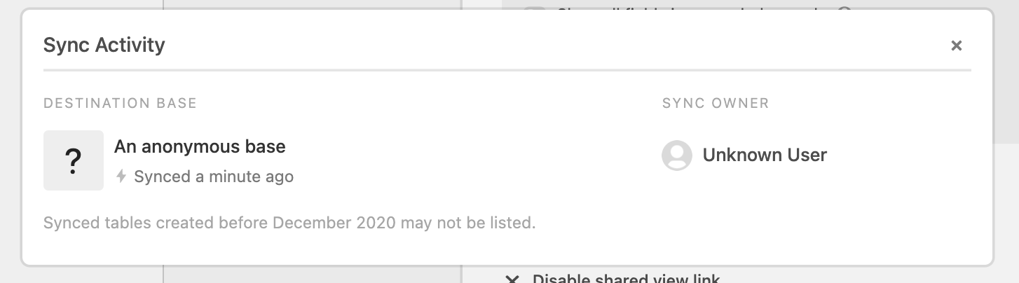

What does it mean when the destination base says "an anonymous base" or "Unknown User"?
In the Sync Activity log, if you have access to the destination base, you'll see the name of the base and the user who configured the sync. If instead, you see "an anonymous base" or "unknown user", this is due to one of the reasons below:
  • You do not have access to the base
  • The destination base has been deleted
If you're concerned about who might have access to the shared view link to set up a synced table, you can:
  • Regenerate your shared view link - When you do so, the sync will pause on all destination bases until it is re-authenticated. The users on the destination bases will see an error icon, along with the time the table last synced. To re-authenticate, they'll need the new syncable view share link. To use that link, click the dropdown next to the destination table, click Update sync configuration, and insert the new link.
  • Enable a password and/or email domain restrictions on the shared view link - If the view share link is restricted to example.com, an example.com Airtable account will be required to sync that view to any base. You can learn more about sync permissions here. Note that these restrictions can break existing syncs or published data sets that depend upon this shared view link.

How can I turn off a sync?
There are several options to consider when turning off a sync:
  • Turning off a sync from the source view - In some instances, you may want to disable a sync source. Keep in mind that this will break any connection to existing sync destinations, so they will be unable to continue to sync the data moving forward.
    • To disable a source view navigate to the base → table → view where you want to stop allowing syncs. Click the Share and sync button. Then, click the Sync data to another base option. Next, toggle off the “Allow data in this view to be synced to other bases” option.
  • Turning off a sync from a destination table - In other instances, you may want to disable a sync in a destination table. This is a good option to use when you want to “freeze” the data according to it’s most recent sync. The table will remain and the sync could be re-established in the future if needed. Keep in mind that you could also change the sync frequency to be “Only sync changes when requested” if you currently are automatically syncing the data.
    • To disable a destination sync, navigate to the base → destination table. Click the dropdown next to the name of the table. Click the Update sync configuration option. Next, you can either:
      • Change the sync interval to be unsynced by clicking the Change button under the “Settings” section next to the current interval setting. Then, choose the “Stop syncing changes and convert to unsynced table” option on the next page. A confirmation modal will appear where you will need to click Remove to break the sync.
        • Once you convert it to be unsynced, the table becomes a regular, fully editable table. All of the synced data stays in place, and the fields that were read-only while syncing are now editable.
      • Remove an individual source, which can be helpful in multi-source syncs. To accomplish this, click the … icon next to the source you want to remove. Then, click Remove source.
  • Deleting a source or destination table - This option should be used with caution, but there are time when you may need to delete a source or destination table. Keep in mind that deleting sync source tables can affect the data in downstream destination syncs depending on the destination sync’s settings. Reference this article if you want to learn more about deleting a table.

To remove a sync from a destination table:
  1. Open the destination base and click the dropdown arrow next to the synced table's name.
  2. Click Update sync configuration.
  3. Under the "Settings" section, click Change next to the current sync interval.
  4. Click Stop syncing changes and convert to unsynced table, then confirm by clicking Remove.

How do I update the primary field in my synced (destination) table after changing the primary field in my source table?
The primary field of a synced destination table is set when the sync is first created and can't be reassigned afterward — so designating a different field as the primary in your source won't change the destination's primary field on an existing sync. You have two paths:
  • Recreate the sync with the primary field you want. Create a new synced table from the same source, and on the "Select fields to sync" step expand the Advanced section to choose which field acts as the primary field, then click Create table. Once the new synced table is working, delete the old one (it isn't removed automatically). Note: rebuilding the sync means any lookups, rollups, links, or automations pointing at the old synced table will need to be repointed to the new one.
  • Edit the original source primary field instead of promoting a new field. If your goal is to change the content/type of the primary value (e.g., make the existing primary field a formula that includes more detail), modifying the existing source primary field flows through to the destination — whereas making a separate field the primary in the source does not.
You can choose your primary field during sync configuration, on the "Select fields to sync" step, expand the Advanced section to choose a specific field to act as the destination table's primary field; by default it matches the source table's primary field. Primary fields must contain unique values and be a supported field type. Because this choice is only available at creation, decide on the primary field before creating the sync; to change it later you'll need to recreate the synced table as described above. (If you don't see the Advanced option, note its availability can depend on your plan.)
