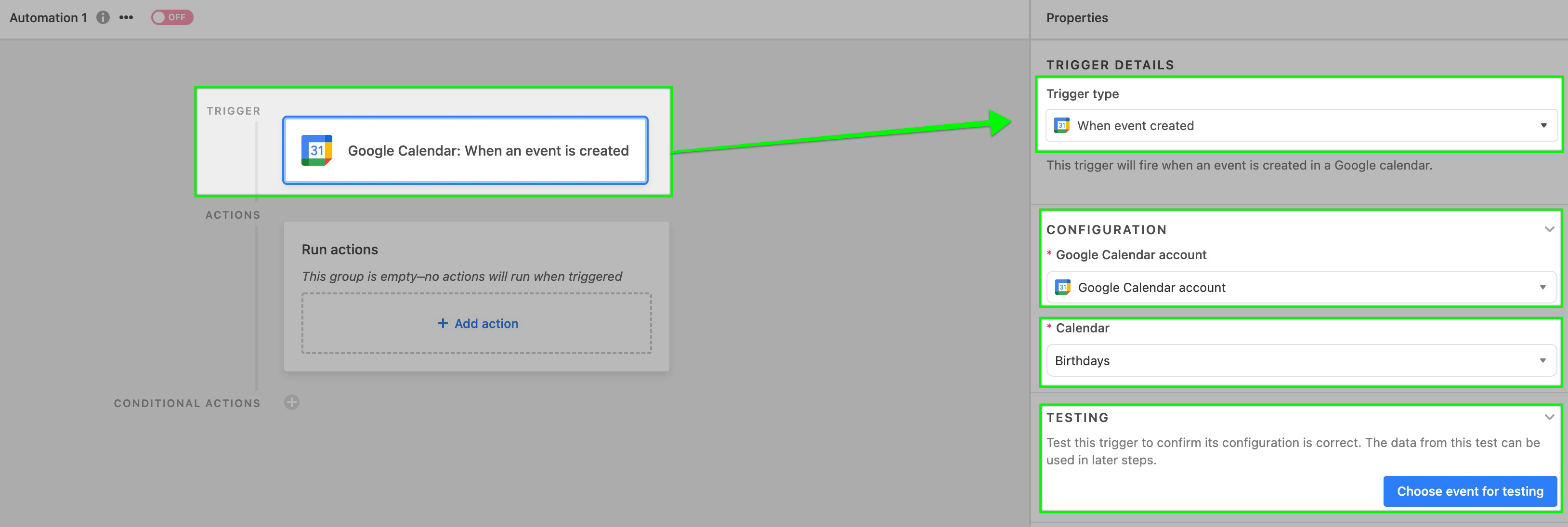

Google Calendar triggers
All Google Calendar triggers will return a Google Calendar Event ID. A Google Calendar event's ID is a unique identifier returned from Google Calendar for that event. If you intend to update a Google Calendar event at any point, we recommend storing the Google Calendar Event ID on your table. Note, that this ID is different from an Airtable Record ID, which is a unique identifier for an Airtable record.

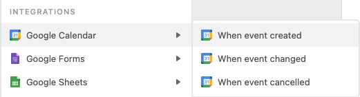

There are currently three Google Calendar triggers to consider using in Automations:
  • When event created
  • When event changed
  • When event cancelled
To track all changes in a Calendar, you'll likely need to set up 3 different automations, one for each Google Calendar trigger listed above.
Each of the Google Calendar triggers requires the same general setup process. You'll need to:
  • Pick which trigger you want to use
  • Connect your Google account (or select an already connected account)
  • Select a calendar that will trigger this automation
  • Pick an event and Run a test to make sure the connection is configured correctly (at least one event will need to be present in the calendar you selected to be able to test)
After successfully testing a Google Calendar trigger, you are ready to move on to some action steps. Consult below for more information about each trigger type.

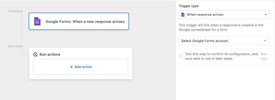

Google Forms trigger
For Google Forms, we currently provide one Automation trigger option. Select the “When a response arrives” trigger from the list of available triggers. Then follow these setup steps to connect to the right Google account.
You need to use the “Select response destination” setting in your Google Form and designate a spreadsheet to use to collect response information. For help on this, please visit this support article from Google for more details.

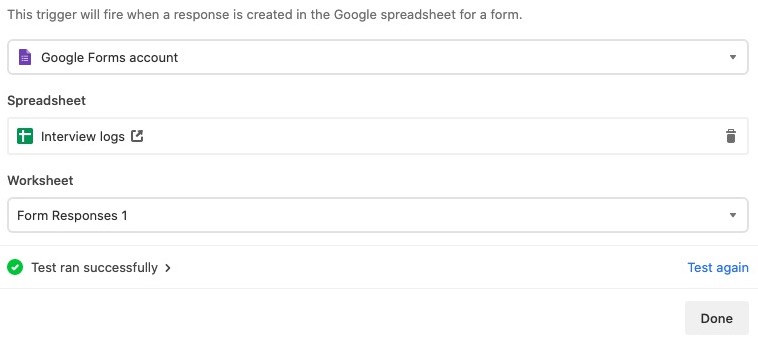

Next, connect to your Google Forms account, and select the spreadsheet and worksheet where your form responses are populating.
Then, run a test to make sure the connection is configured correctly (at least one form response will need to be already submitted to test the connection).
The trigger will only detect rows that are added to the bottom of the spreadsheet. For example, if 3 rows were deleted from the spreadsheet and 3 more were added to replace them, then we wouldn't detect the 3 new rows. However, we would detect an additional 4th row or any subsequent submissions (rows) after that.

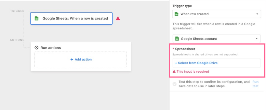

Google Sheets trigger
The same row trigger rules apply as outlined in the note at the end of the section on the Google Forms trigger listed just above ^.
There is currently one Google Sheets trigger to choose when setting up an automation. Select the “When row created” trigger from the list of available triggers. Then follow these setup steps to connect to the right Google Sheet:
  • Select a spreadsheet Select a worksheet (the worksheet must have column headers)
  • Run a test to make sure the connection is configured correctly
The trigger on this automation is designed to run quickly after a new row has been created in a Google Sheet. If the row hasn't been entirely filled out at the time the automation triggers/runs, it may miss important information and not pull it into your Airtable table. This explains why you're able to retroactively test records successfully and pull them from Google into Airtable, yet the automation is unable to capture all of the information contained in a Google Sheet's row in live automation runs.
