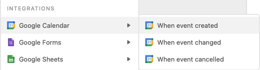

There are currently three Google Calendar triggers to consider using in Automations:
  • When event created
  • When event changed
  • When event cancelled
To track all changes in a Calendar, you'll likely need to set up 3 different automations, one for each Google Calendar trigger listed above.

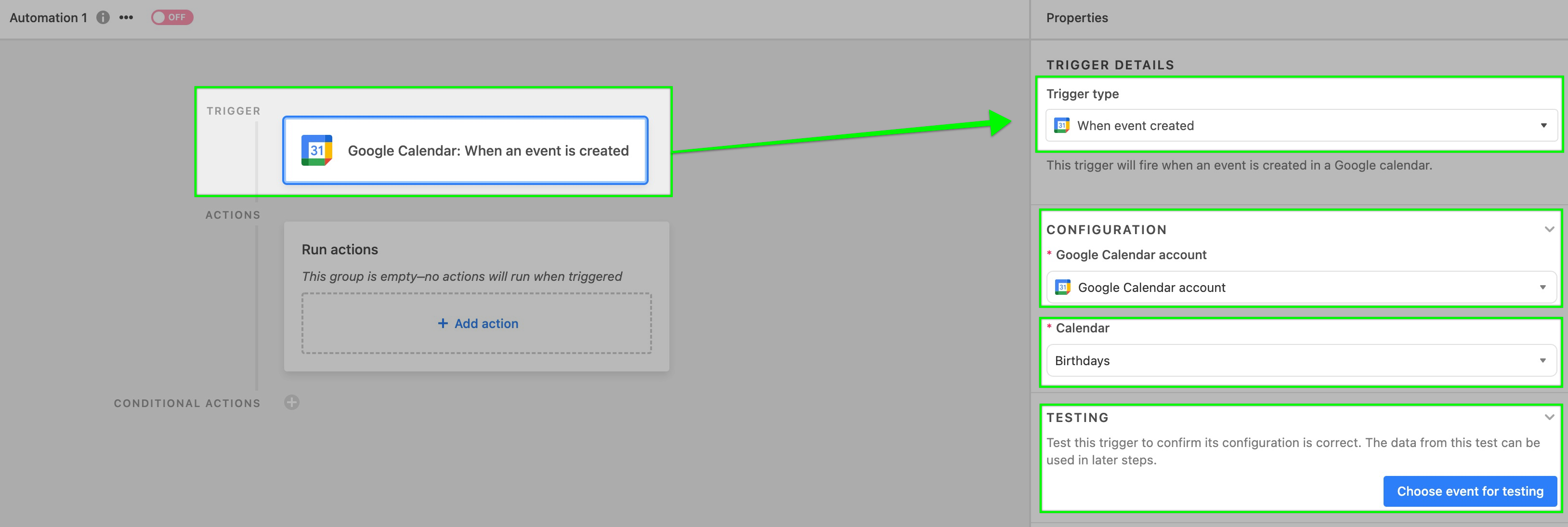

Each of the Google Calendar triggers requires the same general setup process. You'll need to:
  • Pick which trigger you want to use
  • Connect your Google account (or select an already connected account)
  • Select a calendar that will trigger this automation
  • Pick an event and Run a test to make sure the connection is configured correctly (at least one event will need to be present in the calendar you selected to be able to test)
After successfully testing a Google Calendar trigger, you are ready to move on to some action steps. Consult below for more information about each trigger type.
