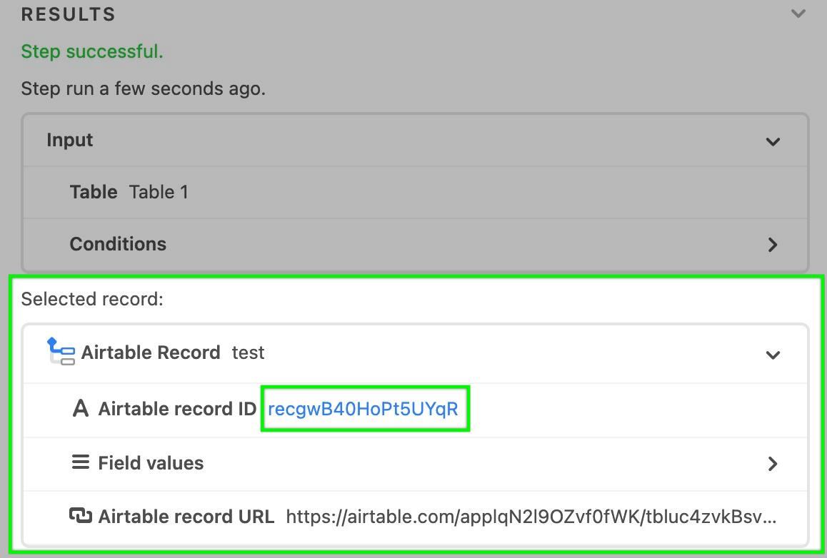

Manually determining a test record
Determining a test record can be extremely helpful in troubleshooting automations. When a trigger has tested successfully a dropdown menu will appear to view more details about the test record used.
You can click on the blue hyperlink next to "Airtable record ID" to open the record within the Automations window as an expanded record. This will allow you to adjust the record in a way that may help to fix errors in your automation.

How is the test record chosen when testing an action step?
  • Find Records: All matched records
  • When a record matches condition: First matching record
  • When a record is created: First record in the table/view
  • When a record is updated: First record in the table/view
  • When a record enters view: First record in the table/view
  • Google sheets row created: Last row in the sheet
  • New response Google Form trigger: Last response/row in the sheet the response is sent to
