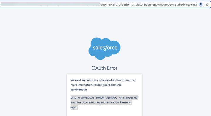

How will I know if I'm affected by the update?
Whether setting up a sync integration or using an integrated automation trigger or action, you'll need to allow the external service to connect and integrate with Airtable. Airtable uses OAuth to connect to Salesforce. If you run into an error when trying to connect your account, you will need to request help from your Salesforce admin.
The example screenshot below shows an error a new user trying to connect to Salesforce may encounter:

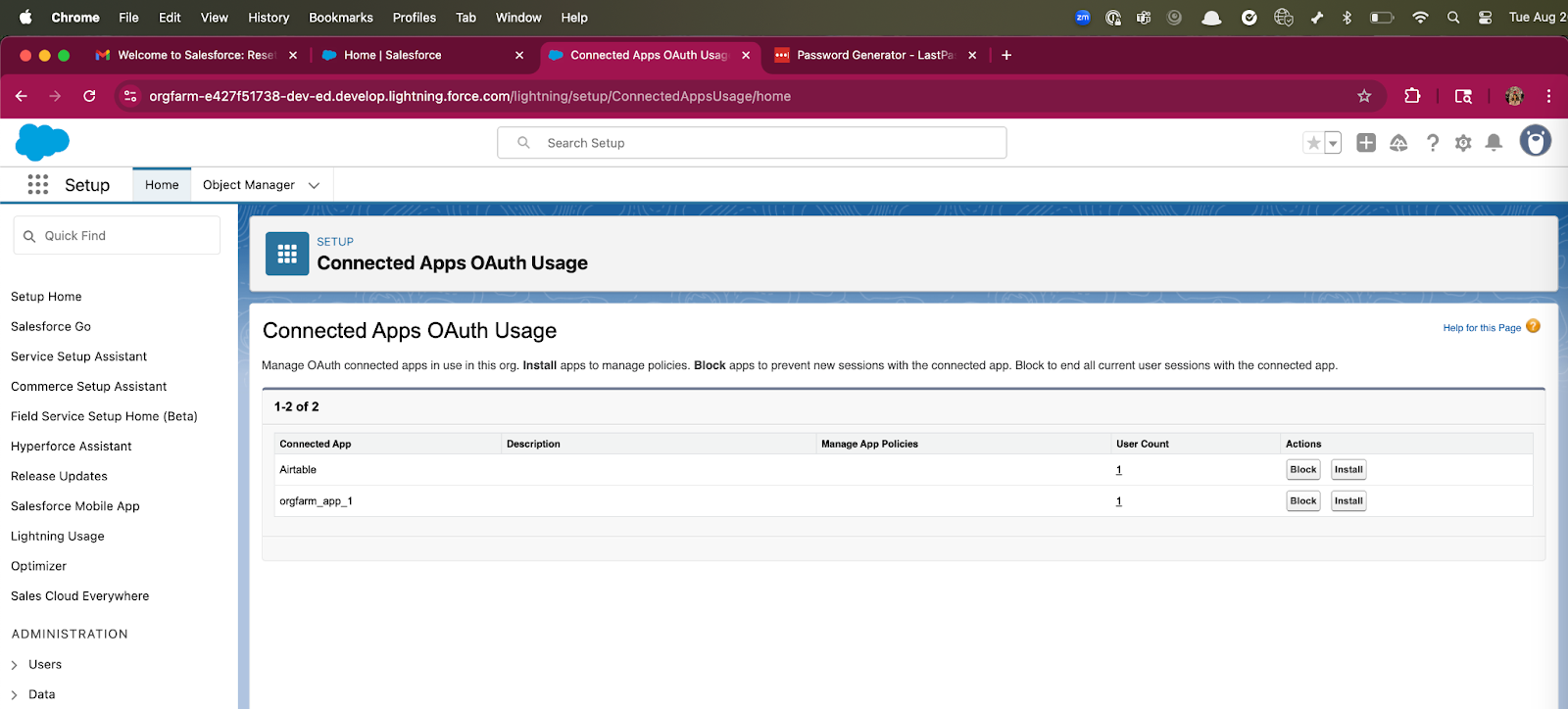

  1. Navigate to Connected Apps OAuth Usage.
    1. Log into Salesforce.
    2. Click the Setup gear icon in top-right corner.
    3. In “Quick Find box,” search for "Connected Apps OAuth Usage."
    4. Click Connected Apps OAuth Usage.
  2. Locate Airtable.
    1. Search for "Airtable" in the list of applications.
      1. You should see the "Install" button next to “Airtable.”
  3. Install Airtable.
    1. Click Install.
    2. Review the installation page.
    3. Click Install again to confirm.

Reconnecting Salesforce fails with "Could not authorize the account." How do I fix it?
The "Could not authorize the account" is a Salesforce error that means Salesforce is blocking the Airtable OAuth/Connected App from being authorized, usually due to an org-level “Connected App” policy. First confirm it's not Airtable-side by reconnecting the account from Integrations → Connected accounts (and, if that fails, removing and adding the account as new). If the error persists, it needs a Salesforce administrator to adjust one of the following:
Connected App "Permitted Users" policy: In Salesforce, go to Setup → Connected Apps → Manage Connected Apps, open the Airtable Connected App, click Edit Policies, and under "Permitted Users" set "All users may self-authorize."
Pre-approve specific users: If your org requires "Admin-approved users are pre-authorized," the admin grants access to the relevant users via profiles or permission sets instead.
