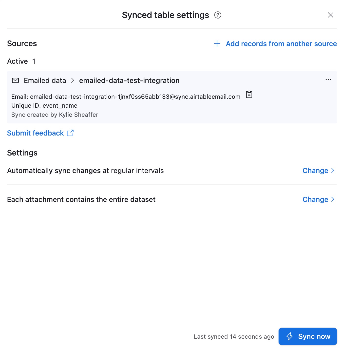

Can broken emailed data sync integrations be transferred to a new Owner after the original Owner leaves an organization or company?
No. While there isn't a way to transfer emailed data sync integrations after the Owner leaves an organization or company, we recommend the following options:
  2. Open the base containing the emailed data sync integration.
  3. Click the arrow icon to the right of the table’s name, storing your emailed data sync integration.
  4. Click Update sync configuration.
    1. The email associated with your emailed data sync integration is the long email address to the right of the “Email:” section.
  1. Click the clipboard icon to copy that email address.
  2. Add that email address to table description so it can be accessed publicly by your team’s collaborators.
    • As long as collaborators have that sync inbox email address, they can continue to send data into the synced table.
  • If this isn't possible, we recommend that a collaborator take over this sync. In the synced table, if a new sync owner selects Sync configuration settings and clicks Add records from another source, they can add a secondary Emailed Data sync integration on top of the table.
  • Alternatively, they can email a CSV to the new inbox with a dataset identical to what's currently in the table. The system can create new records for this new sync source in the table, and the team can easily copy and paste any values from manually added fields (like linked record fields) from the old synced records to the new synced records. From there, the user can remove the original Emailed data sync source from the table's settings, deleting those original, extra synced records.
