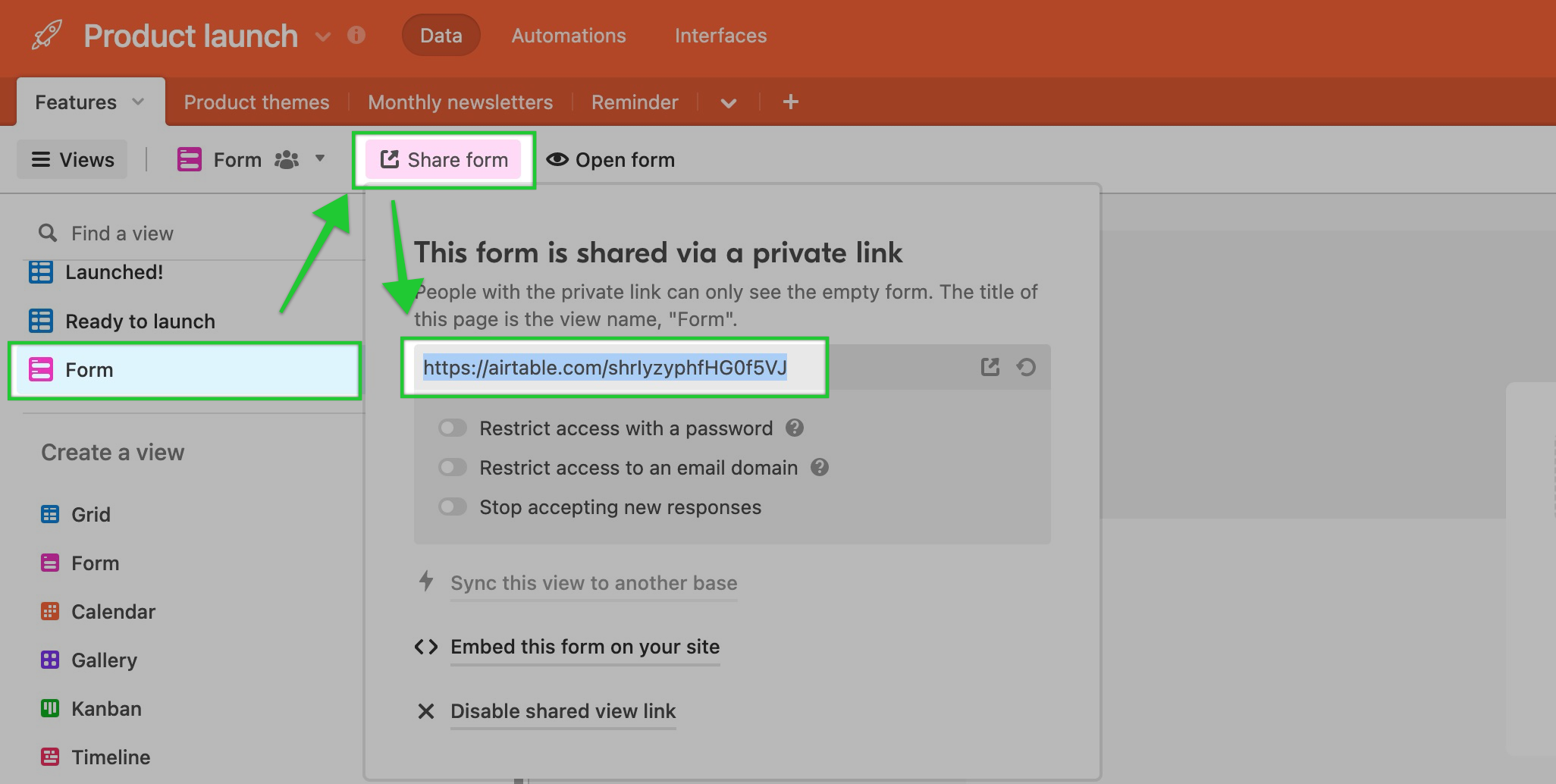

Copy your form URL
Find the URL for the form you wish to prefill and copy the URL to your clipboard.

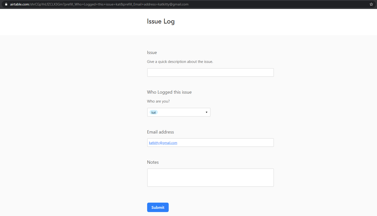

  1. Start by adding a ? to the end of the URL.
    Image 2020-09-18 at 1.03.33 PM
  2. Then, type prefill_ and the name of the field you wish to prefill. The part after prefill_ must exactly match the field name as it appears in the table. Additionally, the field label/name in the form or the field ID can also be used to identify the correct field to prefill. Note that spaces in the name of a field will need to be encoded as %20 or to the plus sign +.
    Image 2020-09-18 at 1.08.24 PM
  3. Finally, you'll insert an = (equals sign) and then type the value that you would like the field to be prefilled with. Similar to the last step, you'll need to use the proper encoded values for spaces and symbols. Other considerations are dependent upon the field type of the field being prefilled which are covered in the sections below.

Image 2020-09-18 at 1.12.30 PM

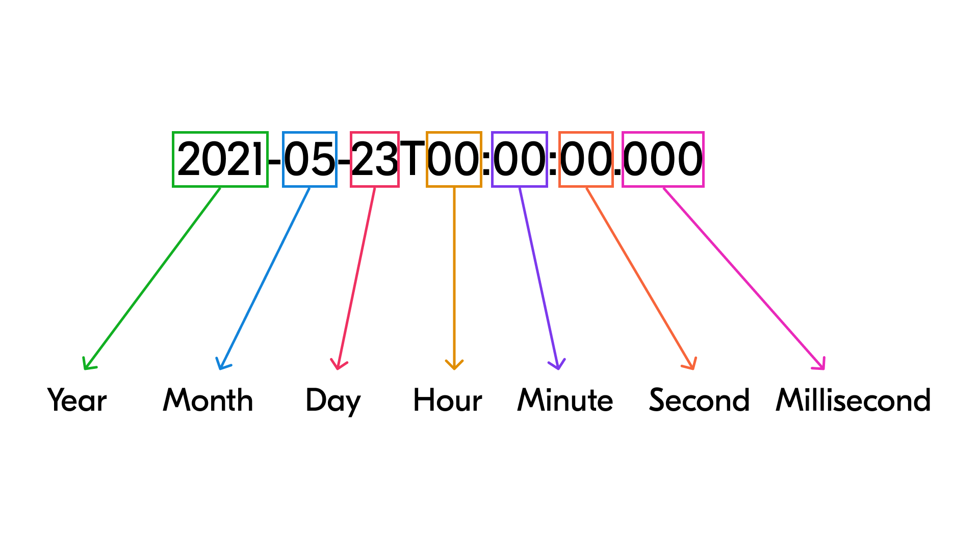

Prefilling time
It's important to note that when prefilling time fields in a form you will need to use the ISO 8601 time format. Below is a breakdown of what each number in that format means:
Time Breakdown
Here's an example of what a URL would look like for prefilling time into a form. Notice that the number 10 has been added to the hour section of the ISO 8601 format. This means that the form will be prefilled to 10 am.
Image 2021-05-26 at 9.07.48 AM

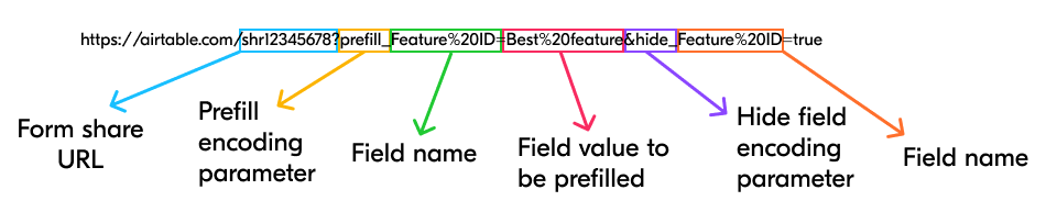

Hiding a prefilled field from the submitter’s view
Sometimes, you might prefill a field for a submitter that you do not want them to edit, such as an internal feature ID for a product feedback form or a support ticket number for a support survey.
You can hide a form field from a submitter by using the hide_FieldNameOrTitle=trueencoded URL parameter. Similar to prefill_FieldNameOrTitle=value, the string FieldNameOrTitle should be properly encoded. For example, if your form field “Feature ID” should be prefilled with “Best feature” and hidden, your URL would look like this:
https://airtable.com/shr12345678?prefill_Feature%20ID=Best%20feature&hide_Feature%20ID=true
Let's break that formula down one more time:
Prefill URL formula

The URL that you have created will prefill a form for you when accessing it.
Image 2020-09-18 at 1.16.10 PM

Step 3: Copy the form's URL
Navigate to the form view, click "Share form," and copy the URL.

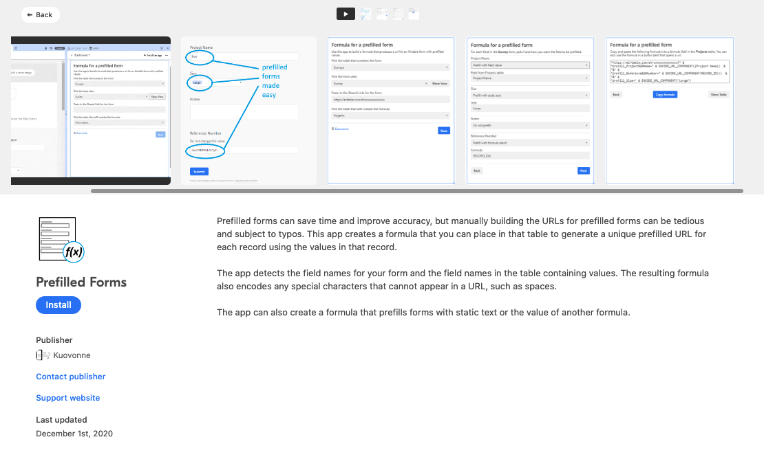

Using an extension to create a prefilled form URL
One of our community extensions streamlines creating prefilled URLs.
prefill_app
