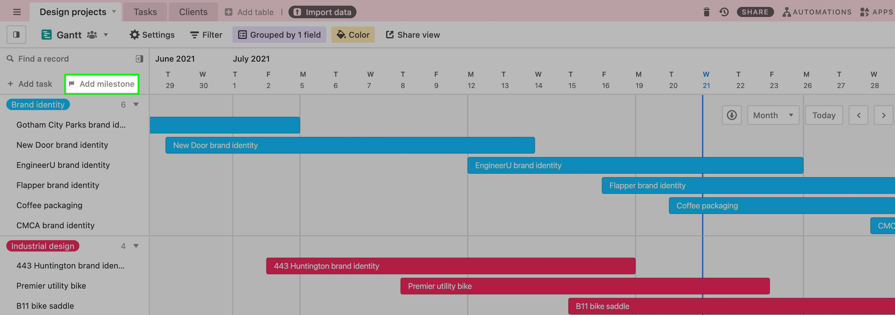

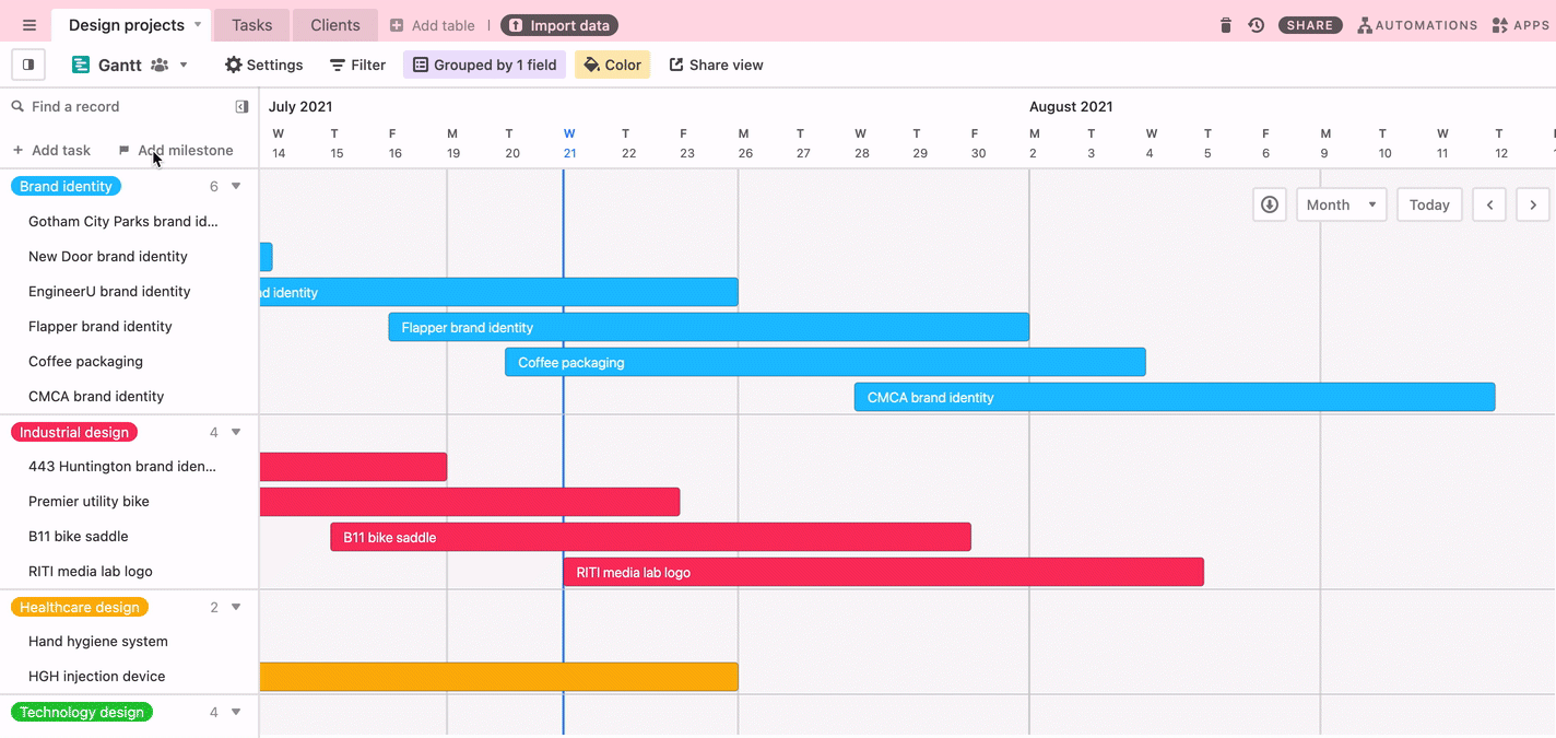

Milestones can be created just like any other record in an Airtable view, but you can also use the “Add milestone” button in the left-hand sidebar of the Gantt chart.
milestoneGantt (1)
This will automatically create a record with no start date and an end date based on the chart’s current scroll position.
creatingMilestoneGantt

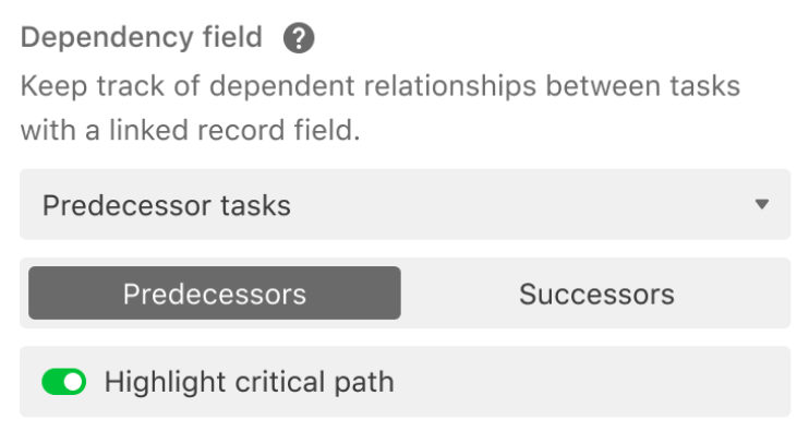

Setting the dependency relationship
Let's circle back to the Gantt view settings. There you'll find the option to decide if the type of relationship you've configured for your self-linking record is a predecessor or a successor.
dependency_field
After making the selection - and if your self-linking record field already has record links in it - your Gantt chart will automatically populate with dependency arrows.
If your self-linking record field doesn't already have record links in it, you won't see any dependency arrows yet, even after selecting a dependency field. However, as long as you have a dependency field set, you can create your own dependency arrows in the view.

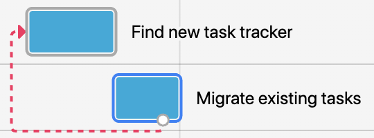

Invalid dependencies
If a dependency appears with a red line, that means the dependency is invalid: either a dependent record is scheduled to start prior to one of its precedent tasks, or the records are in a dependency loop.

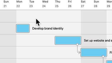

Creating dependencies directly in the Gantt chart
If you've selected a self-linking linked record field to serve as a dependency field for your Gantt view, you can make dependencies directly within the Gantt chart interface. When you move your mouse over a record, a white circle will appear. Click and drag this white circle to another record to create a dependency arrow.
create_dependency
As you create dependency arrows, links will be created in whichever field you designated as your dependency field.

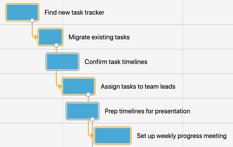

Highlighting critical paths in Gantt views
When tasks are dependent on each other, delays to individual tasks can end up directly affecting the completion date of an entire project. A chain of dependent tasks that can influence the finishing date of the overall project is called the critical path. The Gantt view will highlight the critical path based on the earliest and latest records from your dependencies—below is a quick example demonstrating this behavior (outlined in gold)
critical_path
Delays to earlier tasks (i.e. 'Migrate existing tasks' above) that affect the sequential timing of the final task(i.e. 'Set up weekly progress meeting' above) are considered critical to remaining on schedule.
Tasks that do not have a dependency link to the final task will be omitted from the critical path (i.e. 'Confirm task timelines' in the above example).
If you have a dependency field selected in your Gantt view settings, you can highlight the records and dependency arrows on the critical path by toggling the Highlight critical path button. This will automatically display the critical path for any applicable records.
