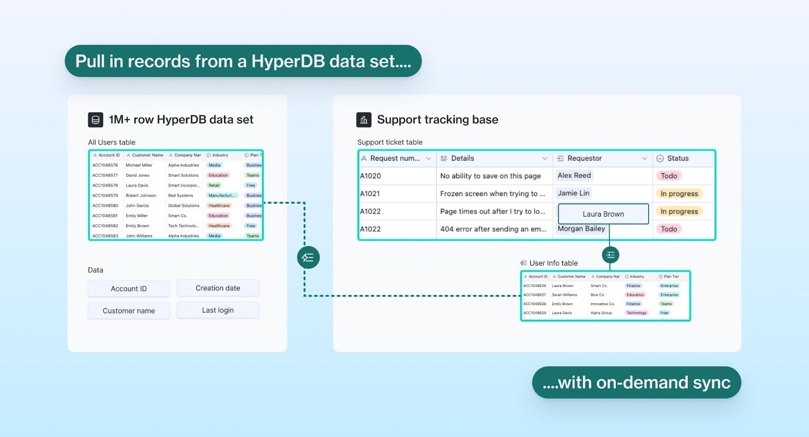

On-demand sync allows you to link records as needed to a massive data set powered by HyperDB—giving you the ability to search millions of records without impacting performance.
On-demand syncs each record to your table as it is linked instead of the typical sync method, which brings in all records from a synced data set.
  1. To get started, you need an existing table that you want to link to this massive data set. For example, in the diagram below, Zelos Inc. has an existing "Support tickets" table and wants to link the field "Requestor” to the HyperDB-backed data set "All users."
  2. The user adds the "All users" data set as a new table, "Requestor," by choosing this data set from the data library. During setup, they bring data with on-demand sync, linking it to the table and field "Support tickets" and "Requestor," respectively.
Once the existing table is connected to the synced on-demand table, you can search for any record with the linked record picker. Only linked records will sync into the new table. In the example, support tickets can be assigned to any user in the "All users" dataset. The on-demand synced "Requestor" table only displays the subset of users that have been actively linked to tickets.
