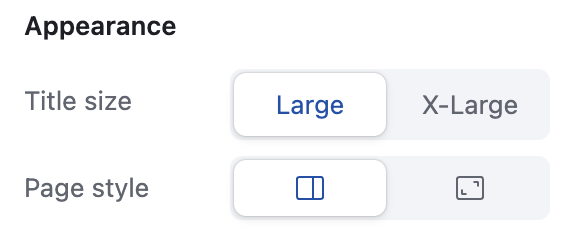

Appearance (Sidesheet or full-screen)
A module showing the appearance configuration settings in record detail pages.
  • Title size - Choose between a large or extra large title on the record detail page.
  • Page style - Record detail pages display as a sidesheet by default, but this can be changed at any time, with no loss or change to the contents of the record detail layout. You can toggle between these options in the sidebar when viewing a record detail layout in edit mode.
    • Sidesheet - This option shows the record detail layout in a drawer that slides out from the side of the page on top of the original page, keeping the original page in view.
      • You can resize the sidesheet by hovering over the left edge of a sidesheet until you see the ↔ icon appear. Click and drag the edge of the sidesheet to your preference. Custom sizing is saved to your browser on a per-page basis, and other users using the same interface will be able to set their own custom sizing.
      • Choose the sidesheet option when:
        • You expect collaborators to browse multiple records in the same workflow - A sidesheet includes buttons for moving to the next or previous record.
        • You expect collaborators to interact with the initial list of records after the record detail page has been opened (e.g. to select a different record or apply different filters).
        • You want collaborators to keep the original list of records visible for greater context.
        • You expect collaborators to only comment on the record rarely, or in specific situations.
    • Full-screen - This will open the record detail layout on a new page that takes up the entire screen. Choose the full-screen option when:
      • You expect collaborators to focus deeply on one record at a time and not browse multiple records at once as part of their workflow.
      • You expect collaborators to spend more time working with a single record.
      • You want to display a large number of fields for that record and need more visual space.
      • You expect collaborators to comment on records often.

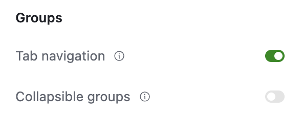

Groups
  • Tab navigation - Enabling tab navigation allows end users to click tabs to navigate through grouped sections of details on the record detail page. This is particularly useful in detail-rich pages containing many fields of data.
  • Collapsible groups - Enabling collapsible groups in a record detail page will allow end users to expand or collapse groups of fields.

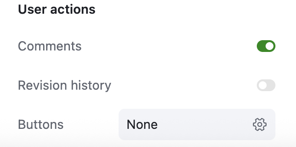

User actions
A module showing configuration options under the user actions portion of record detail page's settings.
  • Comments - Give end users the opportunity to comment on records when they have opened a record detail page. For more information on commenting in Airtable, see Commenting on records and @mentioning collaborators.
  • Revision history - Show end users revision history for the particular record that they have open. Note that:
    • With revision history, users will be able to see any changes that were previously made to fields that are visible in record details, as well as any changes moving forward. These changes may include:
      • Interface edits
      • Extensions
      • Automations
      • External applications (ex: OAuth)
  • Buttons - Add one or more buttons to the record detail page that end-users can click to perform a multitude of actions. For a more in-depth understanding of buttons consult this documentation.

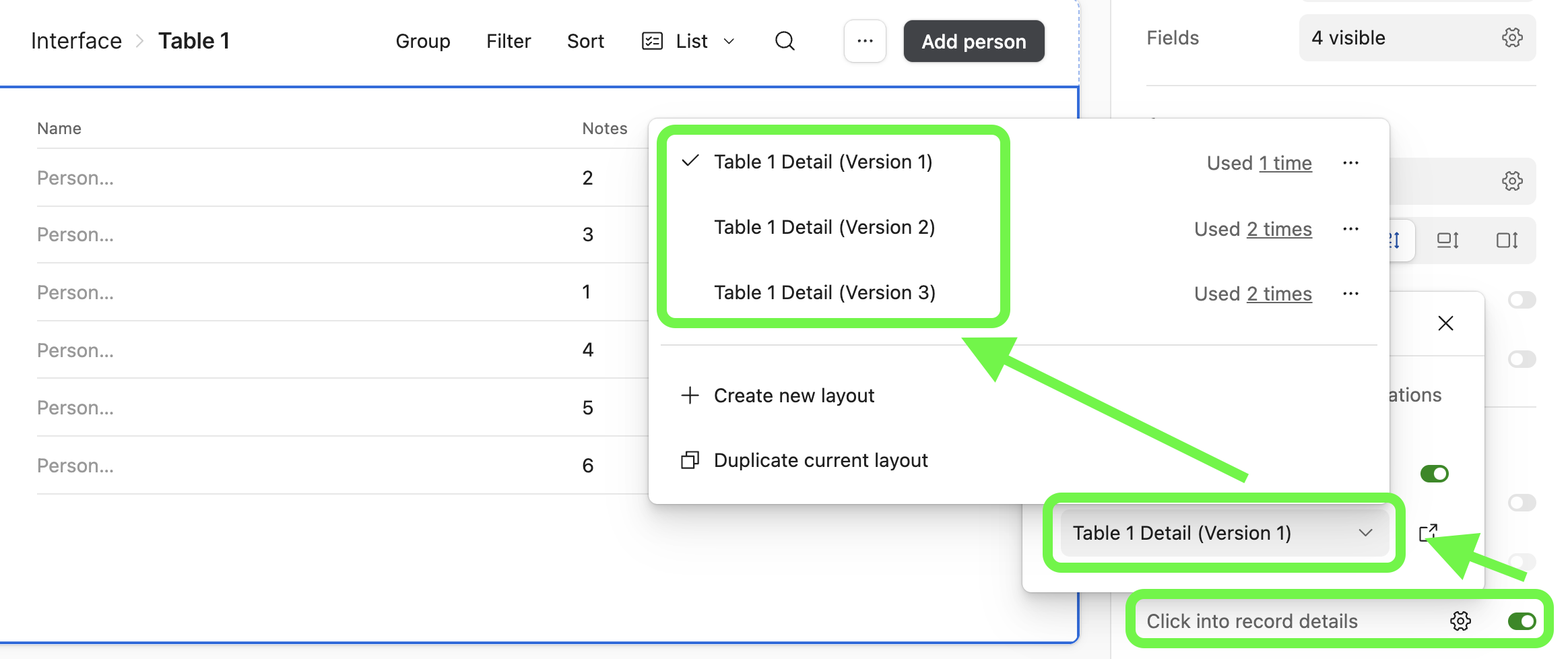

Reusing record detail layouts
You can also reuse previously configured record detail layouts to provide consistency in record detail page experience across the various interface pages that make up the interface you are building or modifying. A few notes about reusing record detail pages:
  • A record detail layout can be reused on other pages, even those pages that are part of another interface from the same base, as long as the page matches the same associated source table from the underlying base.
  • A record detail page cannot be reused in other interfaces that are part of a different base.
  • When you enable collaborators to click into record details from a new page, if a record detail layout has already been created for the table that contains the type of records shown on that page, it will automatically be reused.
  • You can see the different pages where a record detail layout is used in the sidebar when viewing that record detail layout in edit mode.
To reuse a record detail layout:
  1. Open up the interface page that you want to configure in edit mode.
  2. Click on the canvas where records are shown as a table visualization. This will open the specific properties panel options for that set of records.
  3. Click on the cogwheel icon in the “User actions” section next to the “Click into record details” option.
  4. Click on the ⌄ icon. Choose the record detail layout that you want to reuse. You’ll see how many times a certain record detail layout has been “used” across the interface that you are updating. You can always go back to the page-level properties and adjust which record detail layout to use when an end user clicks the **Open >** button record.
  5. Don’t forget to click **Publish** when you have completed updating the interface.

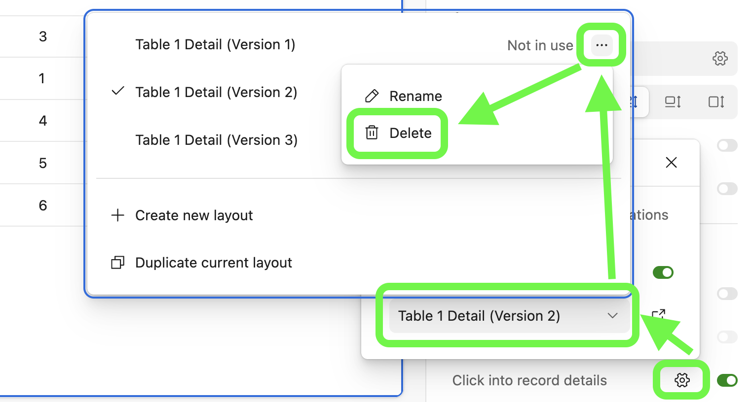

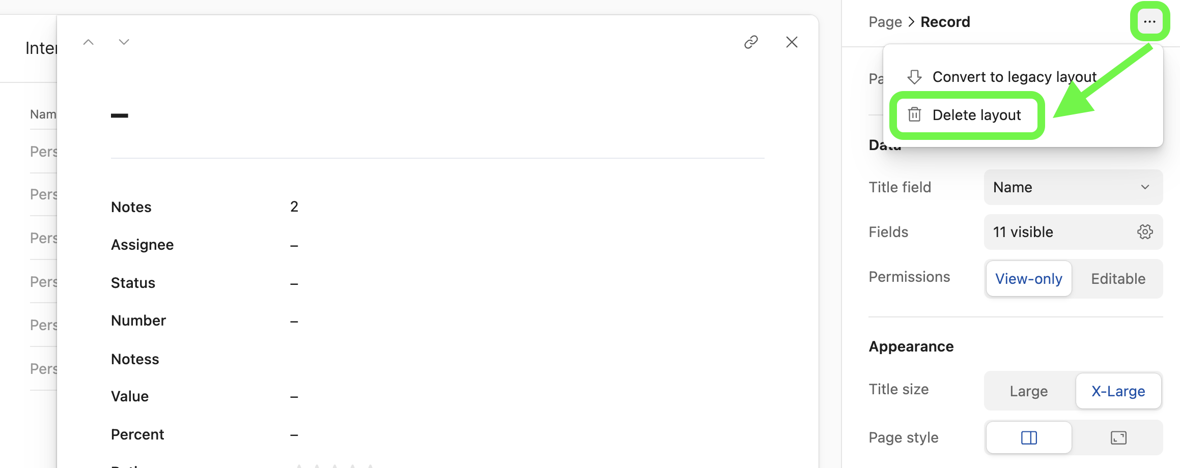

Deleting record detail layouts
Keep in mind that deleting a record detail layout will delete that layout in any other locations where the layout has been reused as well. There are two places in edit mode where you can delete a record detail page:
  1. Record detail layout level - Navigate to the record detail page that you want to delete and click the … button at the top of the configuration panel on the right side of the page. Then, click Delete layout. A confirmation message will appear, click Delete again.
  2. Page visualization menu level - Click on the canvas of a page visualization where the “Click into record details” option has been enabled and click on the cogwheel icon. Next, click on the ⌄ icon. Finally, click the … icon next to the record detail layout that you want to delete and click Delete. A confirmation message will appear, click Delete again.

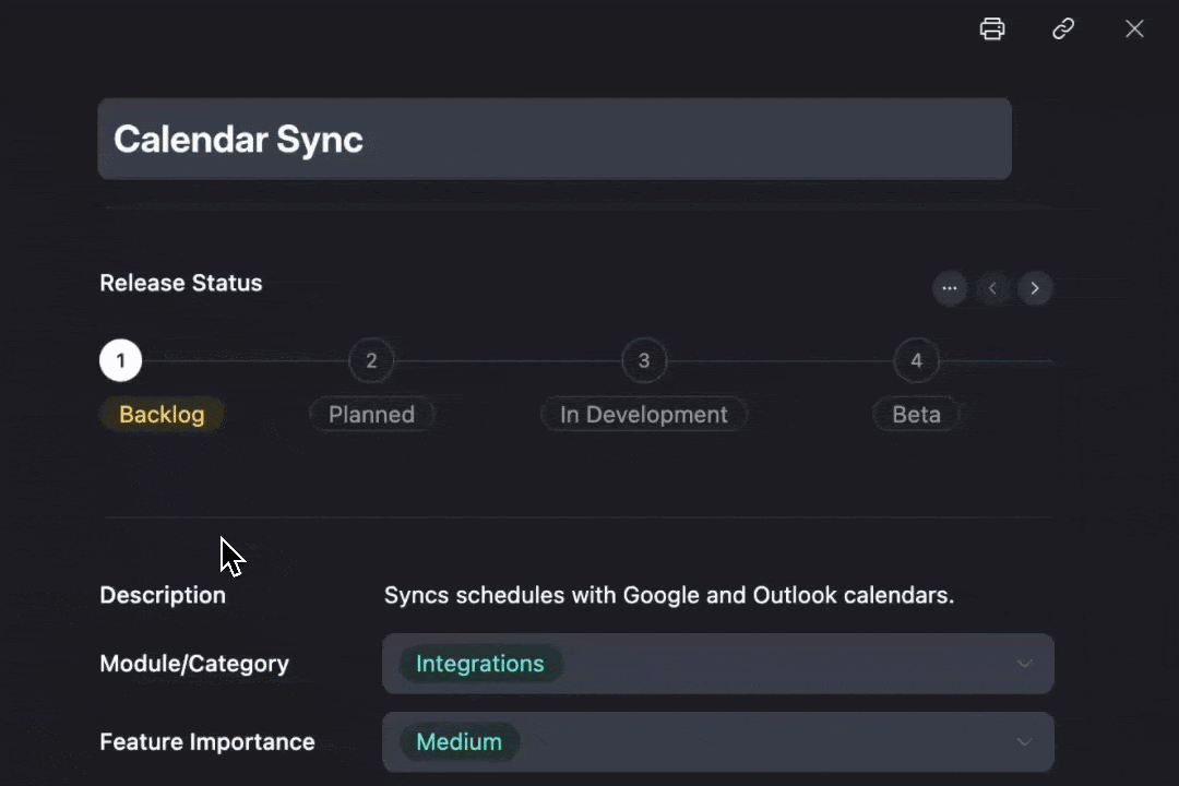

Showing workflow stages in record detail layouts
“List” and “Stepper” appearance styles are available for any single select field shown in a record detail interface layout. Choosing the “Stepper” appearance option allows end-users to better visualize the current state of the record they are interacting with when they open the record detail page. Some common use case examples for this feature are:
  • Approval stages
  • Project status
  • Publication milestones
  • Review steps
A GIF showing
To enable the “Stepper” visual for a single-select field on a record detail page:
  1. Open a record detail page in the interface of your choice.
  2. Click on a single select field to open its configuration options.
  3. Navigate to the “Appearance” section.
  4. Choose the “Style” for the single-select field. There are three options
    1. **Field** - Traditional dropdown/pill display
    2. **Stepper** - Visual workflow progression
    3. **List** - Vertical list with radio buttons
  5. There will be different options to choose from under the “Format” setting depending on which style you chose.
  6. At this point, it’s good to go back up to the “Data” section and set permissions for this field.
    1. **View-only** - Status changes via buttons or automations
    2. **Editable** - Users can click steps directly
  7. The new appearances automatically work with your existing field options—no need to reconfigure anything. Be sure to click the Publish button when you are ready so that end-users will see this updated stepper visual.

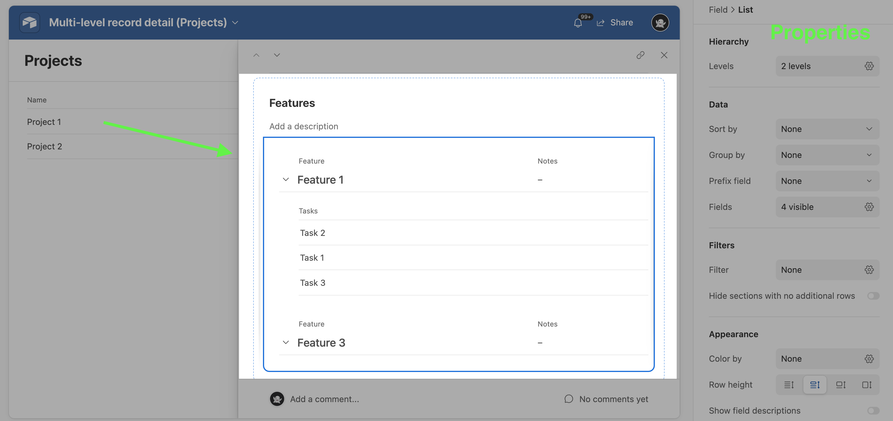

Using multiple level lists in record detail pages
When your interface contains a linked record field, you can leverage it on record detail pages to create a list visualization that highlights a hierarchy of record dependencies. This allows end users to drill down into details, expanding and collapsing . A common example of this is a Project → Tasks → Subtasks or a Marketing campaign → Key deliverables/Milestones → Assignments hierarchy. Learn more about list views here.
To create a list visualization on a record detail page:
  1. Navigate to an interface in **Edit** mode.
  2. You’ll need to have enabled the “Click into record details” option [as highlighted in the walkthrough above](/docs/airtable-interface-layout-record-detail#showing-record-details-in-interfaces).
  3. Next, open that record detail page to access its properties and configure its look.
  4. You may already show a linked record field such as a “Tasks” link using the Project → Tasks → Subtasks example or you may need to add the linked record field to the record detail page.
  5. Click the linked record field to access its properties.
  6. By default, under the “Appearance” section, the “Show as” setting will be **Field**. You’ll need to change this setting to **View** to continue.
  7. Once it is showing as a view, click onto the page canvas where the linked records are showing. This will reveal the properties for the list.
  8. Next, configure the “Hierarchy” by clicking the cogwheel next to the “Levels” setting.
  9. This will open a popup walkthrough to set up the hierarchy for your use case. Click **Done** once you have configured the hierarchy. Note that you can set a maximum of 3 levels.
  10. At this point you can further configure the list visualization to fit your needs before publishing the interface.

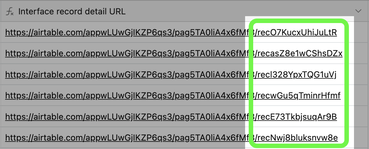

Using a formula field to link to individual record detail pages
The steps that follow will not link to individual record detail pages in interfaces created using the blank layout.
To create a dynamic link to a specific interface record detail page:
  1. From a browser, navigate to an interface containing a record detail page and expand any record to show the record's details.
    1. If you are not already in edit mode, click the **⌄** icon next to the name of the interface and click **Edit pages**.
  2. On the canvas, click the blue and white + button in the field header row and add a new formula field.
  3. Create a dynamic, record-specific formula like so:
    1. Copy the following formula: CONCATENATE("https://airtable.com/appxxxxxxxxxxxxx/pagxxxxxxxxxxxxx/", RECORD_ID())
    2. Copy the portion of the URL from the browser bar until you find the "?" character. For example, only copy "https://airtable.com/appxxxxxxxxxxxxx/pagxxxxxxxxxxxxx" from the longer URL that you will find.
    3. Replace the https://airtable.com/appxxxxxxxxxxxxx/pagxxxxxxxxxxxxx/ portion by pasting the URL that you copied in step 2.
  4. Name and save the new formula field. You'll see a clickable link appear for each record that will open a new tab in your browser to that specific record’s record detail page. You can share this link with other users who have access to the same interface.
Edits you make on a record detail page that you opened from a formula URL aren't tracked by the interface's publish state. Publish and Clear unpublished changes stay grayed out, and end users keep seeing the field values from the last publish. To publish changes to a record detail page, open it from the interface page it belongs to in edit mode, make your edits there, and then click Publish.

  1. Navigate to the layout of your choice.
  2. Find the section marked “Click into record details” below the “User actions” section.
  3. Toggle the record detail page off.
To delete a record detail page:
  3. Click the cog wheel icon, then click the drop-down menu.
  4. Finally, click the three dot **…** icon and click the **Delete** option.
