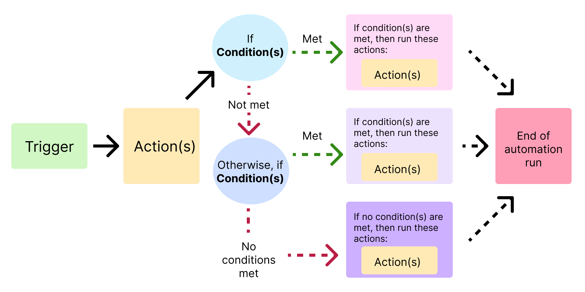

  • Concept 1: Understanding how the automation will run when conditions are met
    • On an automation run, your automation will go down the line checking each conditional group—if the conditions for a group are met, the automation will run all of the actions in that group. Only one group of conditions can be met during a single run. Looking at the chart below, if the first set of "if condition(s)" are met, then the actions associated with that will run even if other conditions match in the group of condition(s) below it.

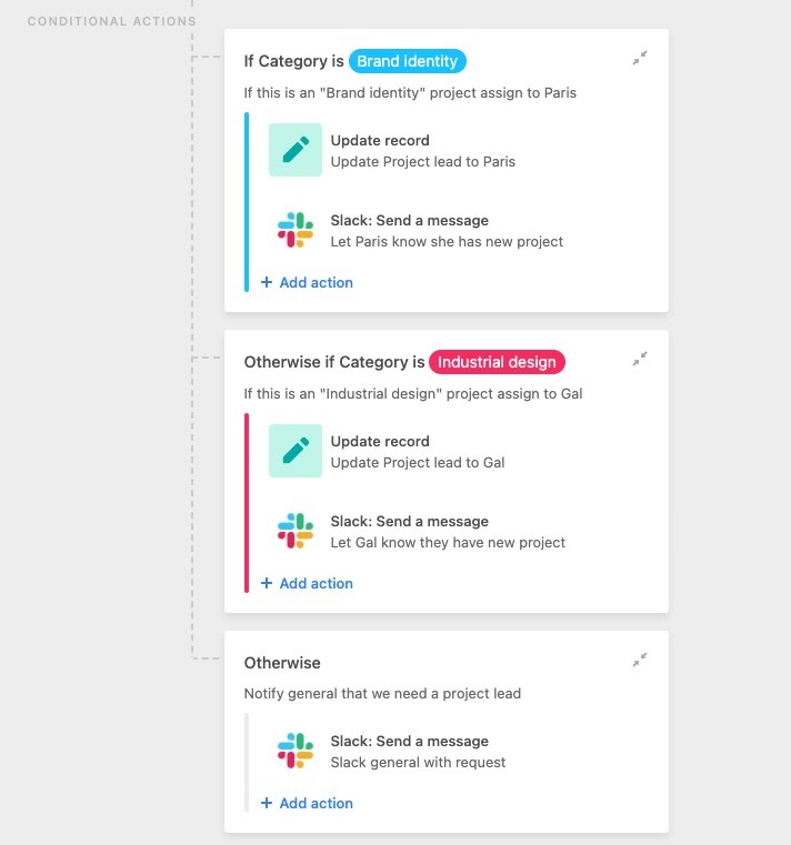

  • Concept 4: Complex example
    • For a more work-relevant example workflow: Suppose we needed to create an automation to handle assigning projects to the correct person based on the Category of the project. We have two teams:
      1. Paris leads the team handling “Brand identity” categorized projects
      2. Gal leads the team handling “Industrial design” categorized projects.
      Next, we build an automation workflow that assigns all “Brand identity” projects to Paris and all “Industrial design” projects to Gal. If any project doesn’t meet either of those categories, we send a Slack message to the team—letting them know we need a team lead for that project.

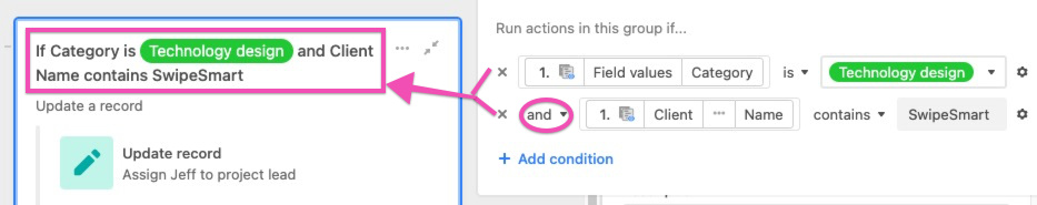

    • Let’s add one more layer of complexity to our example. Suppose Jeff has a great relationship with the technology team for one of our clients, SwipeSmart. So Jeff will handle all of the “Technology design” categorized projects only if the client is “SwipeSmart.” We can create and combine two conditions to cover this scenario:
      1. If “[Category] [is] [Technology design]”, and
      2. if the “[Client Name] [contains] [SwipeSmart]”.
      Now, if a project is submitted from the technology team at SwipeSmart, Jeff will be assigned as the project lead:

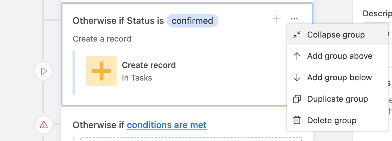

  6. (Optional) Collapsing, adding more, duplicating, or deleting conditional groups - Clicking on the three-dot menu within a conditional group will show a menu to:
    • Collapse group - This only appears once you’ve added actions to the group. This option is just to help with visibility when editing a complex automation.
    • Add group above or Add group below - Add a new conditional group of actions above or below the current group
    • Duplicate a group - This option will duplicate a group below the group you are duplicating.
    • Delete a group - This option is unavailable in some situations and an explanation will appear when hovering over the greyed-out option.

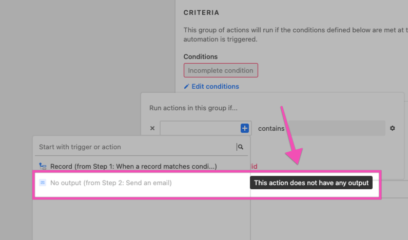

    • The first value in any condition you set on a conditional group will always be a field or result from a previous trigger or action in this automation:
    • Some actions don’t return any data, so you won’t be able to incorporate those actions into your conditions:

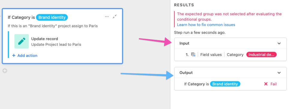

When you have a conditional group selected, you’ll see a button marked “Test condition.” Clicking that button will test the conditions of that group.
There are unique aspects to consider when testing conditional action groups in automations. When you test a conditional group, you check that your group will run when the given input testing information matches the conditions for that group. As a reminder, the testing information in an automation comes from a previous trigger or action step.
So effectively, when you test a conditional group, you are double-checking that your conditional group will run with the given input if:
  1. The condition(s) of that group are met, and
  2. The given input doesn't match a prior condition group first.
In a successful test, the input record had a category of “Brand Identity,” so the group tested successfully because the actions inside that group would have run.
So, to reiterate, a condition group is testing to see if the group would have run given the input testing information. So, even if your condition is valid— the test may fail if the information that is passed in doesn’t meet the conditions for that group. In the above below, the input record did not have a category of “Brand Identity,” so this group wouldn’t have been triggered— which is why our test failed.
