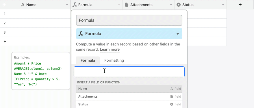

Adding formula fields in Airtable
  2. Open the base where you want to add a formula field.
  3. Add or edit a field.
  4. Search for and select “Formula.”
  5. Enter your formula in the space under “Formula.”

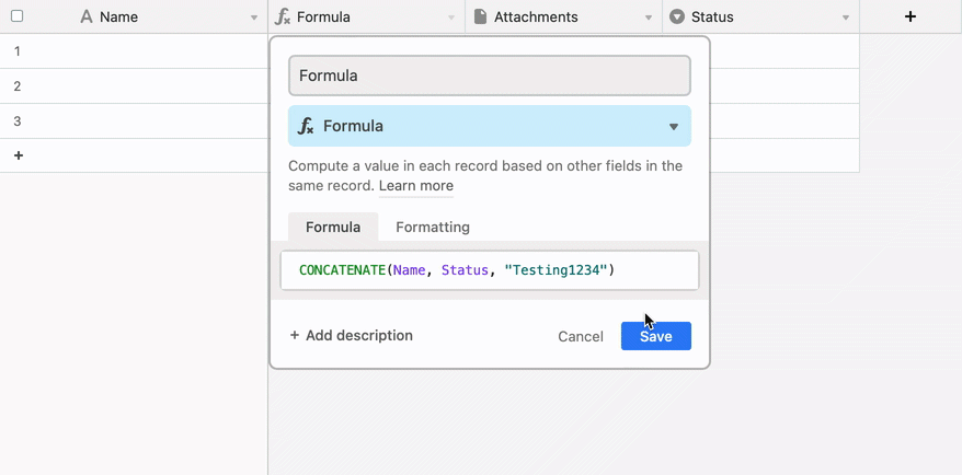

  6. Click the Formatting tab to adjust the way the formula’s output is formatted.
    • When the Formatting tab is available, you can format the formula's result as a decimal, an integer, a currency, a percent, or a time duration. Additionally, you can adjust the precision for decimals, currencies, and percentages.
    • This option only appears when your formula produces a numerical output (for example, a formula using arithmetic operators or a numeric function). If your formula outputs text, a date, or another non-numeric type, the Formatting tab won't offer number-based formatting options like currency.
    • If you don't see a currency (or other numeric) formatting option, check that your formula is actually returning a number. For example, a formula that returns text representing a number (like a concatenated string) won't offer numeric formatting. You may need to wrap your formula in a numeric function, such as VALUE(), to get a true numeric output.
    • Refer to this article for more information about formatting.
  7. Click Create field.

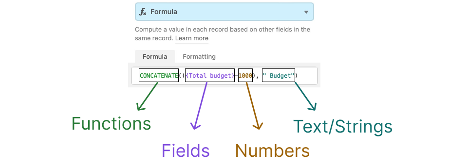

Colorful Syntax highlighting
Green = Functions
Purple = Fields
Orange/Brown = Numbers
Teal = Text/strings
Black = Anything else not represented above. ex. commas, parentheses, etc.

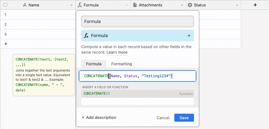

Parenthesis matching
formula_field_parenthesis_matching

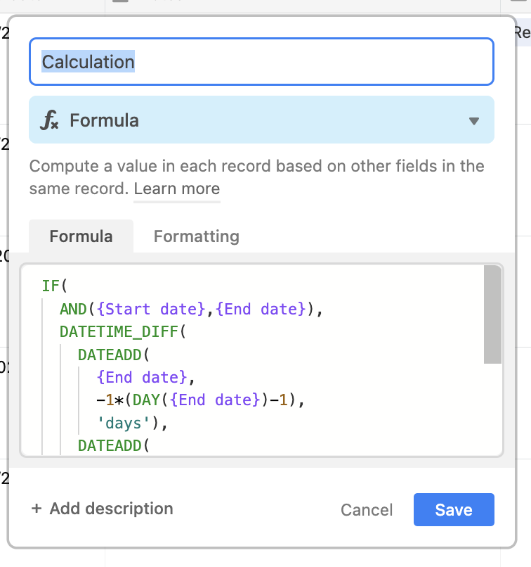

Multiline editing with the ability to fold multiline formulas
formula_field_multiline
