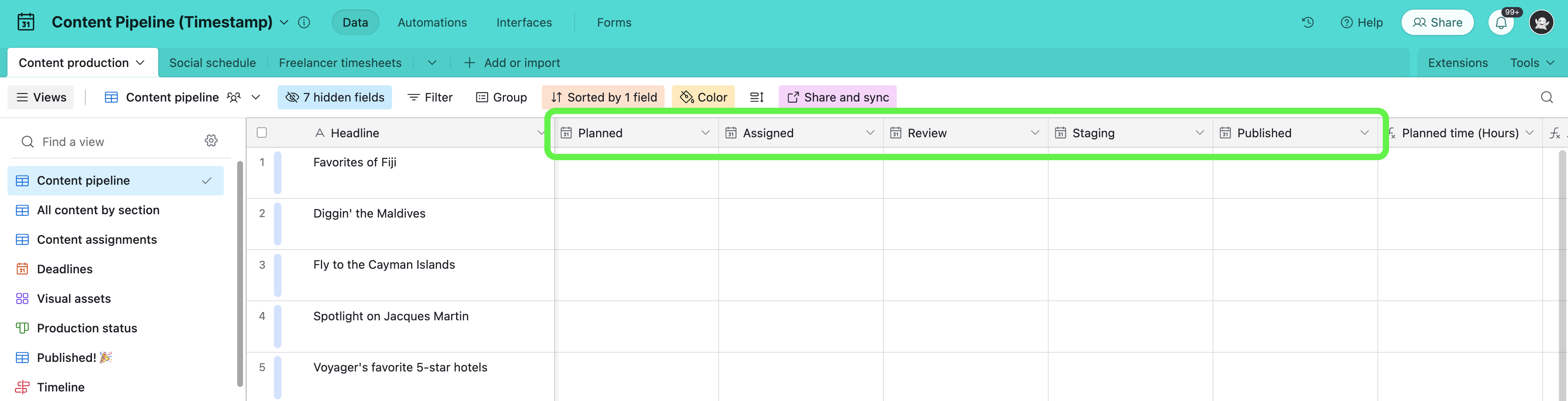

Step 2: Create date fields to timestamp each status change
To timestamp when a record changes to each unique status we need to create five date fields; one each for {Planned}, {Assigned}, {Review}, {Staging}, and {Published}. These fields will be populated later by the automation.

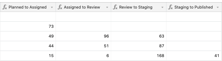

Use formula fields to calculate each status duration
The final step is to calculate the duration that a record spent in a particular stage. In the example below, we'll calculate how long an article spent in the "Planned" stage before moving to "Assigned." You can then modify the formula values to calculate the time spent in each status.
Remember, you'll also need to adjust the values below to fit the names of the fields in your particular base if they don't perfectly align with the example used in this article.

Step 2: Duplicate and modify formula fields
To get the difference in time for the other stages, duplicate the formula field and adjust the values for each of the different statuses. For example, the next time difference to calculate is the time between "Assigned" and "Review", so the adjusted formula will look like this:
    AND(
    DATETIME_DIFF(
        {Review},
        {Assigned},
        'hours'
Now you should have four separate formula fields that each output the number of hours a record spent in each stage of the content process.
