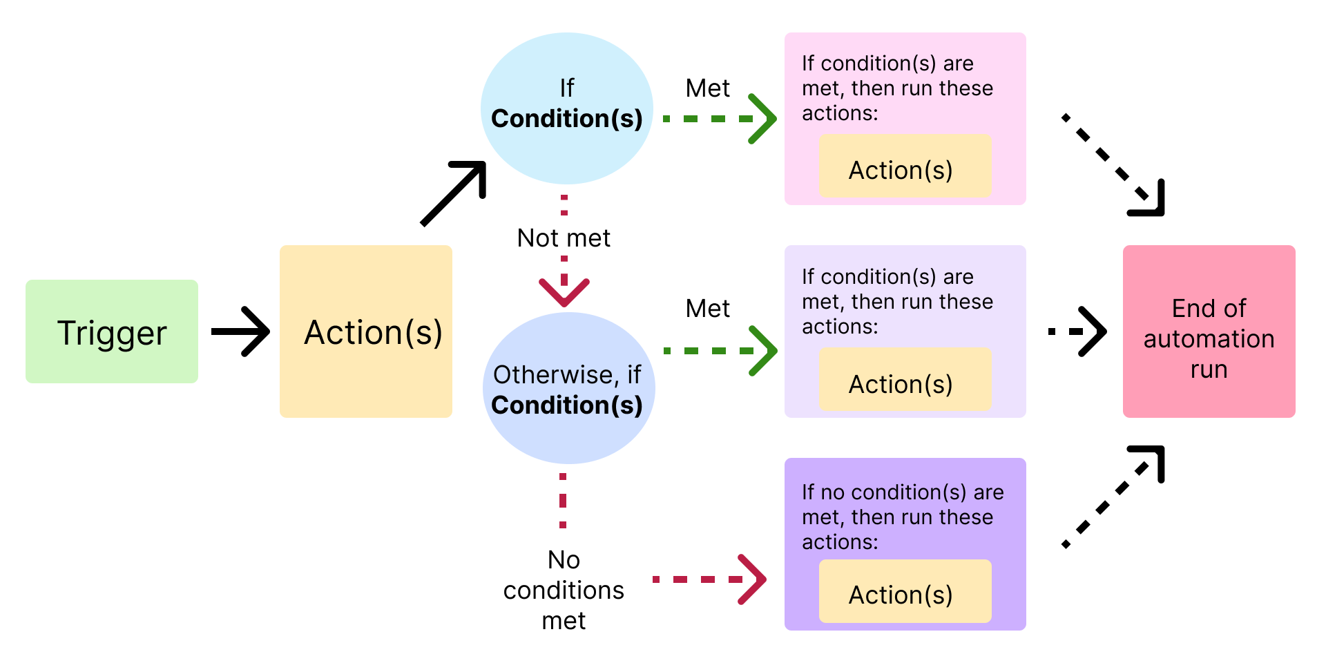

  • Concept 1: Understanding how the automation will run when conditions are met
    • On an automation run, your automation will go down the line checking each conditional group—if the conditions for a group are met, the automation will run all of the actions in that group. Only one group of conditions can be met during a single run. Looking at the chart below, if the first set of "if condition(s)" are met, then the actions associated with that will run even if other conditions match in the group of condition(s) below it.

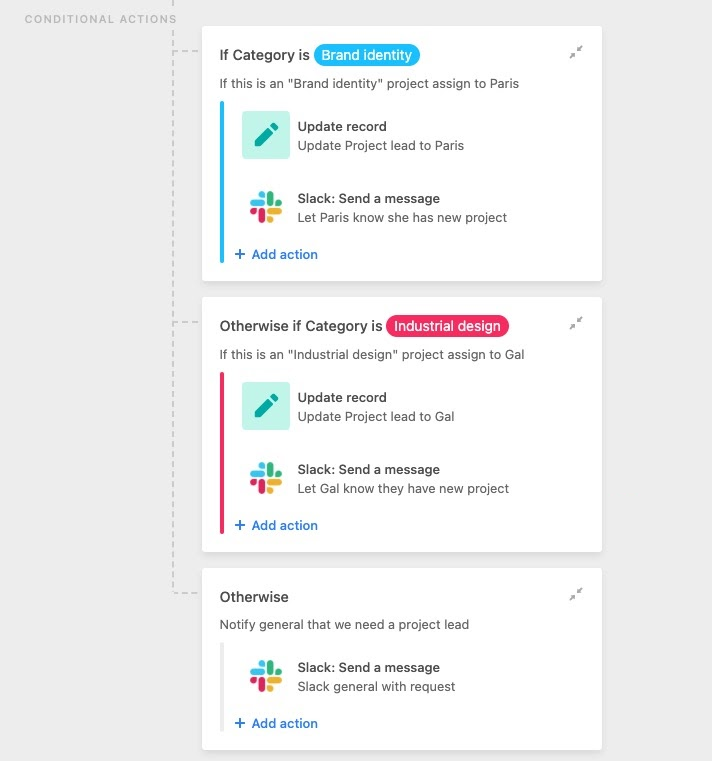

    • For a more work-relevant example workflow: Suppose we needed to create an automation to handle assigning projects to the correct person based on the Category of the project. We have two teams:
      1. Paris leads the team handling “Brand identity” categorized projects
      2. Gal leads the team handling “Industrial design” categorized projects.
      Next, we build an automation workflow that assigns all “Brand identity” projects to Paris and all “Industrial design” projects to Gal. If any project doesn’t meet either of those categories, we send a Slack message to the team—letting them know we need a team lead for that project.

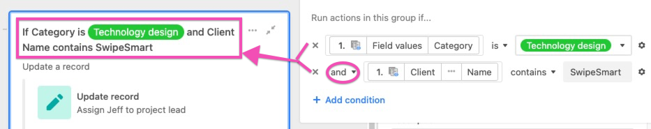

    • Let’s add one more layer of complexity to our example. Suppose Jeff has a great relationship with the technology team for one of our clients, SwipeSmart. So Jeff will handle all of the “Technology design” categorized projects only if the client is “SwipeSmart.” We can create and combine two conditions to cover this scenario:
      1. If “[Category] [is] [Technology design]”, and
      2. if the “[Client Name] [contains] [SwipeSmart]”.
      Now, if a project is submitted from the technology team at SwipeSmart, Jeff will be assigned as the project lead:

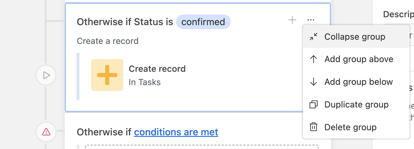

  6. (Optional) Collapsing, adding more, duplicating, or deleting conditional groups - Clicking on the three-dot menu within a conditional group will show a menu to:
    • Collapse group - This only appears once you’ve added actions to the group. This option is just to help with visibility when editing a complex automation.
    • Add group above or Add group below - Add a new conditional group of actions above or below the current group
    • Duplicate a group - This option will duplicate a group below the group you are duplicating.
    • Delete a group - This option is unavailable in some situations and an explanation will appear when hovering over the greyed-out option.
  7. (Optional) Add an “Otherwise” group of conditional actions - After you’ve created at least one conditional group of actions, you will have the option to add another conditional group (A.K.A an “Otherwise” group). You can add an “Otherwise” group by configuring the criteria to only run the actions in your conditional group:
    1. If the conditions are met - You can think of this type of “Otherwise” group as additive. It’s a way to create even more delineation and complexity to the way that the automation will run.
    2. or If no other conditions are met - This “Otherwise” group is essentially a catch-all for what to do if none of the previous conditions in your conditional action groups were met. Because this type of “Otherwise” group will only run if no previous conditions are met, you cannot add new groups below the “Otherwise” group.

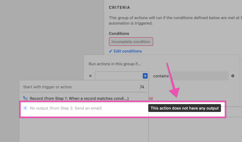

    • The first value in any condition you set on a conditional group will always be a field or result from a previous trigger or action in this automation:
    • Some actions don’t return any data, so you won’t be able to incorporate those actions into your conditions:

Can multiple automation groups be triggered based on conditions?
No. Only one conditional group's conditions can be met during a run, the first set of actions whose conditions are met.
