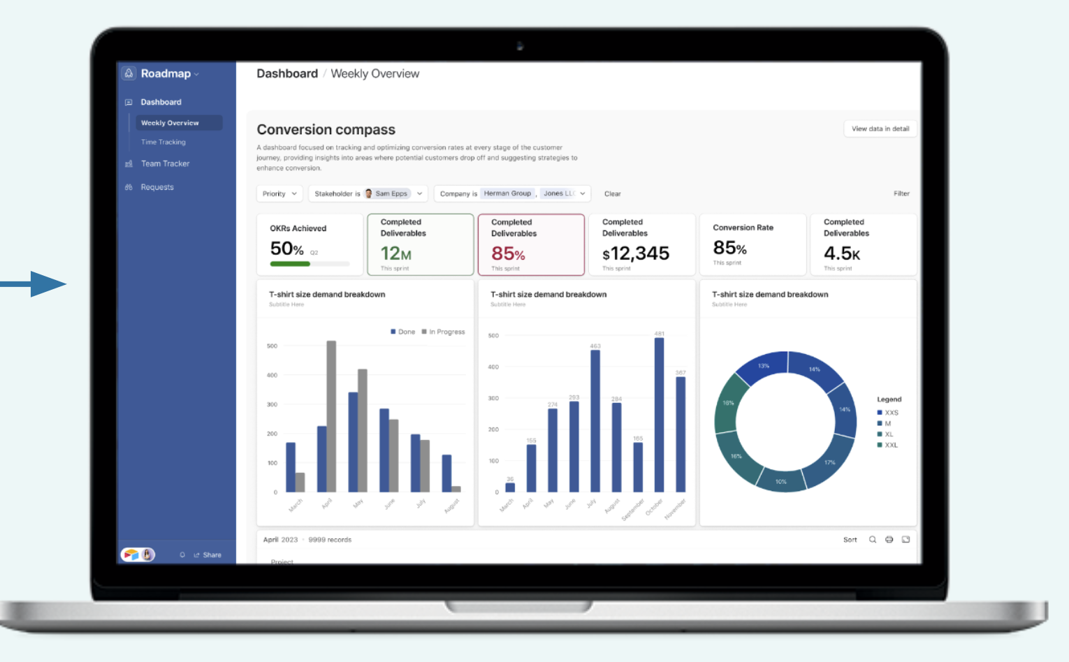

Interface dashboards in Airtable overview
Airtable interface dashboards allow users to communicate summaries of important information to stakeholders across their organization. Another powerful aspect of interface dashboards is the ability to drill down into various charts or tables and get past the high-level information presented at first glance. This is particularly important for the following stakeholder groups:
  • Leadership: reporting on the progress or status of a workstream via a dashboard gives the leadership a bird’s-eye view of the workstream without having them be bogged down by unnecessary details.
  • Partner groups or teams: Giving updates to partners via dashboards helps them capture the information at the right altitude without having to know all the details.
There are two high-level use cases for dashboards:
  • Reporting: Tracking progress at regular intervals and providing clarity, often answering to stakeholders and executives.
    • Example: initiatives dashboard showing progress against quarterly goals and projects that are behind schedule
  • Monitoring: Understanding the current state of an initiative or part of a business, with a particular focus on anything unexpected.
    • Example: capacity planning dashboard that shows the utilization of team members’ time over the next two weeks

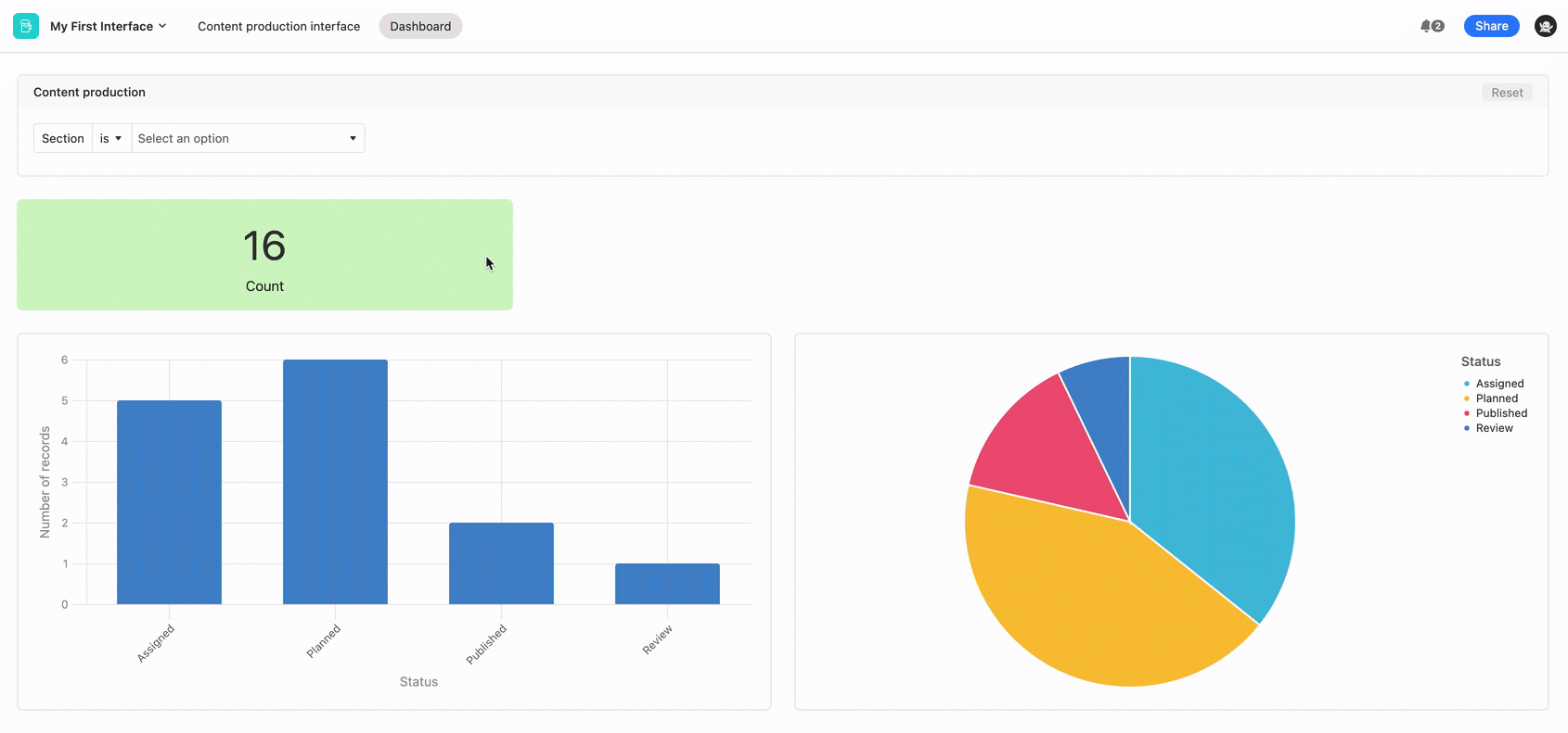

  1. First, give your dashboard a name and a description.
  2. When hovering over the dashboard you’ll see + buttons appear in different locations on the canvas. There will be different options based on where the + button is on the canvas, but within a dashboard group you can expect these general options:
    1. Number - Show a count or summary of records depending on filters.
    2. Chart - Show a chart to give insights into the underlying records in a connected table.
    3. List - Show a list of records from the underlying table. This is especially useful when grouping records (ex. status field).
    4. Timeline - Show a timeline of events based on a start date field and optional end date field.
    5. Summary Cards - Showcase images and highlights from individual records. They are perfect for executive overviews or status and project updates.
  3. We’ll cover more about each option’s settings below, but you can set a title, filters, appearance, and other settings from the properties panel on the right side of the page when you’ve clicked on a particular insight shown on the dashboard.
  4. You can also add groups to the page. These groups can source their data from different tables from the underlying base.

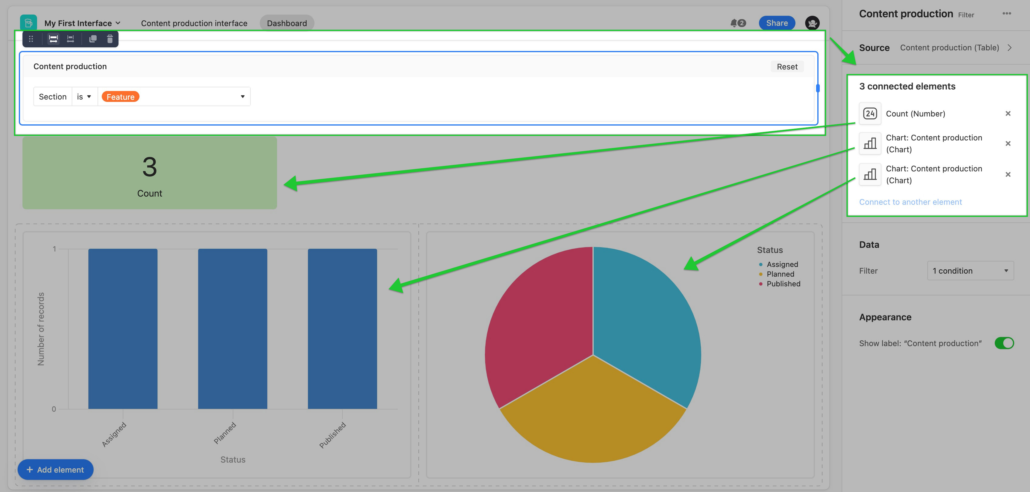

  • User filters - The elements section allows builders to give end-users different views/insights of the information in the dashboard group through tabs or dropdowns. More information about tabs and dropdowns is available in the “Step 3: Configure filters” portion of this article.
  • User actions - Builders can also allow end users to set their own filtering conditions by toggling the “Filter” option or configure one or more buttons that end users can click to perform some kind of action (only the “Go to interface page” or “Go to external URL” options are supported in dashboard groups).

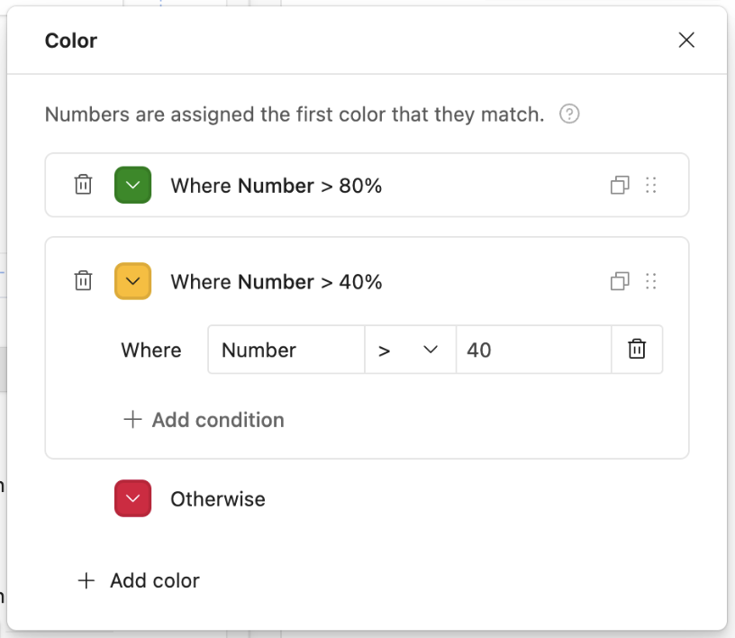

    • Color - You can also configure the color of the number and whether or not it has a background color enabled. Additionally, you are also able to set colors based on conditions. The “Otherwise” color setting essentially becomes a fallback color. Learn more about configuring conditional colors here.

Numbers in interface dashboard layouts have the ability to apply colors based on configured conditions. To set up conditional coloring:
  1. Select the number element
  2. Next, click the drop-down next to the “Color” option.
  3. Select the “Conditions” menu item.
  4. You can add multiple conditions and multiple colors. In the example below, you can see that the number can be colored based on the percentage summary for a particular column.
To delete color conditions, click the trash can icon next to the color you would like to remove.

  1. Filter element - The filter element is the star of the dashboard layout. Filter elements provide your interface users with dynamic filters that they can use to filter other dashboard elements. You can connect some or all of your dashboard elements to filter elements. Because filter elements are dynamic filters and not static filters, the choices each person makes in a filter element will not affect other people using the interface at the same time or in the future. This is why they're so useful when you're building a dynamic dashboard for people to use to analyze your data.  We cover the Filter element in depth in this article.
  2. Number element - Number elements are covered more extensively here, but in general, they can display a count of records or a summary of a connected field's records such as the number of records where this field is empty, the percent filled, or the percent empty.
  3. Chart elements - The dashboard shown above includes both bar and pie charts. There are even more chart types to choose from as described here. The nice thing about charts connected to a filter element is that they will dynamically adjust to display information according to the filter(s) a user has chosen. Learn more about the chart element here.
