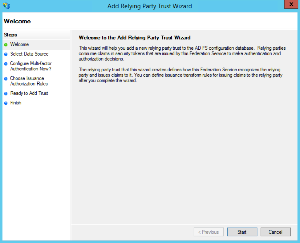

  1. In the left navigation pane of ADFS, select Relying Party Trust, then Add Relying Party Trust, then Start.

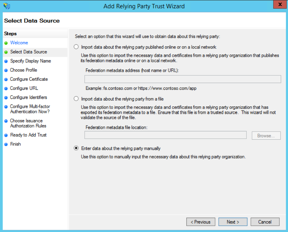

  2. Click the radio button option to Enter data about the relying party manually, then click the Next button.

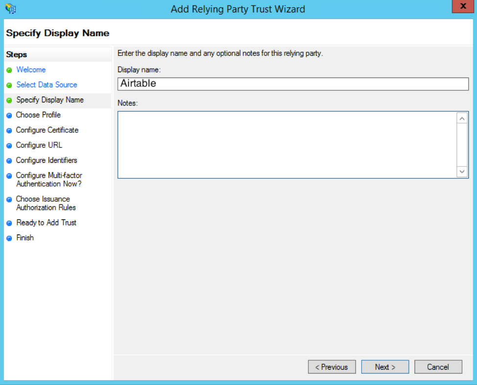

  3. You can enter whatever display name you want (like "Airtable") and any optional notes—then click the Next button again.

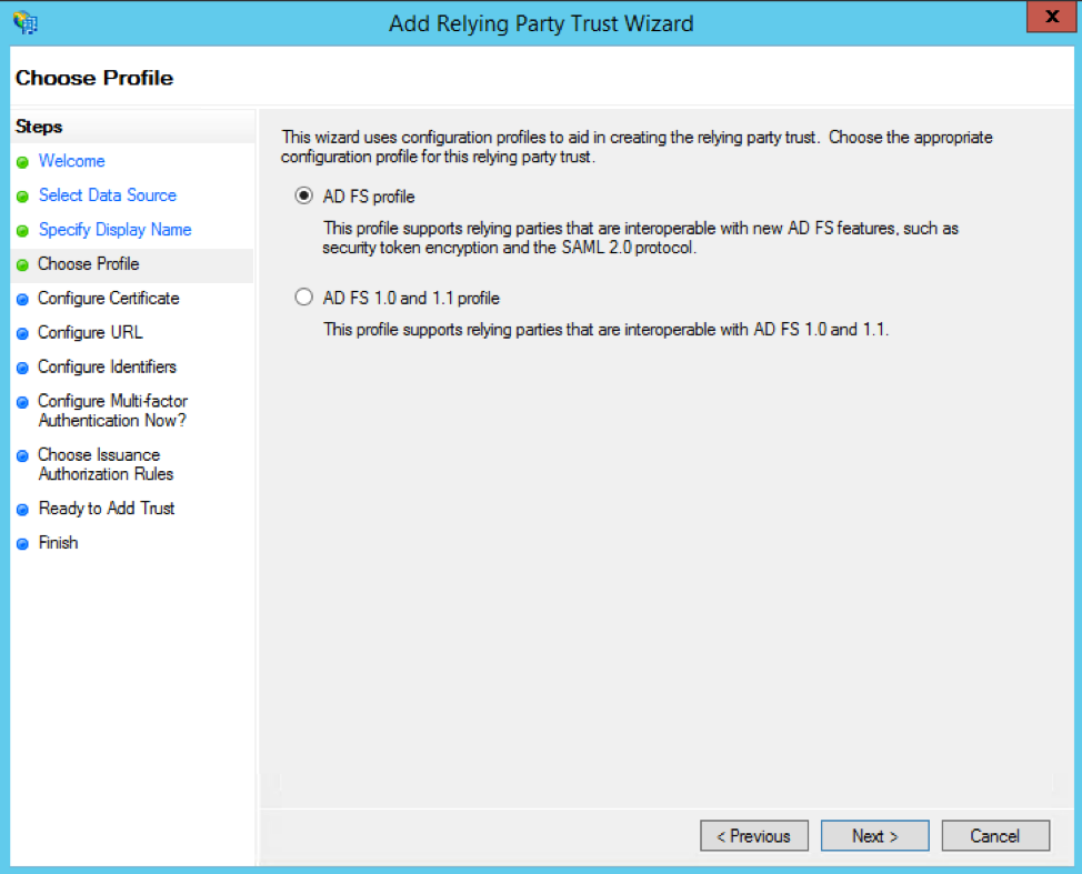

  4. Next, pick ADFS profile as the configuration profile.

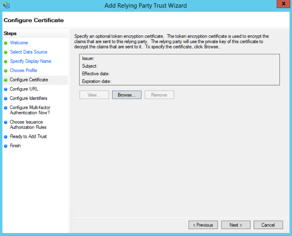

  5. Click the Next button on the Configure Certificate page.

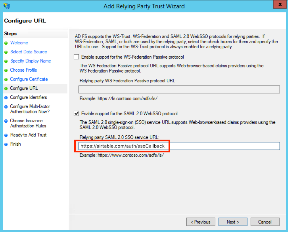

  6. For the Configure URL page, check the Enable support for the SAML 2.0 WebSSO protocol box and paste in the ACS URL shown in your Airtable SSO configuration dialog (for legacy configurations: https://airtable.com/auth/ssoCallback).

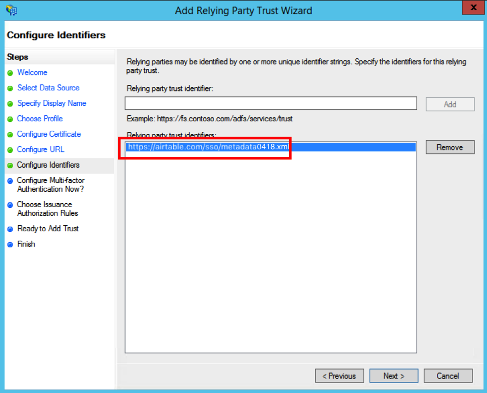

  7. For the Configure Identifiers page, add the Entity ID shown in your Airtable SSO configuration dialog as a “Relying party trust identifier.” For legacy configurations, use https://airtable.com/sso/metadata0418.xml.

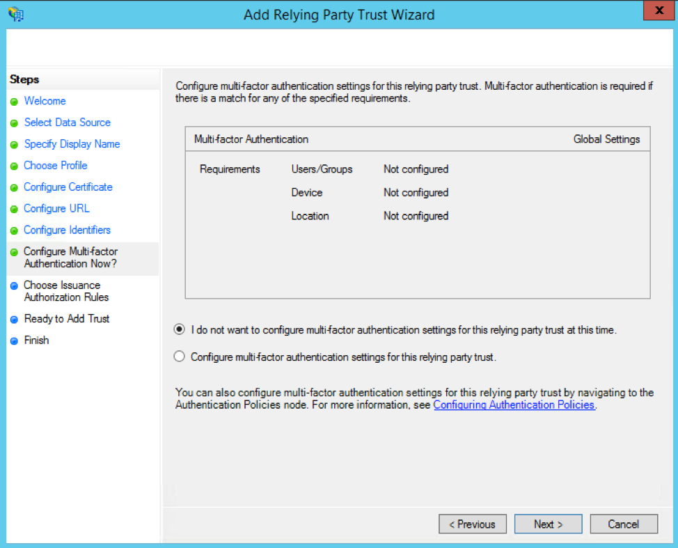

  8. On the Configure Multi-factor Authentication Now? page, choose the "I do not want to configure multi-factor authentication settings for this relying party at this time." option.

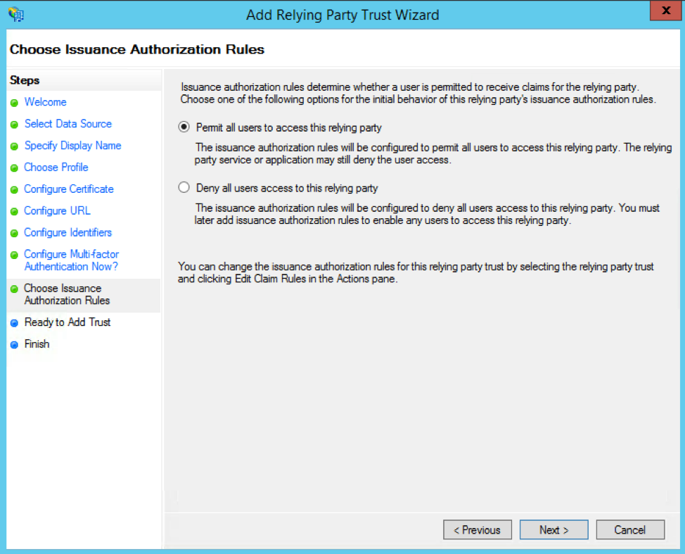

  9. On the Choose Issuance Authorization Rules page, select the "Permit all users to access this relying party" option.

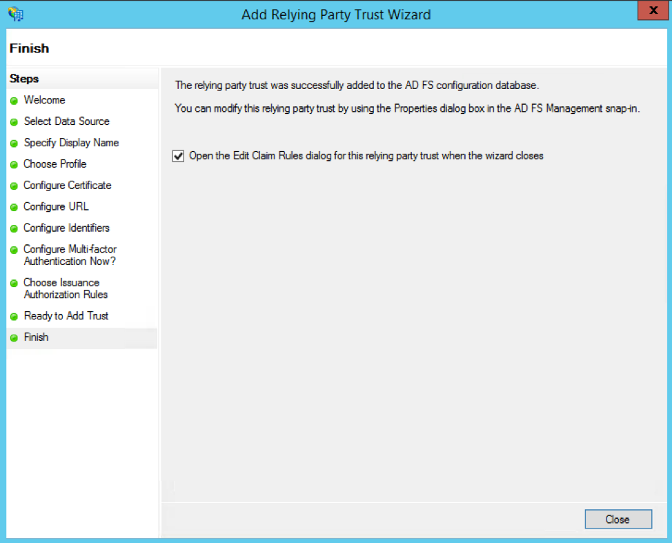

  10. On the final screen of the wizard, check the "Open the Edit Claim Rules dialog for this relying party trust when the wizard closes" box. This will open the Edit Claim Rules dialog once you click the Close button.

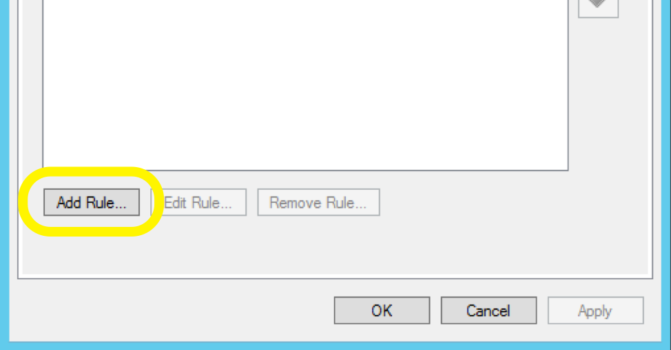

  1. Once in the Edit Claim Rules dialog, go to the Issuance Transform Rules tab, then click the Add Rule button. This will open up the Add Transform Claim Rule Wizard.

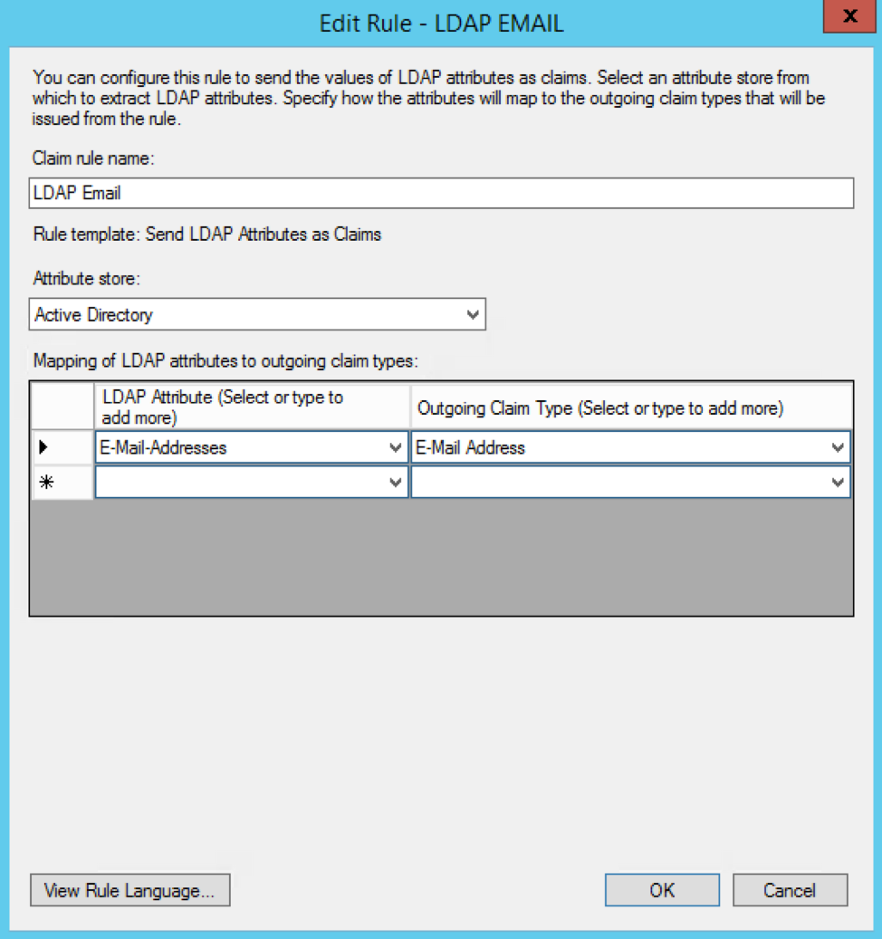

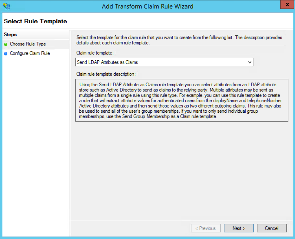

  2. From within the Add Transform Claim Rule Wizard, you will be asked to Choose Rule Type. From the Claim rule template dropdown, select the Send LDAP Attributes as Claims option.
  3. Give your claim rule a name (like "LDAP Email") and map the E-Mail-Addresses LDAP attribute in the left column to the E-Mail Address outgoing claim type in the right column.

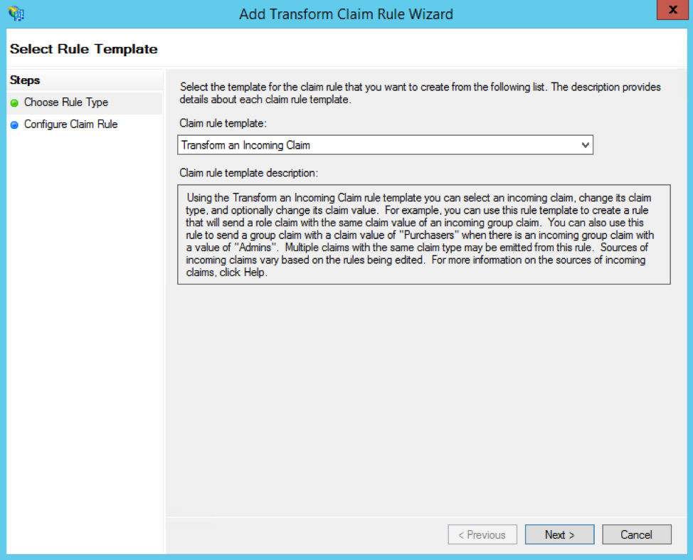

  4. You'll need to add another Transform Claim Rule here. This time, select the Transform an Incoming Claim option from the Claim rule template dropdown.
  5. Give this claim rule a name (like "Email Transform"), then set the following values:
    • Set Incoming claim type to E-Mail Address
    • Set Outgoing claim type to Name ID
    • Set Outgoing name ID format to Email
    • Select the Pass through all claim values radio button

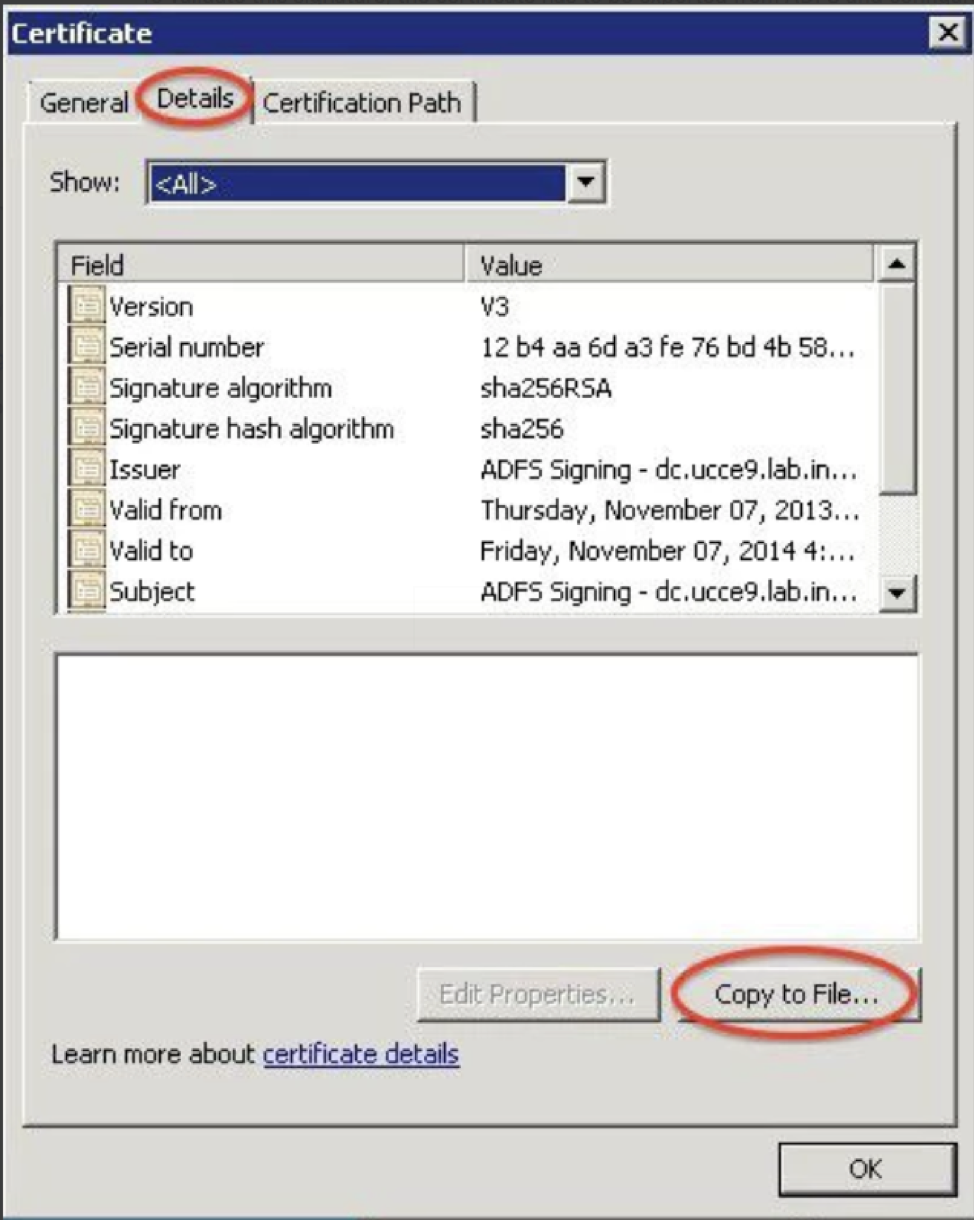

  2. Under the Signature tab, click Add, then upload airtable.crt. Click OK to complete. Next, you'll need to export your token signing certificate. In ADFS, click the Certificates folder, then Token Signing certificate.
  3. Click the Details tab, then click the Copy to File button.

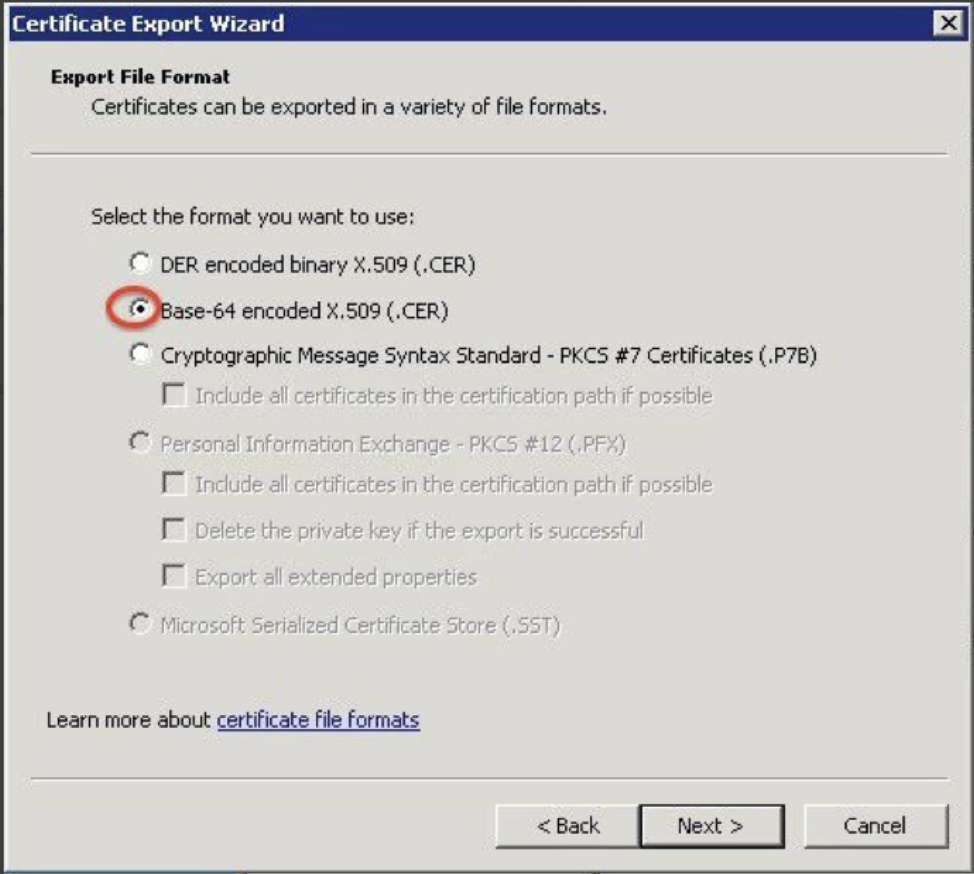

  4. Next, export as a Base-64 encoded X.509 (.CER) file.
  5. After that, submit your sign on URL and x.509 certificate (you can open the .cer file in a text editor and copy-paste it in) following the steps in this article.
