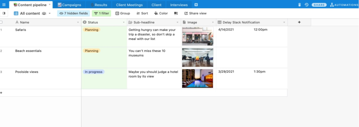

  1. Create a date field (with time toggled on) to use for delaying the automation

  1. Create a date field - Add a new date field and name it “Delay Slack Notification.” Notice that some of the records shown below have a date and time filled out, while some don't.

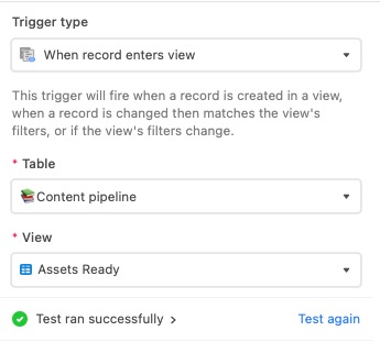

  4. Choose an automation trigger - The next step is to setup an automation using the “When record enters view” trigger. Select the appropriate table and the “Assets Ready” view we just created. We strongly recommend pairing the "When record enters view" trigger with a locked view. By using a locked view, or ensuring a locked field is involved, you can decrease the likeliness of accidentally changing a view's filtering (therefore avoiding accidental automation runs for unintended records that enter that view).

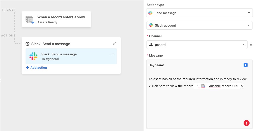

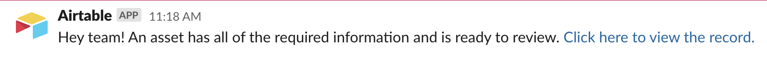

  5. Add an automation action - Next, add the Send a Slack message action and select the channel where you want to send the message. You can then format your message to include any information about the record. In the example below a link to open the record is included to make it easy to review the record.
    Once you've configured the message details make sure to run a test to check that everything is formatted correctly.
