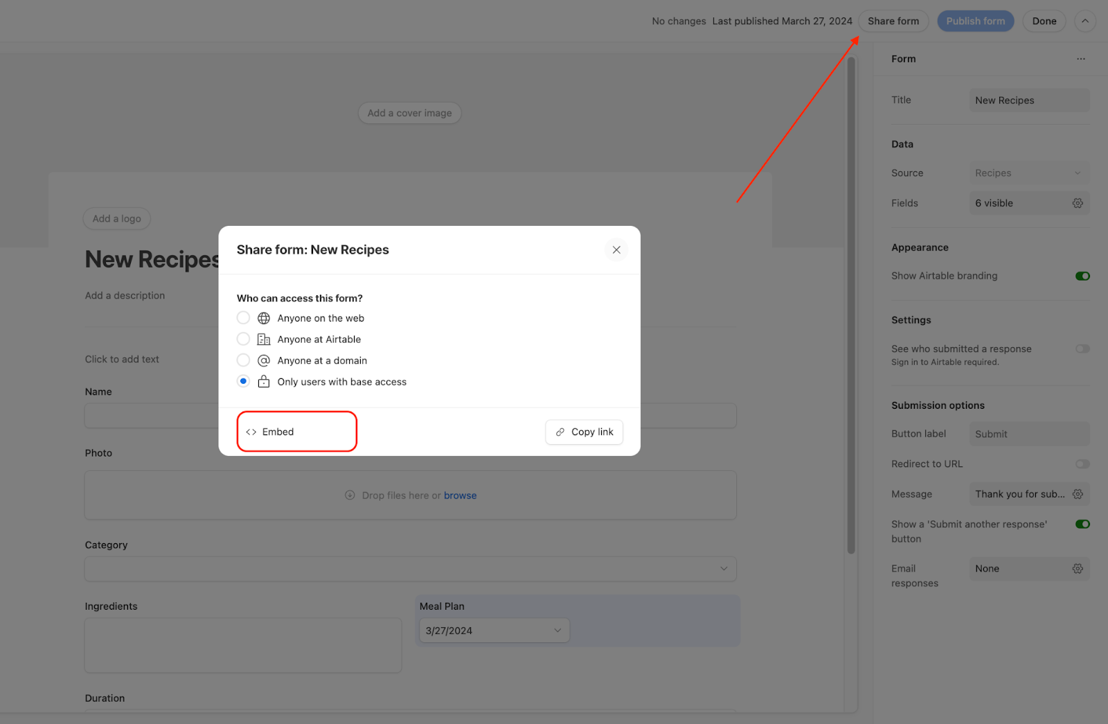

    1. After publishing, the live version of the form opens, where you can configure share settings, embed options, and copy the link if needed.

    • Toggle on the option to “See who submitted a response” to require that the form submitter logs into Airtable to track submissions in a created by field.
      • If a created by field doesn’t already exist in the source table, then a new user field will be created in the source table when this option is toggled on.
    • Toggle off the “Accepting submissions” option to close the form and prevent people from submitting a response.

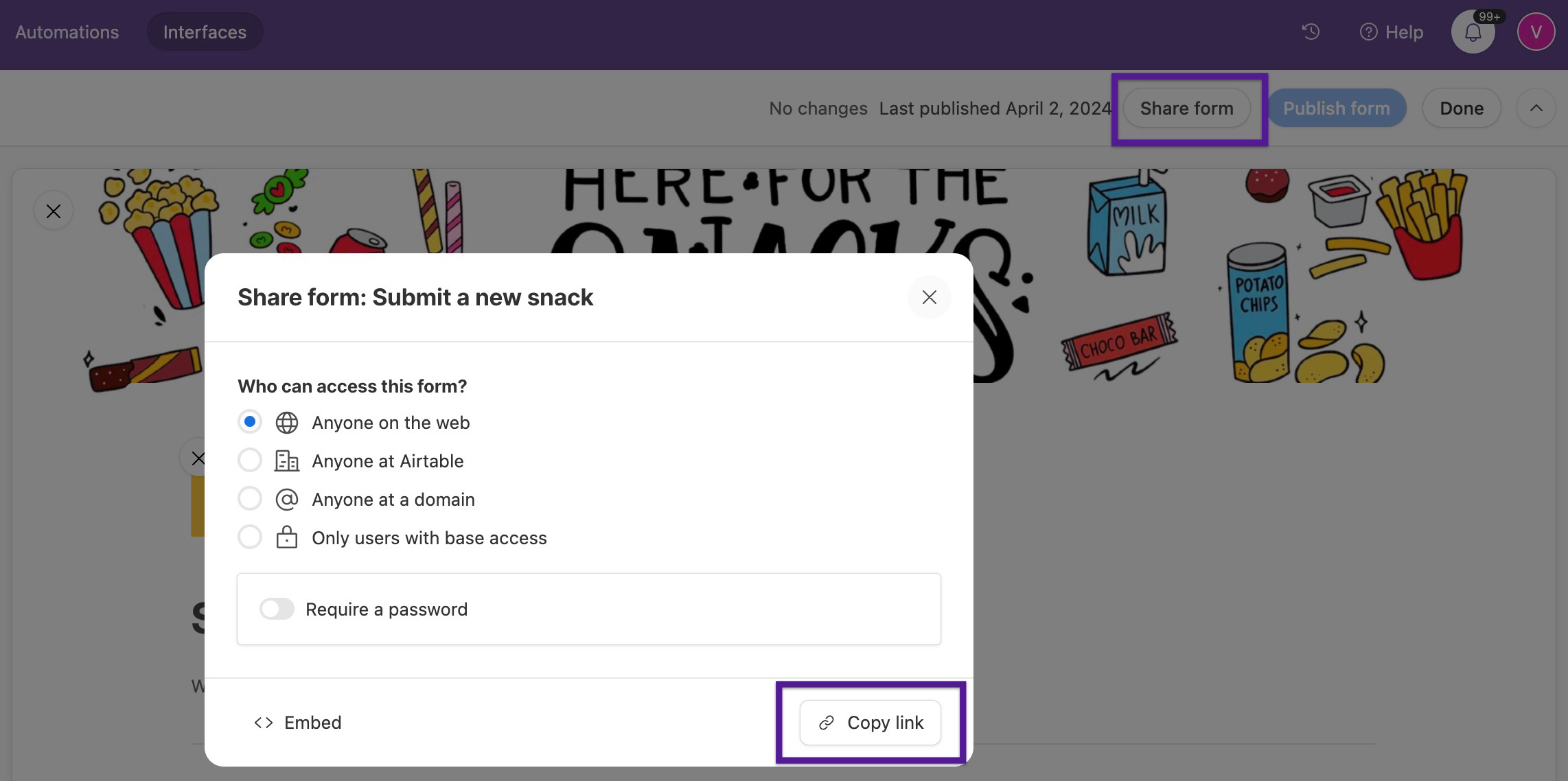

Configuring a form’s share settings
Share your form using the Share form button in the form builder, not the Share button in the upper-right corner of the base.
  • The base Share button shares the base itself — an invite link created there gives whoever opens it collaborator access to your base, including your data, interfaces, and automations.
  • The two buttons look similar, so confirm which link you copied before you send it out. Learn more in our Creating Airtable base share links article.
After publishing a form for the first time or after clicking on the Share form button from within the form builder you’ll have several share options to choose from:
  • Anyone on the web - Anyone on the web will be able to fill out the form, even people who have not had the link shared with them directly, so use this setting with caution.
    • If the option to “See who submitted a response” has been toggled on, then end users who access the form must log into Airtable in order to create a form submission.
  • Anyone at {Your organization} - Available on Business and Enterprise Scale plans only.
  • Anyone at a domain - Available on paid plans only. Specify a single domain that is allowed to access the form and submit responses. After clicking this option, type in a domain such as “airtable.com” and click the Set email domain button.
    • This will require end users to sign into Airtable before accessing the form
    • If the email domain of the signed-in user does not match, then the following message will appear: “The private share link you tried to reach is not available. The owner of this base may have unshared or deleted it. Please contact them if you need access.”
  • Only users with base access - When this option is chosen, the form will only be accessible to other base or workspace collaborators.
    Interface-only collaborators will not be able to access the form. If you are looking for interface-only collaborators to access a form, then we recommend using the Interface Designer form layout.
  • Require a password - This option only shows up for publicly available forms. For an extra layer of security, toggle this option on (or click Change password), enter a password, and click Save.

Embedding forms
Post-submission URL redirects aren't available when a form is embedded.
You can embed a standalone form in an external location to collect responses from your required audience.
  • The viewer of the form will only see field information displayed within the form and is not permitted to make any configuration, beyond filling in information as required.
  • All settings applied to the form’s properties will apply.
  • If you change cell values, add records or fields, or update which fields and records are visible in the form, the embed will automatically update in real-time to show the most updated version.
To embed a form layout:
  1. Open your preferred interface form and click Share form at the top right and select Embed.
  2. This will take you to the embed settings page which is covered in this article.

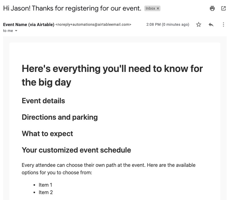

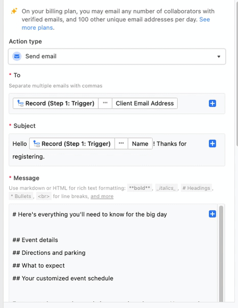

Is there a way to send custom email form confirmations?
Yes. You’ll use the Airtable Automations feature to accomplish this type of workflow.

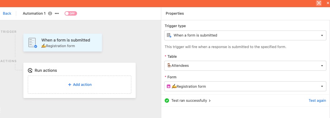

In this example, we'll use this event planning template as a real-life example to demonstrate this functionality.
  1. Add a form - To start, you'll need to create an Airtable form as outlined in the building and sharing forms article above.
  2. Add an automation - If you’ve never created an automation before, consult this article.
  3. Configure a trigger - The next step is to set up an automation trigger to look for new records added to the Attendees table.
    Using the " When form submitted trigger" automation will trigger (run) every time the form we select is submitted.
    In our example, this automation will trigger after someone fills out the event registration form.

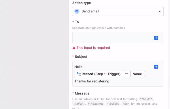

  4. Set up an automation action - To send the confirmation email we'll use the Send an email action which is covered in more detail in this article. To set up the "Send an email" action click the blue "+ Add Action" button. Then, click on the "Send an email" option. This will bring up a box with configuration options to add recipients, a subject line, and the message body. For the To field, we'll select the email field used to collect registrant email addresses.
    You can then configure the other available fields. By clicking on the "Show more options" drop-down arrow, you will have the ability to customize four additional parts of the automatic email you send out, which includes "CC", "BCC", "From name", and "Reply to". It's a good idea to BCC your own email address. You can remove your email address after the automation is confirmed to be sending the email correctly.
    Our native Send email action may not be the best choice in every situation. Consider also testing out functionality with our Gmail: Send Email and Outlook: Send Email actions.
  5. Test and review the confirmation email - After your message looks the way you want it to you must test to ensure the automation is working properly. If the test runs successfully, then at this point it's a good idea to check that the test email was also sent successfully and looks the way you want it to. If so, you can now turn on the automation. Every time someone registers for an event they'll receive the confirmation email you created!

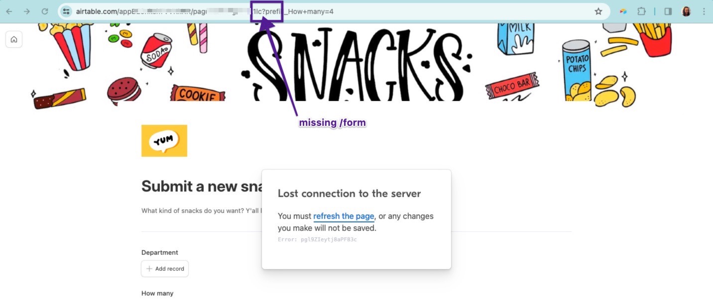

Interface-only users are encountering a “Lost connection to the server” error, how can I resolve this issue?
The “Lost connection to the server” error happens when interface-only users attempt to access the standalone form, but the URL they are using is missing '/form' at the end:
The URL should be formatted in the following manner: https://airtable.com/appXXXXX/pagXXXXX/form
Once you add /form to the end of the URL, your interface-only users should no longer experience this error. When sharing a link to the form or building prefilled form links in the future, the full share URL can be copied by going to Share form and clicking Copy Link:

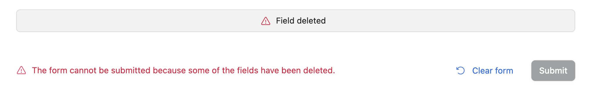

My form shows that a field has been deleted, how do I rectify the issue so that new submissions can be made?
When a form containing a field that has been deleted in the underlying base, a warning message will appear:
“The form cannot be submitted because some of the fields have been deleted".”
To rectify this situation, you can do one of two things:
  1. Remove the field from the form and republish the form.
  2. Restore the field that was deleted from the base trash. Once restored, as long as no other changes to the form are needed, there’s no need to republish the form.

I sent someone my form link and it opened the base instead. What happened?
You shared a base invite link rather than the form link. Open the form in the form builder, click Share form, and copy the link from there. To confirm what a recipient will see, paste the link into a private browsing window before you send it.
If someone has already opened a base invite link, you can remove their access from the base's share settings, and disable or delete the invite link itself so it can't be reused. Learn more in our Creating Airtable base share links article.
Why did submitters stop receiving confirmation emails after I upgraded a form?
An automation that uses the "When a form is submitted" trigger fires for one specific form. If the trigger still points at your original form view, it won't run for submissions that arrive through the upgraded form, and the reverse is also true. You can either re-point the trigger at the form you want people to use, or change the trigger to "When a record is created" so that it runs no matter which form the submission came through. See "Upgrading existing form views" above for how to update the trigger.

Can I email form submitters a copy of their response?
No, not with a form setting. Airtable never sends the submitter a copy of what they filled out, so a submitter who reports receiving nothing is seeing expected behavior rather than a misconfiguration. The Email responses option under Submission options notifies the base collaborators you select each time the form is submitted — it does not email the submitter.
To send submitters a copy:
  1. Add a field to the form that collects the submitter's email address.
  2. Create an automation with the Airtable automation trigger: When a form is submitted.
  3. Add the Airtable automation action: Send email, and set the To field to the email field from the submitted record.
  4. Include the submitted values in the message body so the submitter has a record of their answers.
Under Show more options in the Send email action, you can also set CC, BCC, From name, and Reply to.
